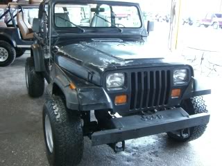

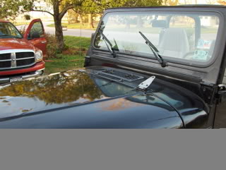

First I sanded down the hood double primered and rattle canned Rustoleum on it
Before w/clear coat flaking off badly:
After:
It looked so good I decided I'd just spray paint the whole thing. If you prep the heck out of it and wetsand the final coat with some 1500 grit sandpaper and then buff it out with a cleaner wax it looks pretty danged good

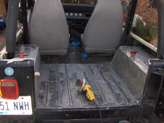

Stripping and sanding/grinding floorboards:
Tomorrow the Herculiner roll in bedliner in the whole interior. I began With a wire wheel on my grinder and it was going pretty good but my neighbor brought over some striiper and it worked great. I just brushed it on it came right off to the bare metal and now I'll hit it with the grinder a little more to rough it up so the Herculiner sticks.

I think it's paint quality and crappy clear coat. Here's a couple more pics from todays 12 hours
After I stripped all the paint off I hit it with a grinder to provide the rough surface for the Herculiner

I re-read my previous posts and it gives the impression I spray painted it but I changed my mind and went with some custom mixed single stage enamel and shot it with a $30 Cambell Hausfeld spary gun.
