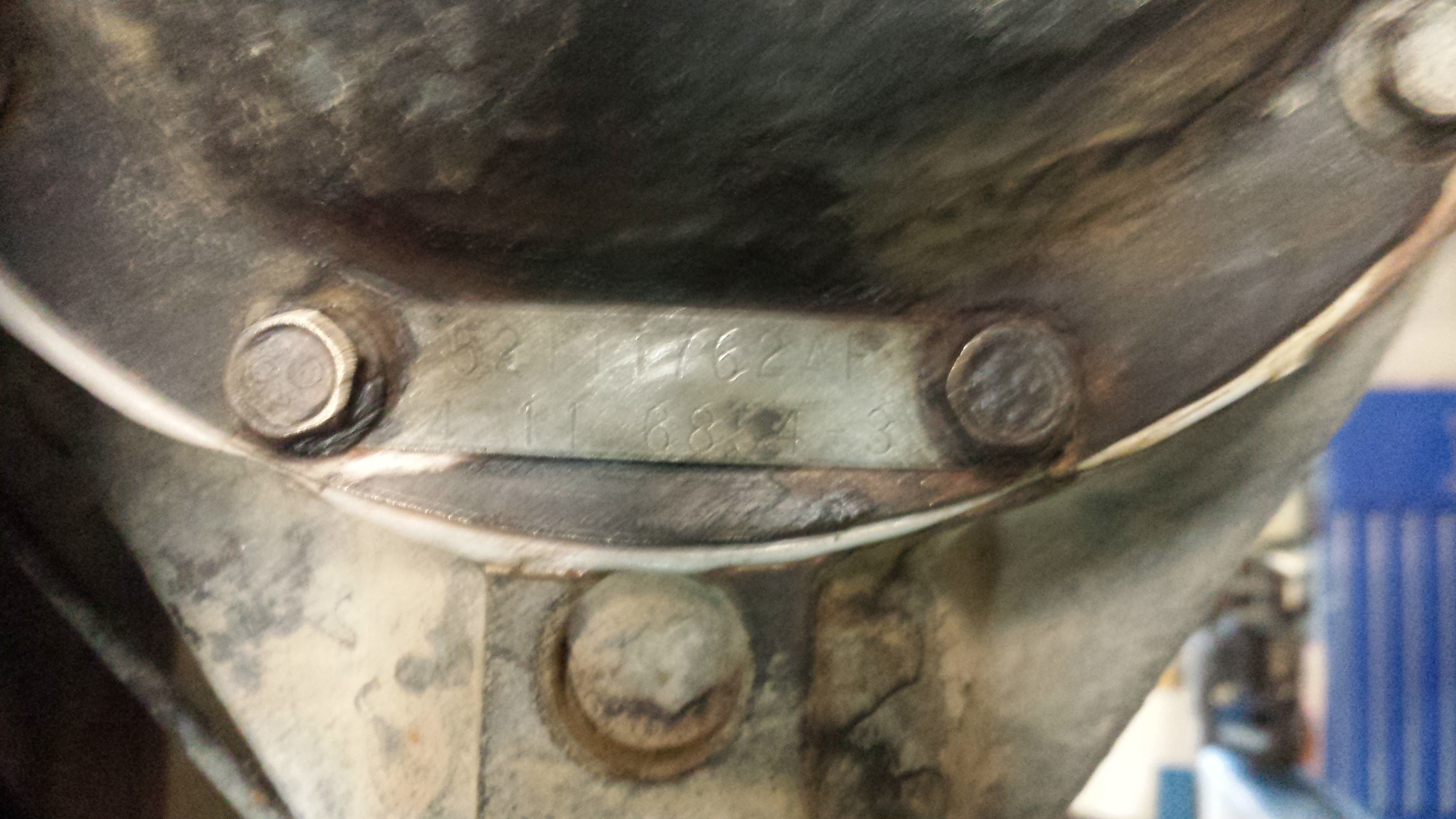

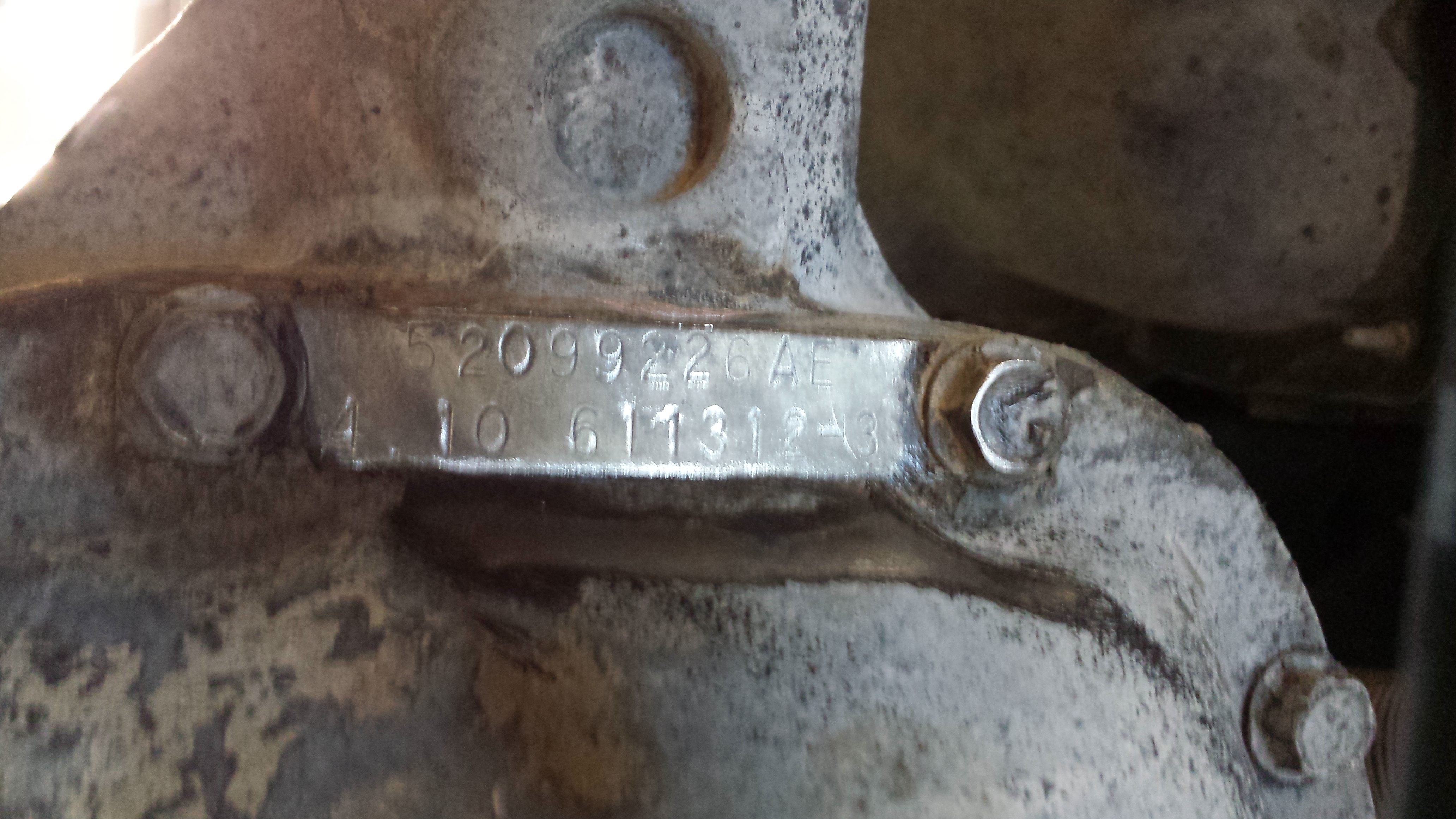

I need reassurance before ordering gear sets. Please confirm that these are Dana 30 and Dana 35.
Take a pic further out, of the whole diff, but beings they have 410/411 I'll assume 4 banger?
Yes they (4 bangers) come stock with Dana 30/35
Sent from my note2 using my thumb
Yes, it is a 4 banger. The previous owner installed 35" tires without regearing it. I would like to go with 4.56 or 4.88 to regain some of the performance. I will take a couple more pictures. I really do appreciate the help being new to this.
2003 TJ D35 rear and D30 front low pinion. If I were you and it's being lifted, I would get an XJ front diff to swap in (high pinion is better driveshaft angle for lifting) Maybe find someone with a 4.0L TJ that wants those nice gears and swap diffs with some $ in your pocket you can put towards your new gears.
You won't really notice going from 4.11 to 4.56, not enough of a change to warrant the cost. Go with 4.88, that's as low as you can go in stock axles, and it still isn't low enough. I run 5.38 with my 2.5L 5spd on 35" tires and it's about right.
Carnuck, not only are the driveshaft angles better with a front high pinion, but the gear mesh is a stronger setup because you're running on the drive side of the ring gear, not the coast side.
