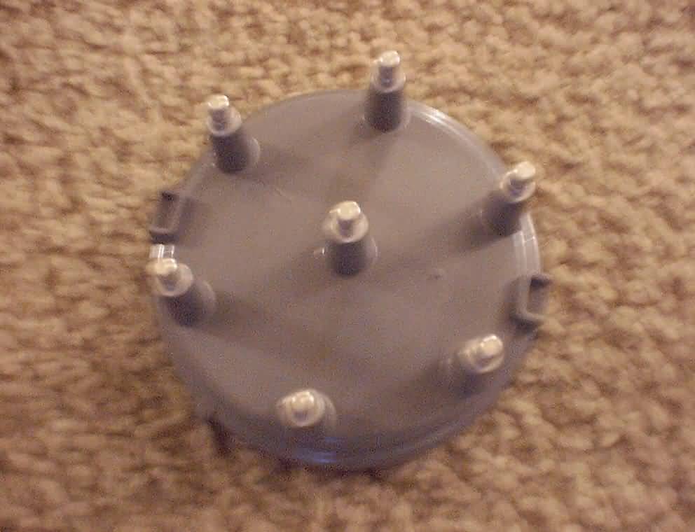

What you need:Distributor cap, rotor, base (this distributor is a two piece type, with a base that mounts to the motor and a cap that clips to the base), spark plug wires, and ignition coil. All these parts are from a 1982 Ford F-150 Pick Up Truck With A 300 CID I-6 Engine
