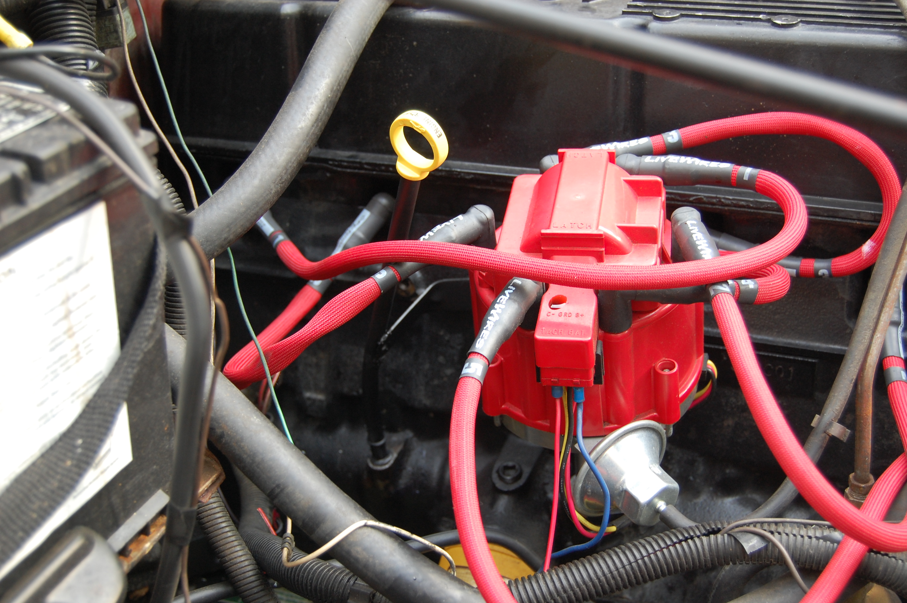

Well, got the new parts from the Jeep Dealer for the 4.0L and it worked well. Needed to cut off about two inches from the bottom of the new tube, re-mark the FULL level and re-weld the mounting bracket (probably could have bent it to fit, but wanted a cleaner look). I did a "how to" article if anyone is interested.

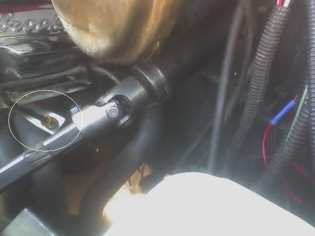

'Black Betty's' got the 360 but after replacing two dipstick tubes I happened to notice some of the old 6's had a stanchion had a tab from the valve cover to support the tube, since I was getting tired of replacing that danged thing I fabbed up my own stanchion using plumers tape, it may not be pretty, but it works;
