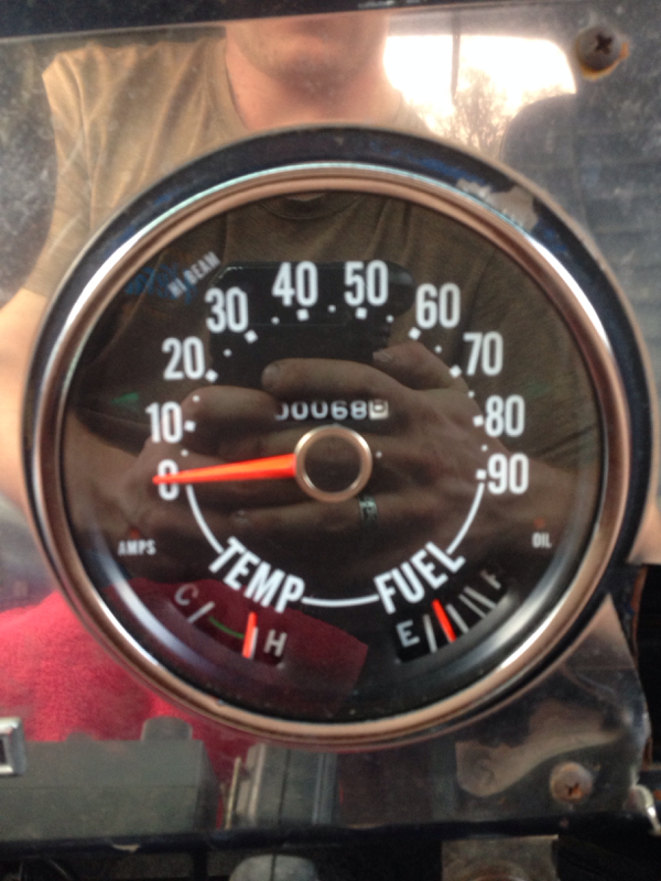

brewter2 New member May 7, 2014 #1 My cj7 304 seems to be over heating by what the gauge says but I can take the radiator cap off with no problem ? Any suggestions ?
JPNinPA Active member May 7, 2014 #2 Air in he system trapped near the sending unit. Or bad sending unit.
JPNinPA Active member Oct 1, 2014 #6 Bounty__Hunter said: Thermostat not opening? Click to expand... This would be a real issue, if the thermo didn't open or fail open. Something else (next weakest link) will fail or leak due to the increased pressure. Rad or heater hose.., Last edited: Oct 1, 2014
