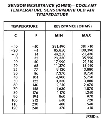

I'll check the temp sensor to see what the ohm reading is. I drove the jeep in this morning and paid closer attention to the engine temp and issue. On initial take-off, the RPMs are high when the clutch is pressed in. Once the temp starts to come up, the idle smooths out. This morning it took about 7 mile at 40 mph to come up to the 210* op temp. Was about 48* this morning
Yep! You may have a thermo that failed open. When the thermo failed open it took app 5 mi on a 30 deg day to reach 210. No matter how cold it is now 1-1.5 mi. Not that this is your issue but it will perform better when at temp.
Yep! You may have a thermo that failed open. When the thermo failed open it took app 5 mi on a 30 deg day.
Guess the thermo has a bearing on the PCM during open/closed loop? Guess I'm trying to understand why a thermo or temp would cause the studder. I had a thermo fail open in my 03 F-150 and it just took longer to warm up, not studder or stumble
It may not be directly related but needs to be corrected so the engine runs at optimal conditions. Your issue is open loop. Check the sending unit res as the engine warms. Like the o2 the readings can be erratic or just wrong and you could be in a too lean condition while in open loop.

Measure the res of the temp sending unit (on thermo housing) over the temp range before you commit the purchase and it sounds like your thermo will not let it get to 210. It needs to get to165. To fully come out of open loop.
Make sure the temp sending unit is the one in the thermo housing with wires going to the PCM. Earlier models used two one for the readout and one for the PCM.
