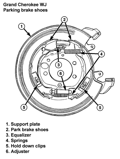

6. Parking brake, what does that mean? What do they check?

6. Part of the brake inspection. You have brake shoes specifically for the parking brake that need to be changed periodically. Here's a diagram
