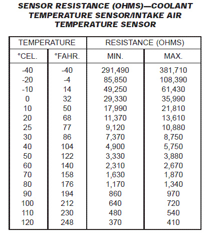

Check the resistance of the temp sensor as the engine warms up.
I'll edit this with the resistance readings when I dig them up.

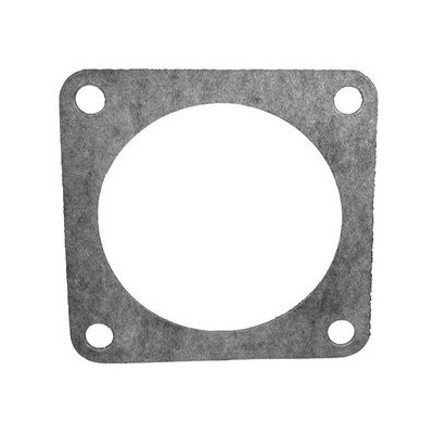

It took a while, I went on vacation and then when I got back the blower motor for my AC/heat crapped out. It being 95 plus degrees out, I couldn't go without the air. But I cleaned the IAC and throttle body. I will let you know how it goes. Is there supposed to ba gasket underneath the throttle body? There wasn't one there and I put it back without one.
YES! There is supposed to a gasket under the TB! Without one you will have a vac leak. The leak will cause erratic or high RPM and lean out the air fuel mixture.
