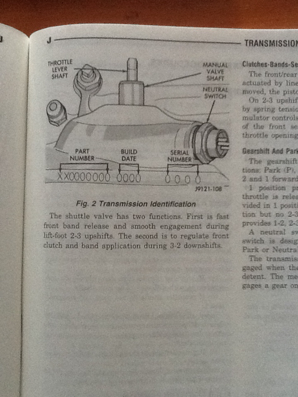

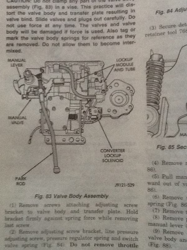

Sorry for the delay in reply . I have pasted a camera shot from my 1992 Chrysler factory service manual. The transmission in this year is referenced as a 32RH . That is the predecessor of the torque flite 999. For your purposes , your transmission will be referenced to as the TF 999. I just used the shop manual 32RH as reference as this is the only material I have. The photo shows the mechanism and you'll notice detent positions . Hoping it won't be necessary to pull off the pan take a trans fluid shower just for inspection purposes. But you will notice too that there is a detent ball and spring . Yes , this is a possibility. However , may I suggest first that you remove the throttle lever and shift lever noting their exact position for reassembly ( just to make life easier ) and feel the movement . Without any linkage installed , just wondering if any difference will be expected. Yes , trying to,save you work but also trying to figure this out with you as well. You see , the steering column dosen't generally have detent positions for each position . It will have gates to separate park from reverse , reverse from neutral . It must separate neutral from reverse so that accidental engagement from reversal trainer to drive is not easily accomplished. Neutral to drive is for other reasons ( like nasty neutral drops ! Very abusive however ) . These positions only have the gates as mentioned and from drive the column lever will need to be pulled toward you to select 2nd & 1st. Although I mentioned there are no detents , there are gates. It is the responsibility of the transmission to provide the "click" in the detent we are seeking. With the linkage disconnected from the column and the transmission , I would suggest to trying these gates on the column and detents on the transmission. I realize you posted there are no detents but we still need to know exactly what is occurring when the column shift is lit through its movement. More importantly , what is happening when the transmission shift lever is moved through its positions . CAUTION : chock the wheels securely . We don't want jeeps rolling over our members and causing property damage . You'll also want all the stress off the transmission to select positions easily. You may want to raise the rear wheels off the ground to make it easier as well. Please use Jack stands ? That makes me happy . Hoping you won't have to pull the pan off , but this post helps to serve you what the parts look like and how they may be affecting your jeeps transmission. There is the possibility you'll have to re-adjust the shift lever ( don't remember if there is a notch for the clamp to grab ) but pay attention the kick down lever mount position . You'll want it back the way it was providing the transmission was shifting right before hand.

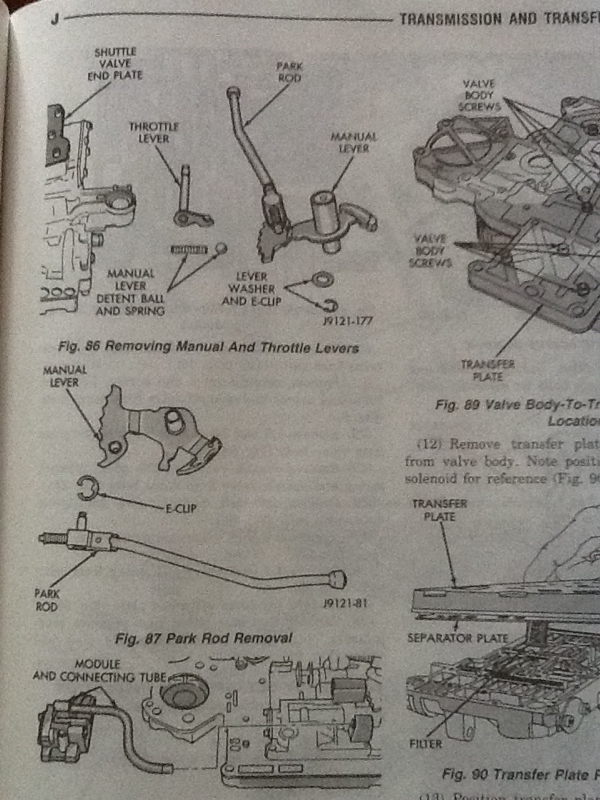

Sorry , forgot to include these photos in my last post. You notice a park rod . One end has an adjustment and the other , a plunger surface. Please ensure the plunger surface is mounted in a casting in the case casting hole with a spring loaded action if it comes to having to drop the pan. This plays a part in the detent action.
Thank you greg. I have had all shift rods off working on belcrank bushings. There is no resistance moving the shift main lever. I feel that the kid I bought the cj from was slamming it from drive low to reverse while in the woods. It came from the white mountains. The trany has a few drips anyway so I think I will have to drop the pan anyhow. I will try to print those pages thank very much for your help. I am also having carb problems but I will bother you with that later. Thanks again Scott
