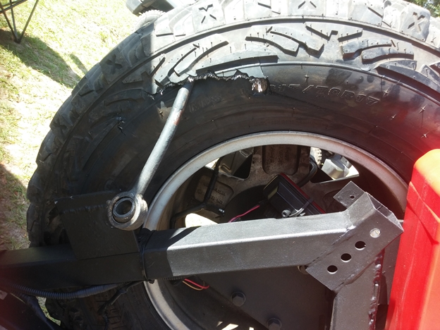

How do you fix this? At Jeeptoberfest Next to last obstacle on the course.
[h=2][/h] tire.jpg
Change to the spare was my only fix.
The second last because the last is now a jeep with a flat tire. Ha ha
Fix a flat. HaHaHa!
Or this
Sent from my iPhone using Tapatalk
[h=2][/h]View attachment 22240
Aww that just needs a patch: some rubber raft matl, gorilla glue and a staple gun to hold it all together. Let the gorilla glue sit up overnight and youll be good to go... lol..
Ouch....time for a new tire & it looks like maybe some other parts too.
