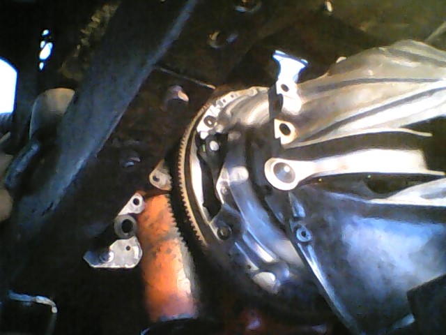

no real reason for the pics other than I know we like looking at them.. The trans would not go in with the bell attached to it so I have to bolt the bell on before the trans went in

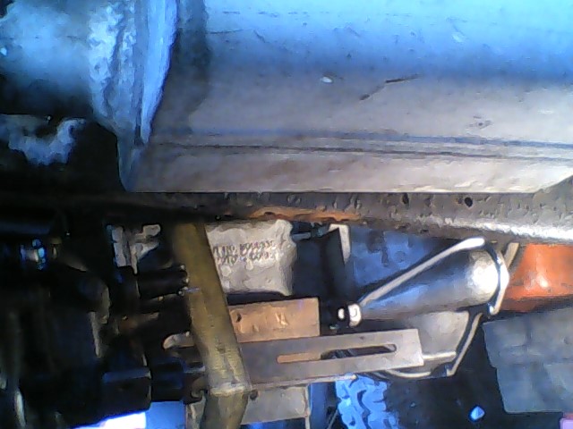

didn't load all of the pics. hope this worked. Well it didn't! I had 5 pics but I cant get them all to load so here are two of them. Today I want to get the driveshafts on and the shifter and linkage, slave cylinder back on and I think I will be ready for the road again.

Bummer . Yeah , the jeep's floor is tight on the firewall where it meets the floorboard . Either the floor access must be removed or the engine tilted out all the way which stresses the engine mounts . Either way , just increases the work load . Glad you'll be rolling soon ! Thanks for the pic's ! We like pic's !
