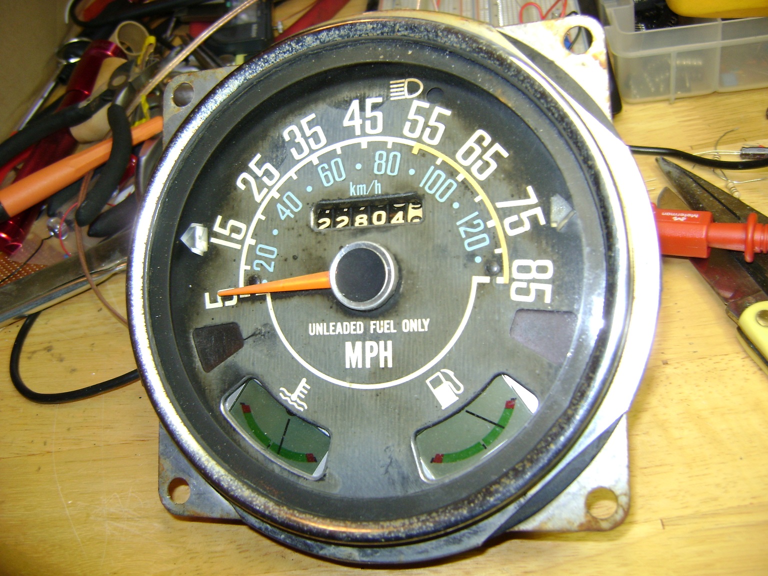

Glad I had two speedometers....
Got it ready to install the better looking face now.

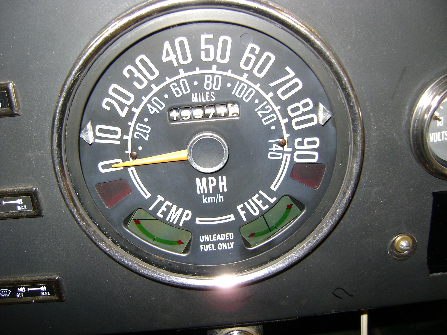

Well, its finished. It turned out pretty well. Now I have fuel, and temperature that work, with no load on the sensors.
Now to work on my stereo....
