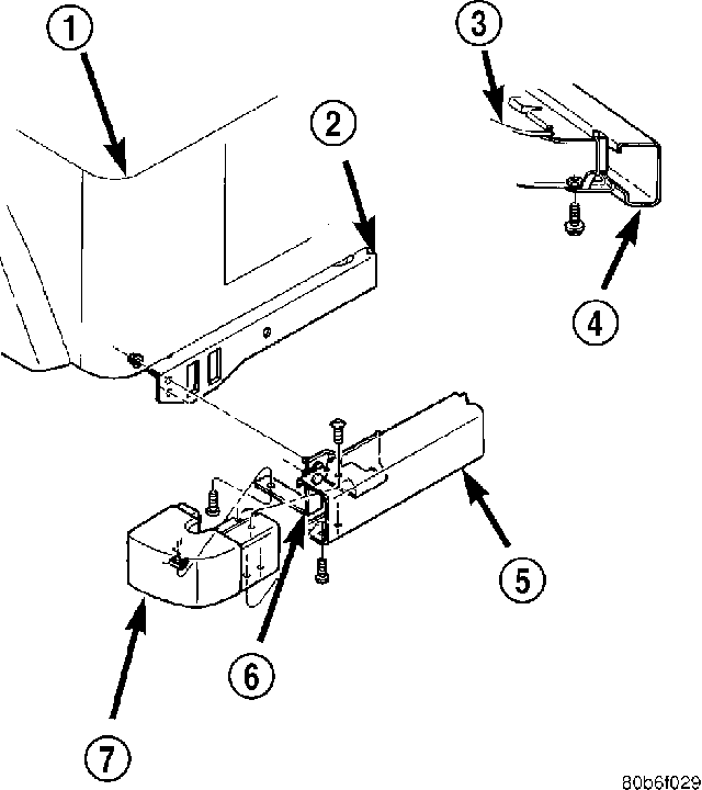

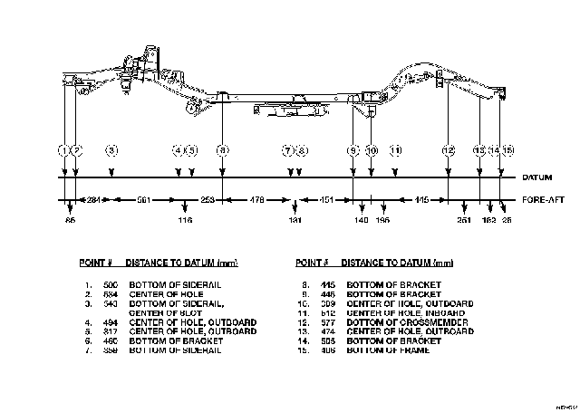

Can you point it out on the diagrams where this bolt goes to?
There really is not a good pic of it on the diagram....basically what I have is a box frame, I slid the bolt into the frame with my fingers, the threading of the bolt is sticking out of the frame with the bumper bracket,washer,&nut on it. In order to tighten the nut I have to hold the head of the bolt from spinning but I cannot get a wrench inside the frame to hold the head of the bolt.
Does that help?
