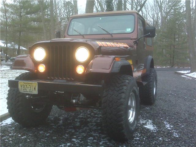

So I've painted and lifed my 84. I went SOA on YJ springs and run 35's and regeared to 4:56. Engine is a 258 transmission a T4 with Dana 300. Engines tired and I'm curious what you guys recommend I do. I was thinking of either rebuilding my 258 or buying one already rebuilt from 4wd or somewhere similar. For the transmission I need to get a T5 in there because I think the 4:56 gears where a little to steep especially since I usually am just driving on the street. So keeping in my mind costs what do you recommend? I could go 258, 4.2, 304, or a chevy 350. I want do something that's not overly difficult.
Thanks,
Tom
