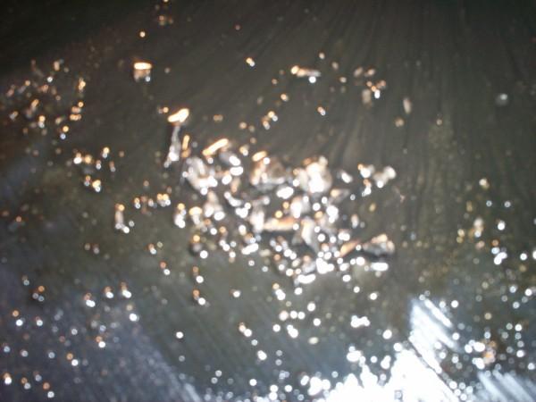

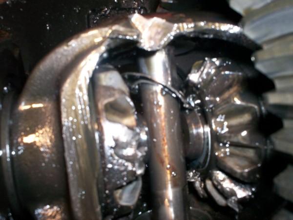

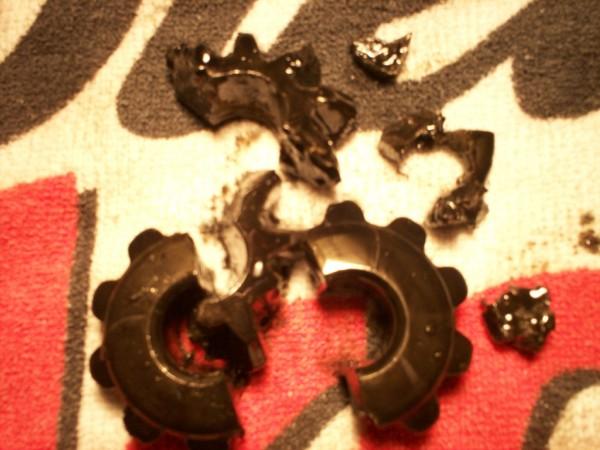

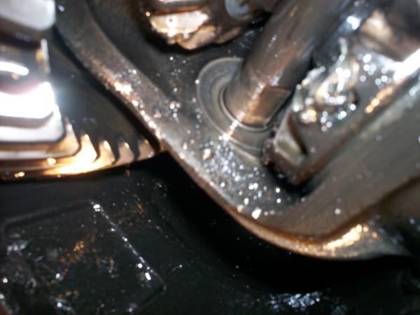

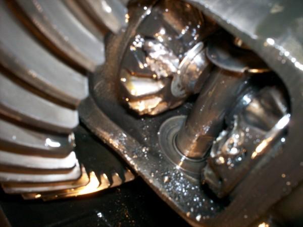

Here are the pictures of what all was broke in the rearend from the welding job the person before me did to the jeep. They were really bad at welding. There was weld spatter on the inside. It's rediculous. Hopefully everyone else has a better welded axle than this.

No penetration, likely not enough heat and not enough cleaning.
A lincoln locker can last if done correctly.
