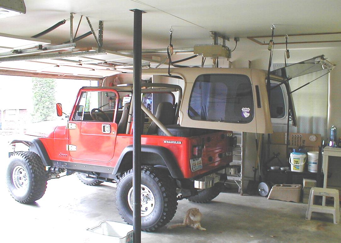

I made my own hoist for cheap. I used eye-bolts through the celing joist. Used locking ratcheting straps. I just have to raise the hard top about 2 inches and drive the Jeep out.
