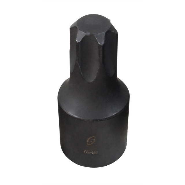

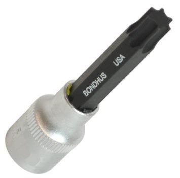

To keep from stripping Torx bolts there are a few things to do.
1. Clean out the Torx bolt corners.
2. Use a sharp torx bit.
This sharp
NOT this
3. Insert the bit into the bolt and heat it with a MAP torch or inductive heater. The bolts come out without stripping.
