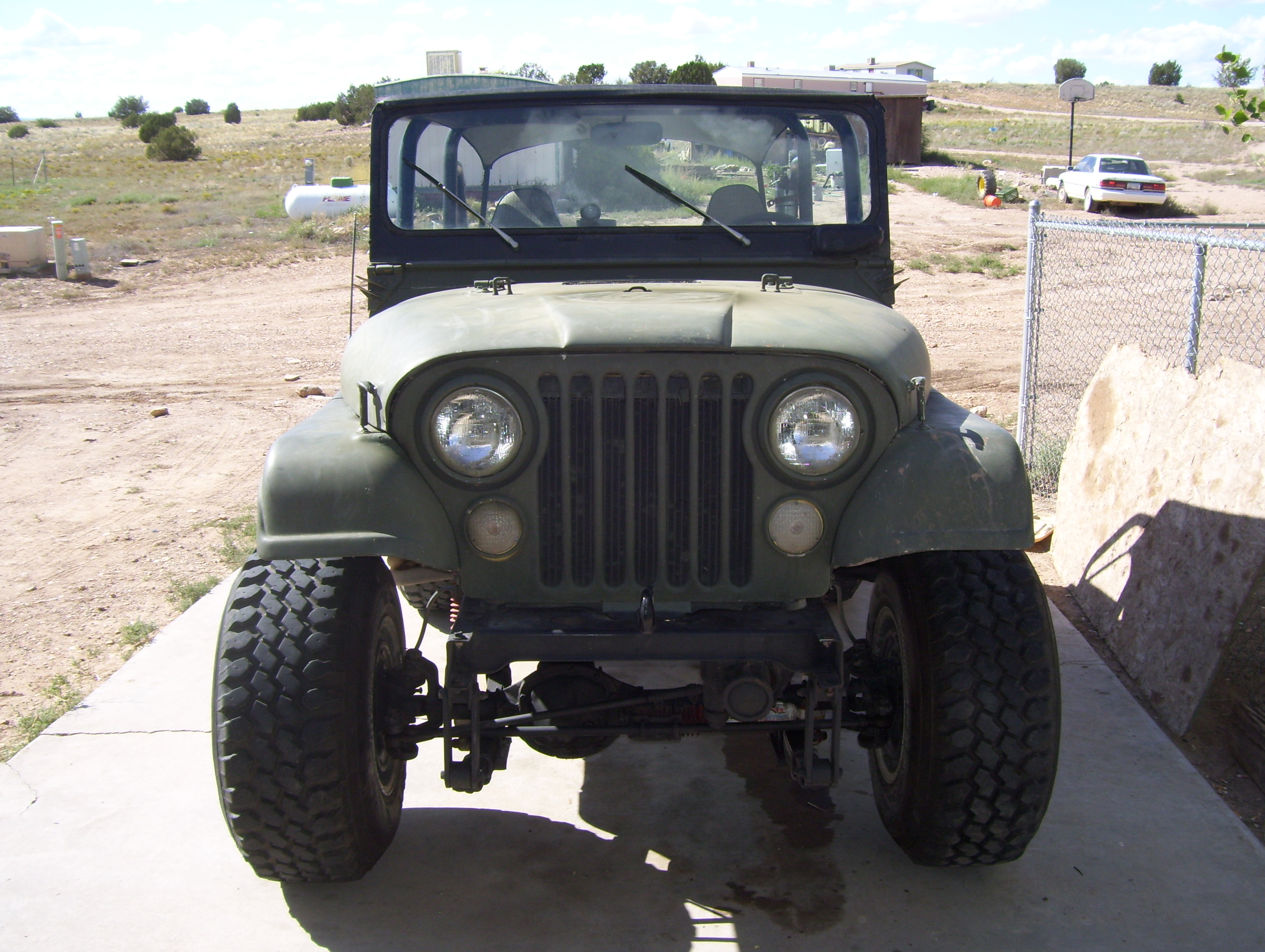

I have a 74 cj5 with a AMC 304. I was thinking lockrite in the front. and an electric locker of some sort in the rear.
