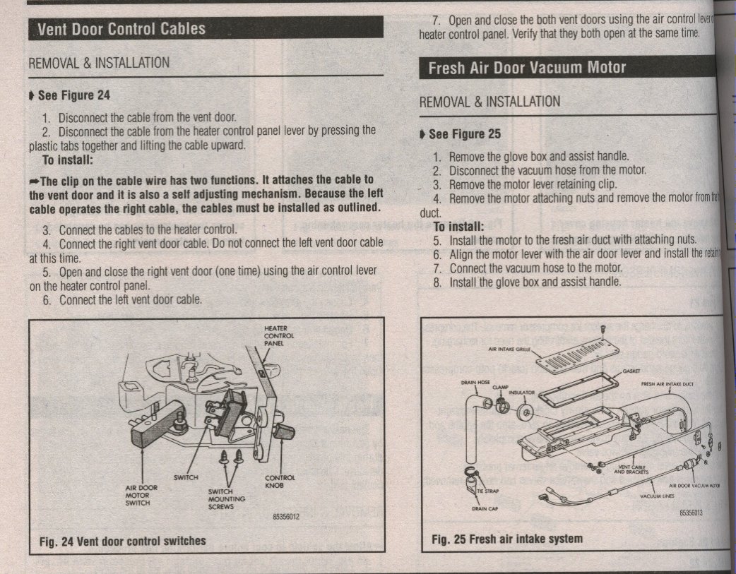

Red,
I found this diagram in my Chilton manual; it seems that there is a vacuum control, but also a cable? I gotta be reading something wrong here.... I know for a fact that the driver side's vent will open and close with a cable because it will open and open and close with the engine off, but the other one wont, and it seems in the diagram that one should be attached to the other.
Any suggestions?
Felipe
