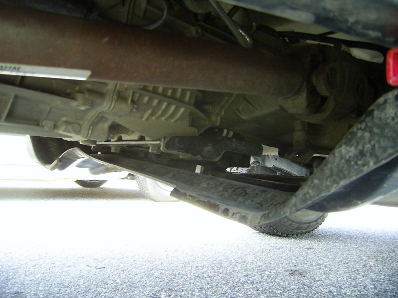

I went wheelin' at Paragon today with a group of 4 other vehicles. I'll post pics and more details tomorrow, but I have a question - While making a trip through Rock Swamp, I landed hard on a rock with my transfer case skidplate ('06 TJ Sport, btw). Initially the guy behind me said on the radio that I bent/broke a lower control arm. Upon inspection the control arms seemed to be fine, but we discovered a... lets just say "substantial" dent in my t-case skidplate. We moved on and I didn't notice any problems the rest of the day in the park, but on the way home I had a drivetrain vibration during accelleration, primarily in 2nd and 3rd gear. I have a 2" RE lift and a Skyjacker T-case lowering kit. Is the T-case lowering bracket attached to the t-case skidplate?? Looking at it, I saw 4 bolts coming through that appeared to attach the skidplate to the t-case. I'm thinking I bent the skidplate up and that FUBARred my pinion angle. Does this sound probable? Anything else it could be?

It's too dark now. I'll get ya a good shot of the dent tomorrow morning. It's pretty impressive, if I do say so myself ;) .

As promised, here's a shot of the dent.
Oops :oops: .

Uhmmm is the dent the whole way across the case? Front to back that is? If it's just that little part I don't think it did, if the whole plate looks like that, then you may be right.
No, it's just in the front as far as I can tell. If that's not the culprit, what could be causing the vibration? :???:
Pull the plate down and check your transmission mount, the bending may have ripped it apart. I don't think you raised the whole drivetrain, but I can't really tell too well from the pictures.

I'm thinking that you lost some of the drop that your kit provided. It may be racked sideways a little too.

Yeah, kinda what I thought, too, about it being cocked sideways a little. I'm sure putting it at that kind of angle where it's neither straight front to back or top to bottom can't be good.
