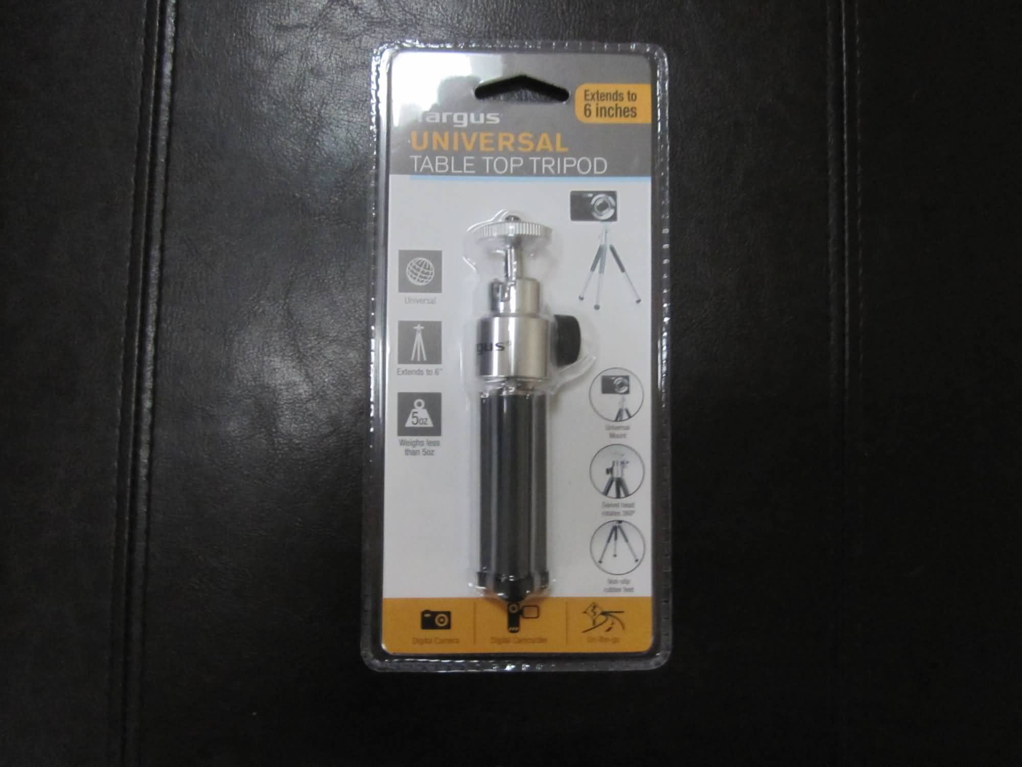

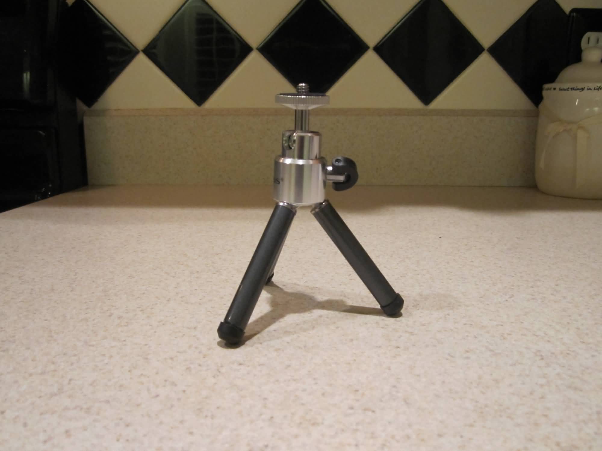

    I purchased the smallest, cheapest tripod that I could find at Walmart, and it ended up working perfectly.

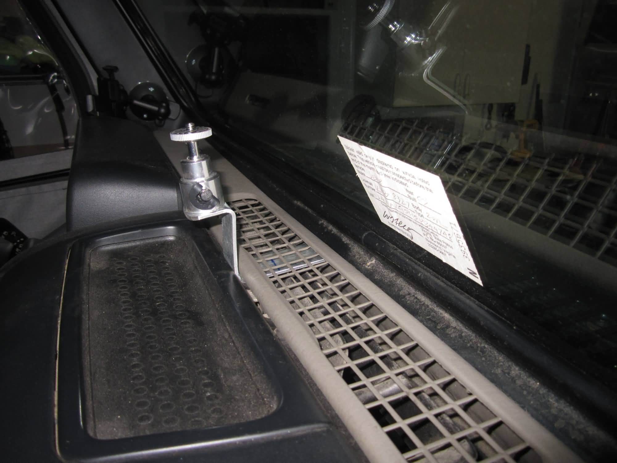

    Start by pulling the defrost cover off of your Wrangler. On my 2005 TJ there are no screws holding it down, I just needed to put my fingers through the defrost grill and pull up. You can see the trim removed below

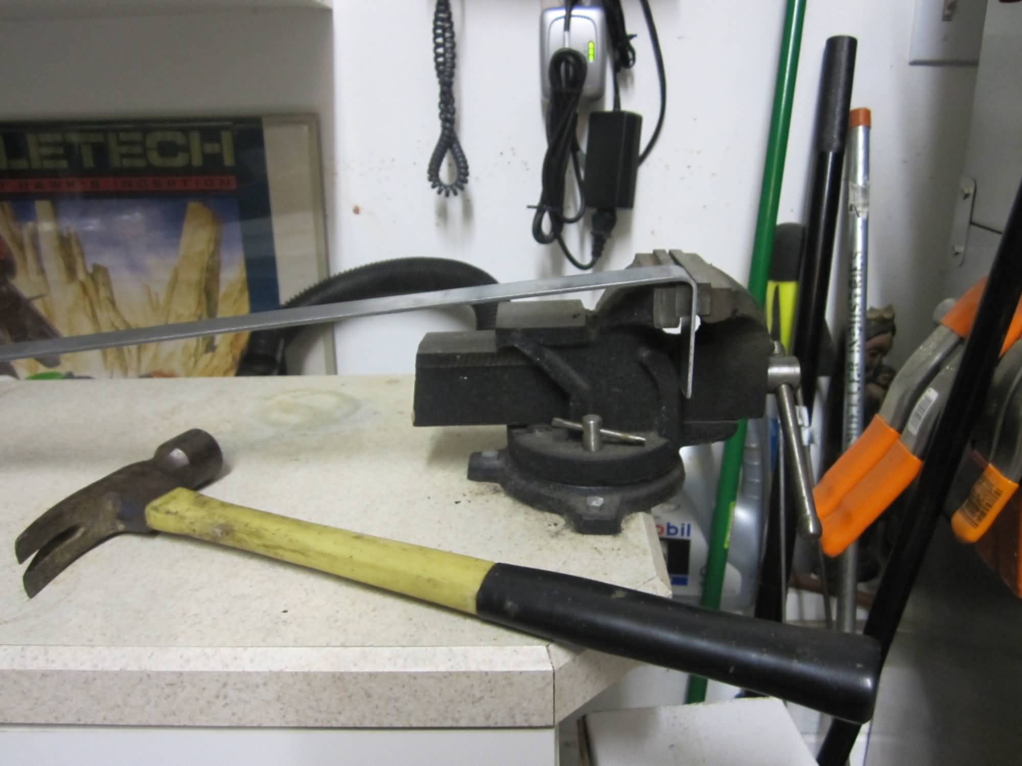

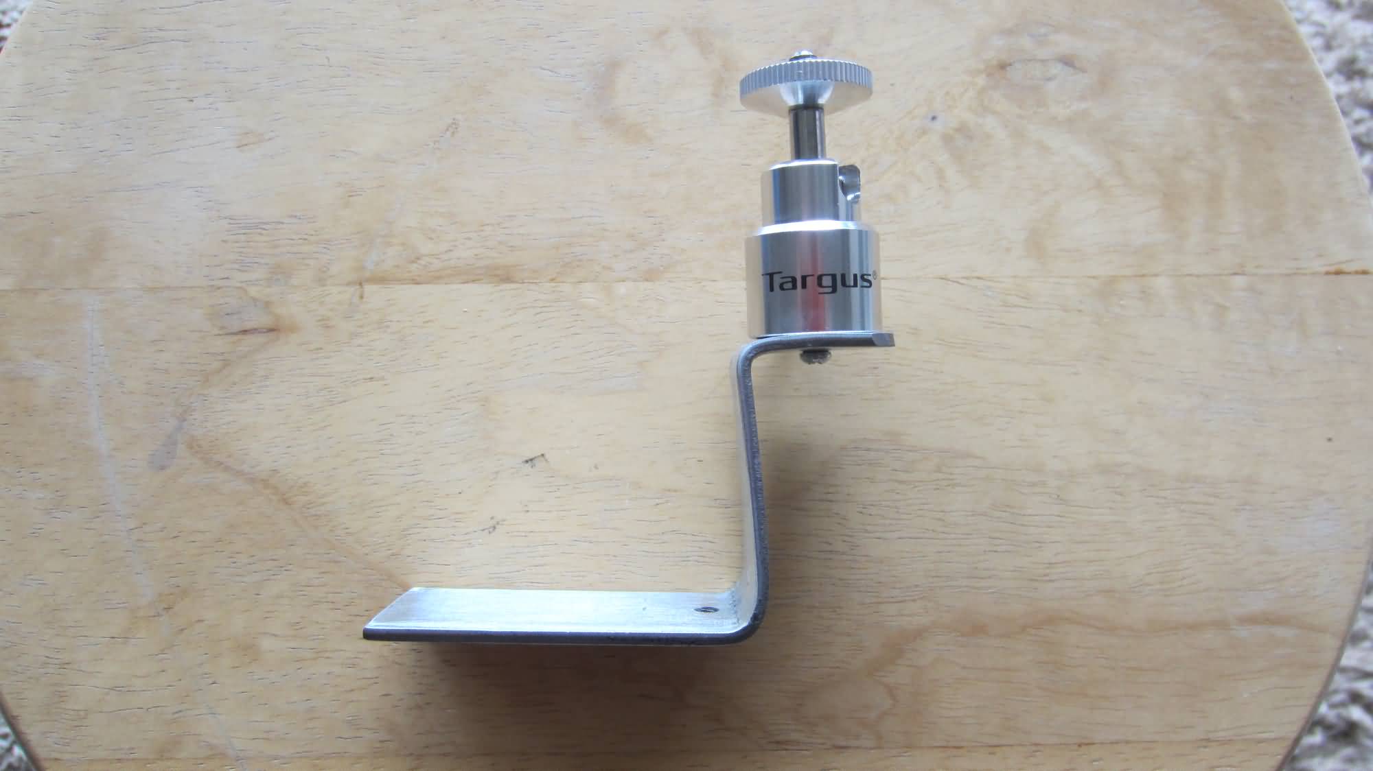

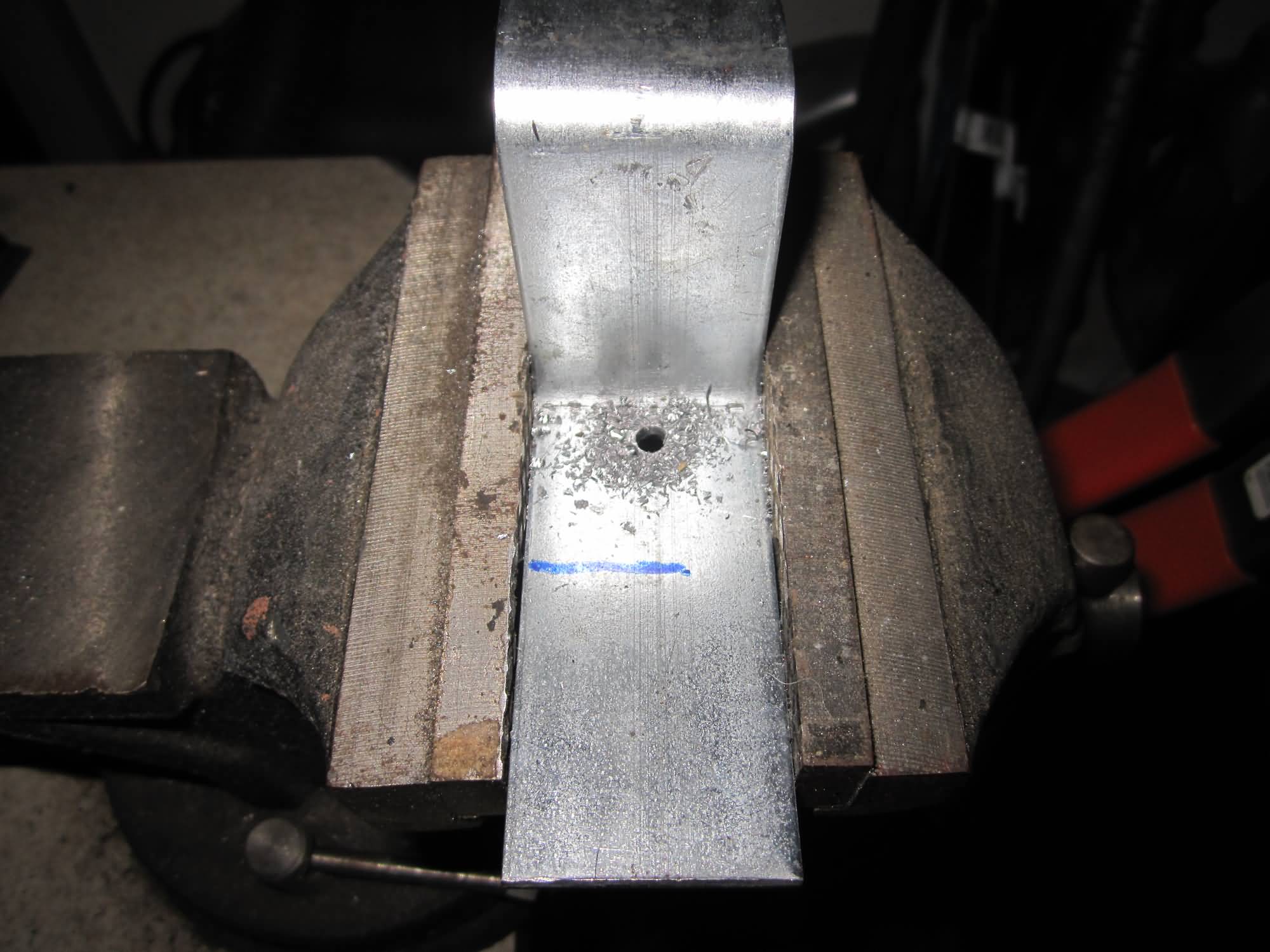

    Now to get down to fabricating our mount. Put a 90 degree bend in your metal rod about 2.5” from the end. A bench vice will make this much easier.
    Click image for larger version.

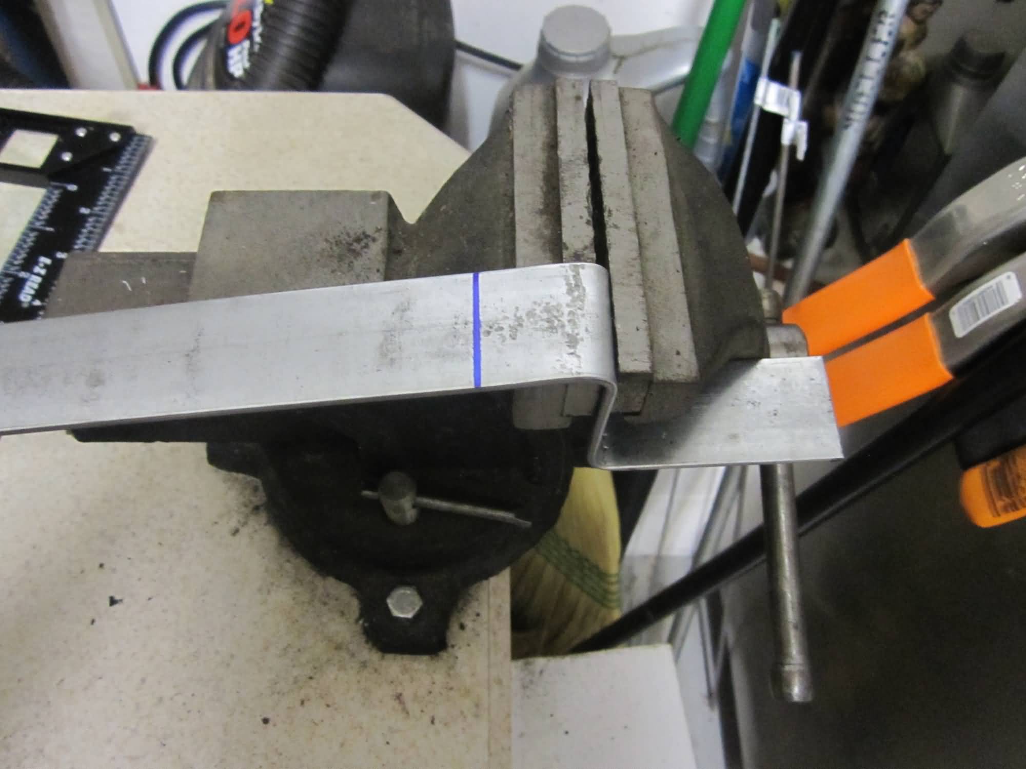

    Now, about 2” from your first bend, put another 90 degree bend in your bar so that it looks like the letter Z
ID:	9872Click image for larger version.
    Now, you’ll want to cut off the long section about 1” after your bend. I went ahead and rounded off the end a bit with my grinder
    Now, give your mount a test fit. Just remove one of the existing screws for use in your mount, and mark the spot on your mount to be drilled, and drill out the hole.

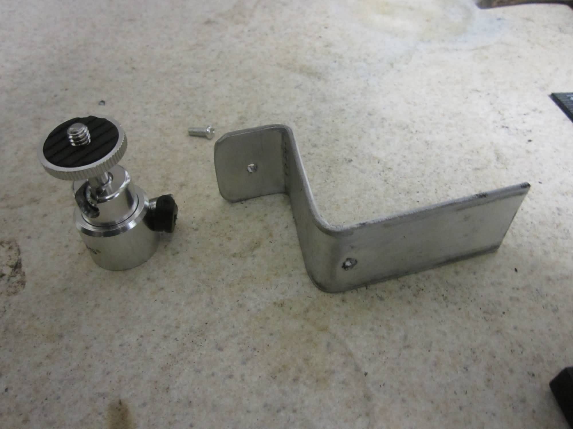

    Now drill a hole on the other end, and mount the tripod
ID:	9876Click image for larger version.
ID:	9877Click image for larger version.

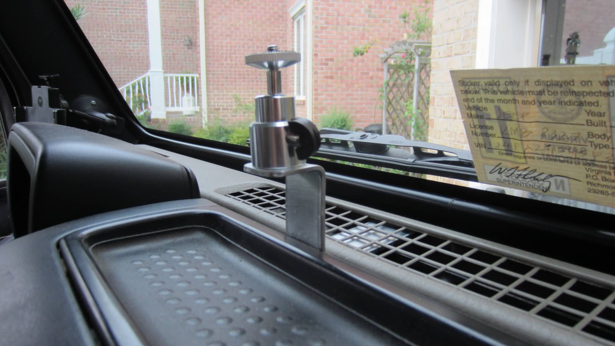

    You’re ready to screw in your mount now.
ID:	9879Click image for larger version.
ID:	9880Click image for larger version.

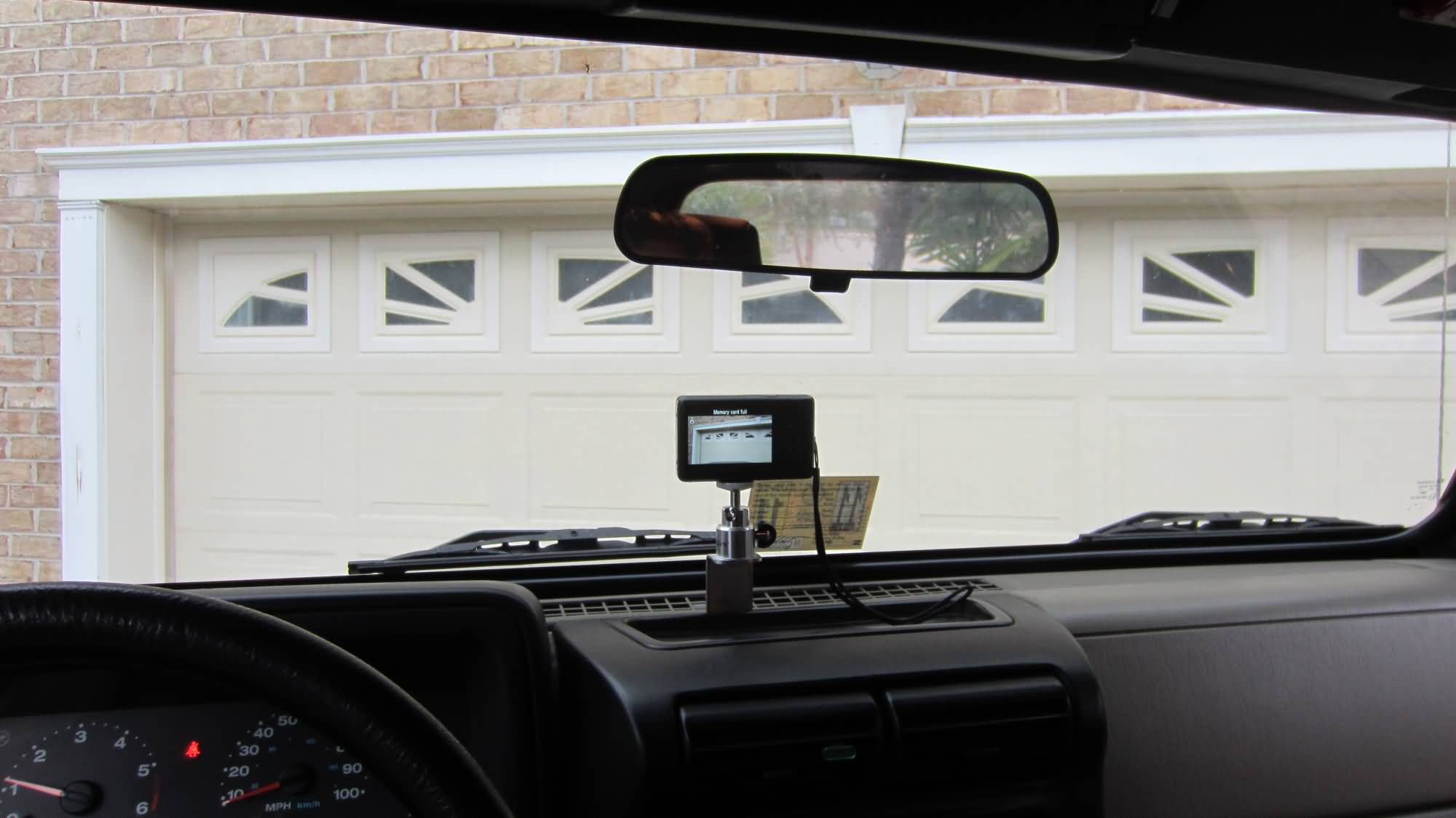

    And the finished product
ID:	9882Click image for larger version.
ID:	9883Click image for larger version.

    Nicely done, Terry. Do you get much vibration or shaking in the videos or stills while moving (beyond expected amounts on bumpy roads)?

    No vibrations at all, however when you hit a bump you can tell it on the camera (the whole Jeep moves, including the camera). I haven't had it offroad yet, but if I can get a good sample video I'll upload it.
    The video comes out surprisingly well.
