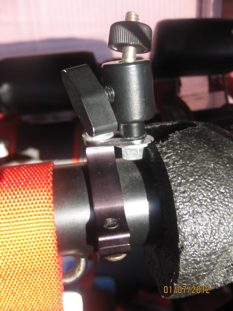

    I used a rollbar bracket and added small piece of metal bracket with 2 holes in it to attach my camera mount, which I took off a tripod like you did. The advantage of mine is that it shows the gauges as well as the window view. It also does not block my vision. The disadvantage is that I have to adjust the camera before I get in the seat, and then when I turn it on, it is hard to check that it is filming since I can not see the back of the camera with the screen.
    Nevertheless, it is great seeing and hearing videos of driving. (There is a problem with wind noise when the top is down.)
