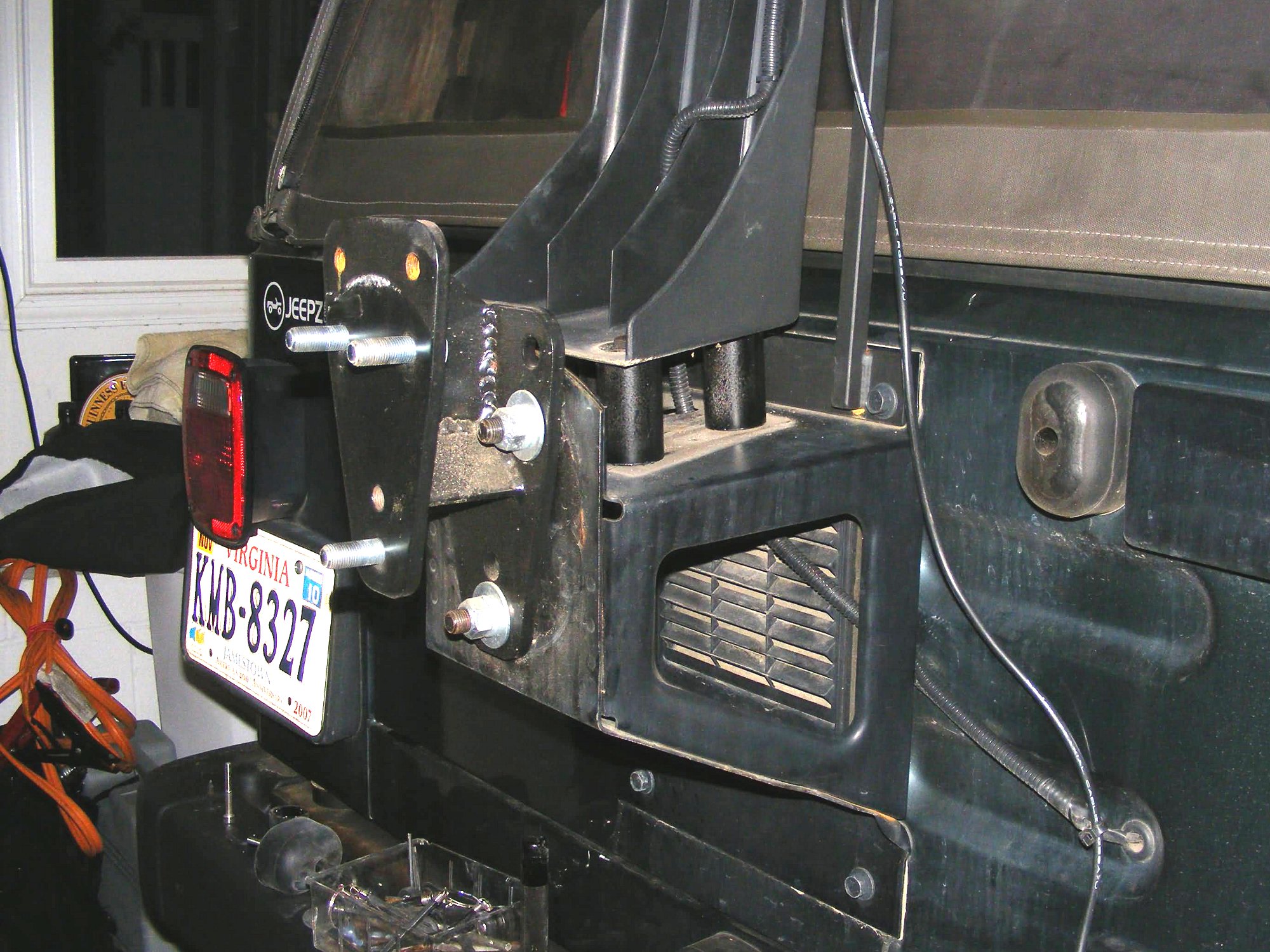

    First measure how high you'd like to raise your third brake light. Most likely you'll need another 1 or 2 inches (for a 33" tire).
    Click image for larger version.

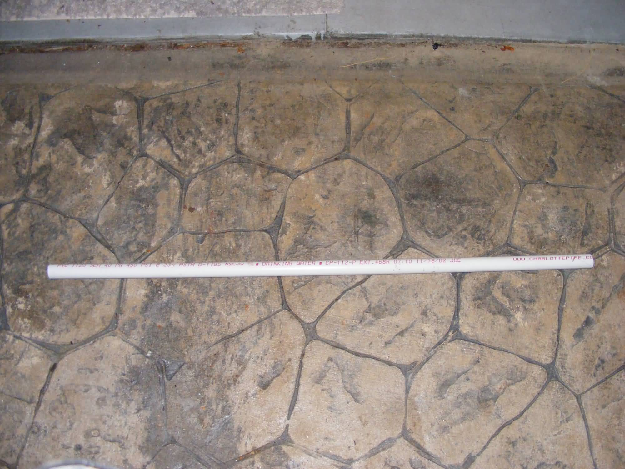

    Then cut your PVC pipe to length

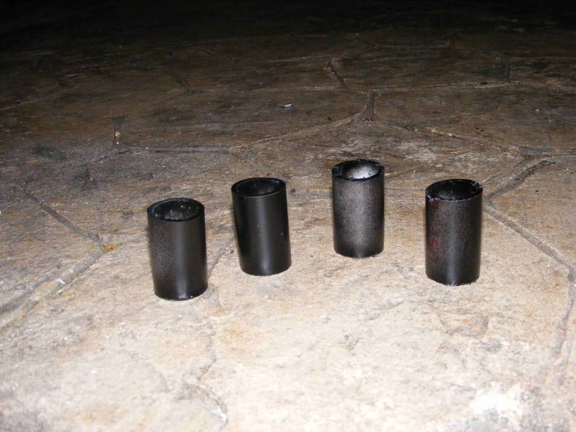

    Spray the pieces black (or any other color).

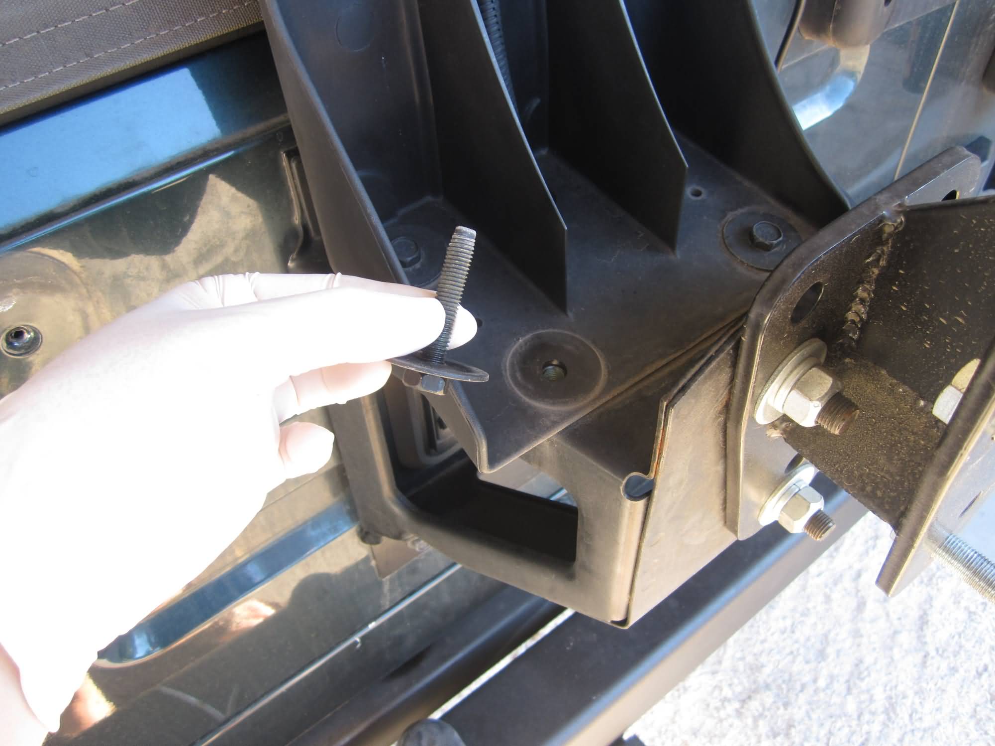

    Now, unbolt your brake light
    And install the new spacers, bolting it up with the new bolts.
