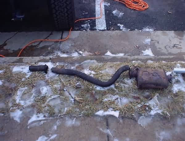

    This is my stock muffler, you can see that rust had rotted it all the way through. The best tool you can use in this upgrade is by far a grinder. Using the grinder, I began by cutting off all the exhaust clamps. They were far too rusted to even think of wrenching them off.

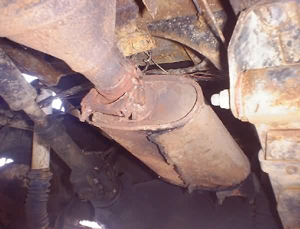

    After getting all the clamps off, I discovered that I still couldn't pull the muffler off. I used my grinder to cut a line in the muffler (see the picture) making sure not to cut through the pipe from the catalytic converter. Then, using an old screwdriver and a hammer, I peeled back the old muffler like a banana. This process ended up working nicely.

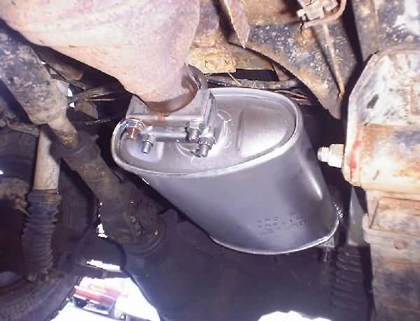

    After the old system is out, you should assemble the new system on the ground, and finger tighten the blots. Then put the entire system in place and tighten everything up.
