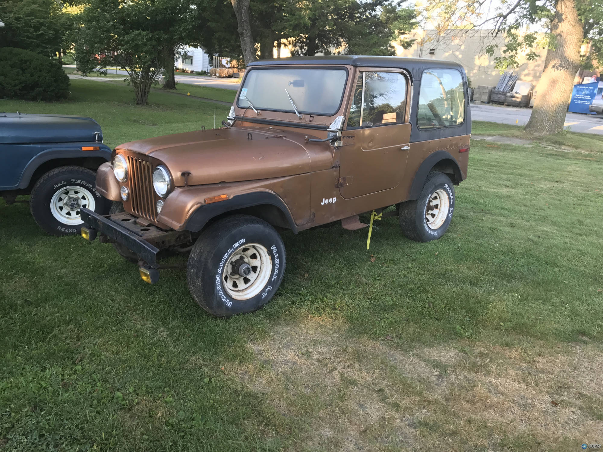

    Here's the story. I picked up a 1980 Jeep CJ7 a while back that I intend to build as an adventure/overland rig. My skills are limited, so I will have to hire some of the work done, but I want to do as much of it as I can myself. As we all know, there is great satisfaction in standing back and looking at something you built with your own hands. A thing America is losing these days, as is so accurately reported by public figure Mike Rowe. I like him... he's cool in my book.
    Anyway, She isn't running now, but she is complete, and near as I can tell, almost 100% stock, (except added fog lights) so that gives me a known starting point. That itself is something lacking in so many old Jeeps, including my current CJ5. The "new": CJ7 has a 258 I-6 and the auto trans. The shifter is on the tilt column with a very nice Lecarra wheel. The dash, seats, everything about the interior and hardtop is complete and in nice shape. The hardtop even has a defroster in the back glass and a rear wiper. The doors are great and the roll up windows work perfectly. The windshield is a goner, and there are some panels on the tub that will require attention.

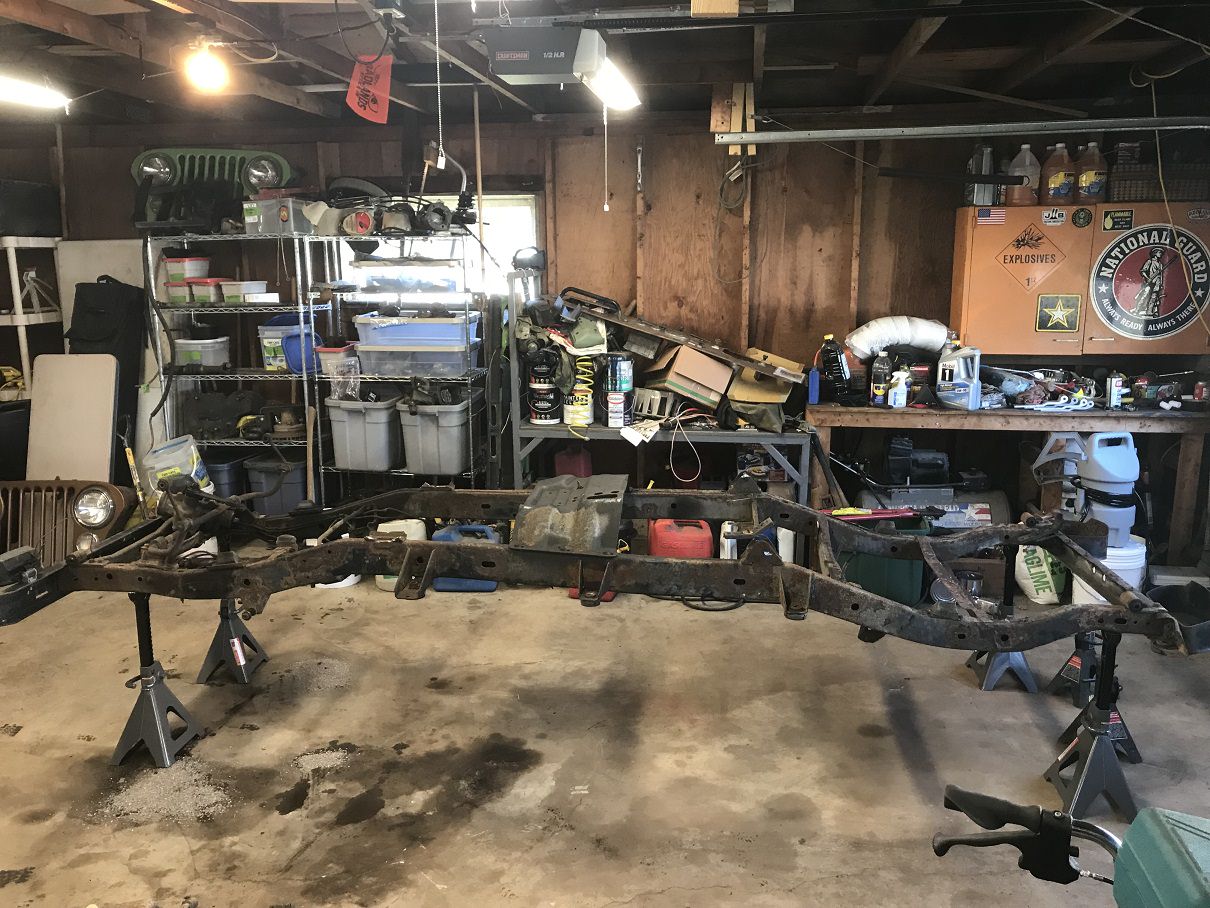

    Axles and springs are off. She's finally down to the frame. Well, almost. The steering box and front sway bar are still on, but I'm going to see if their location can remain unchanged if possible. It will remain upside down for a while, as I still have some brackets to cut and grind off in the front before I get to the sandblasting.
    Killer thing is from what I've read about building a vehicle, and from talking to those few people I know who've done it...
    Taking the old one apart... That was the easy part.

    Are you planning on doing the sand blasting yourself? I've never tried that.

    The trick will be getting the internal part of the frame.

    I have one of those portable plastic sandblaster tubs that hold about 50 pounds of sand.
    Keep in mind this is my first vehicle build. This isn't a professional deal here. It's a driveway/garage build, done by an unskilled cripple, with harbor freight, and Craig's list tools... I wish I had a way of getting the inside of the frame clean, but short of taking it to get dipped, I don't. I thought of checking into that, but the outside is only surface rust. If the inside is like that, I'm good. If I did get it dipped, it would be bare metal, then I'd be screwed because it would need to be professionally painted or it would start to rust like crazy....
    Driveway blast, and rattle can it is, maybe POR 15.

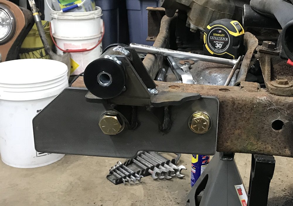

    Got some parts delivered this week. The Dave's Unlimited full size axle kit came in first. It's a well made kit, but will need slight modification. It is designed to hang a Ford or Chevy front axle under a CJ. I just happened to have a Dana 44 out of a Dodge truck, that is a bit wider. I'll need to put a 1/4 or 3/8 spacer plate between the new Dave's mount and the frame when I bolt it in for good. The rear mount will have to be cut and widened as it made to sandwich the frame. It also has gusset plates to be welded in after it gets bolted in place, so my welder guy will be doing that. I'll be prepping the frame and getting it to him this next week or so if I can.
