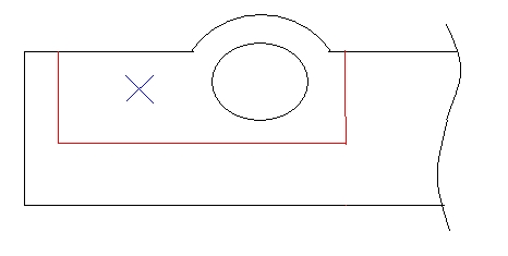

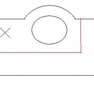

My proposed idea for how to modify a CJ rear crossmember to have the body mount in the right location for a YJ body. Cut on the red lines, flip over, and weld back in.
