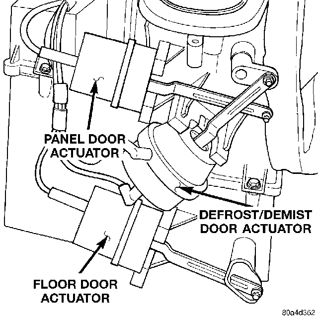

If you only lost the Defrost mode, chances are, the problem could be on the Actuator or the Control head unit.. It is not nescessary to remove the Dashboard to access the Vacuum lines to the control head.. you can check the lines thru the opening behind the glove box after you remove the glove box door. It's a multi colored vacuum lines that runs the network of actuators for different Mode settings..
Location and Removal of the Defrost Actuator.
DEFROST/DEMIST DOOR
  1. Disconnect and isolate the battery negative cable.
  2. Remove the steering column cover and knee blocker as described in Instrument Panel Systems.
  3. Unplug the two actuator vacuum lines from the actuator Defrost/Demist, Floor, and Panel Door Vacuum Actuators
  4. Remove the push nut securing the actuator arm to the stud on the defrost/demist door lever.
  5. Pull firmly outwards on the actuator to release the snap-fit actuator mounts from the mounting stanchions molded into the heater-A/C housing.
  6. Remove the actuator from the heater-A/C housing.
  7. Reverse the removal procedures to install. Be certain that the push nut is reinstalled.
