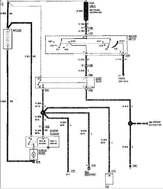

I measured the res and = 0.2ohms. No problem with the ground. When I turn on the ignition should I have a + at the distributor connector? I currently do not have a + at the distributor with key on. Where would be a good site to locate the wiring schematic?
It could be bad coil, starter relay, and ignition control unit.
