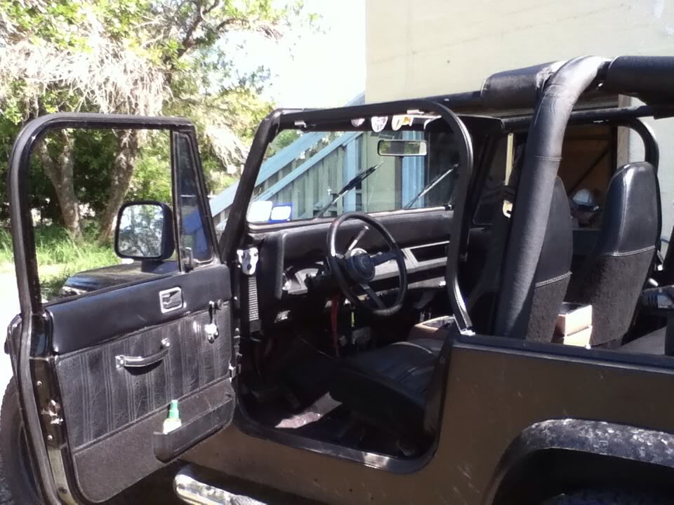

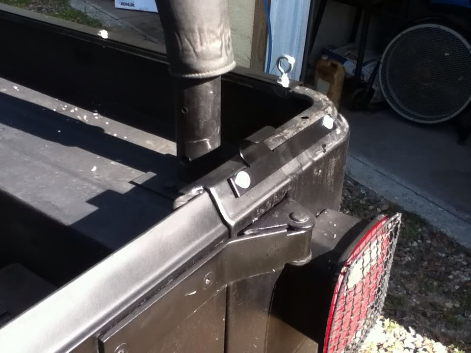

    after that, you are supposed to put on the tub rails and door surrounds. the ones they make are pretty darn good if you don;t have a factory soft top and there for don;t have your own.

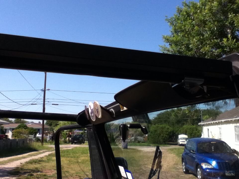

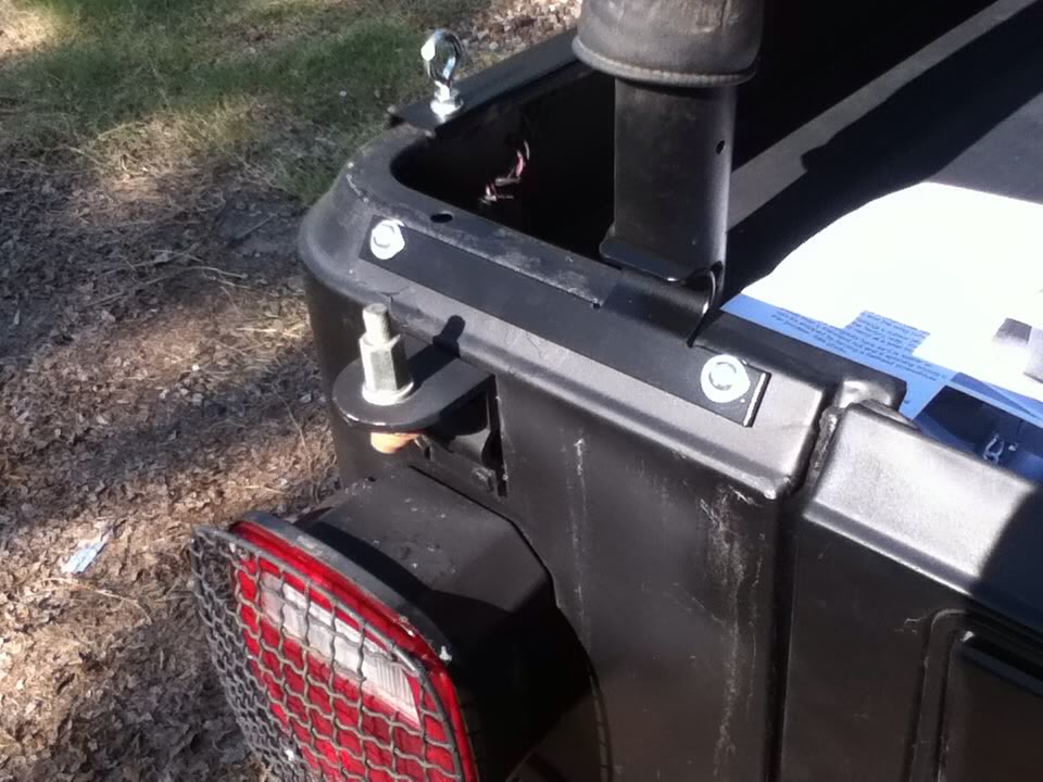

    you put hte eye bolt on the back

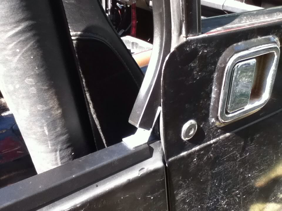

    then you put some brackets on the surround (that i failed to take pics of) and use the leading bolt from the tub rail to hold the surround down.

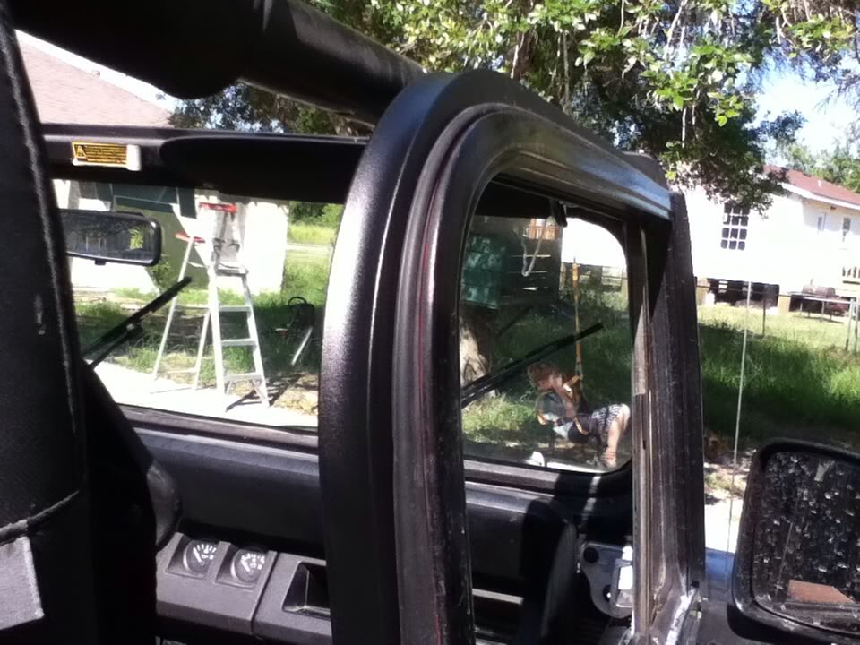

    adjust the surrounds so they are nice and solidly seated against the door
    and then you will look like this

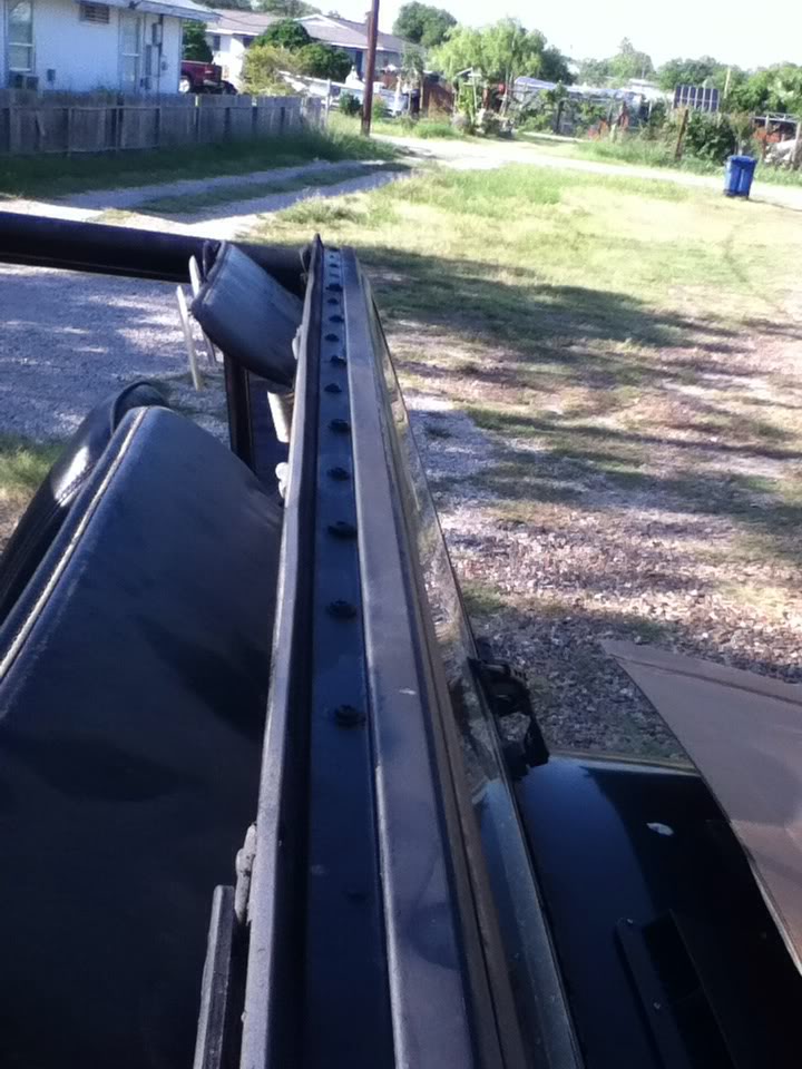

    next, you put the windshield header channel on. just like anytime you put it on but they send you a smittybuilt two piece unit with the top, i prefer the old one piece unit so i reused mine. since i had removed it and installed it so many times though, i had to add some more screws. as you can tell, i am planning on not removing this top for a long while :) . oh ya, smittybuilt uses some really cheaply made screws. three of them snapped while i was screwing them in to the windshield.

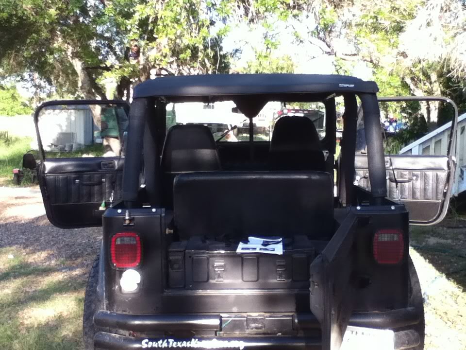

    after that, you put the rear channels on the back part of the tub. the channels that hold the rear window down

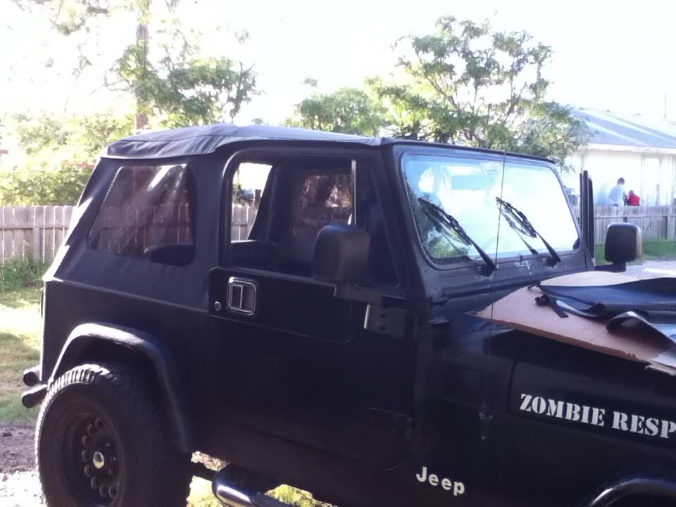

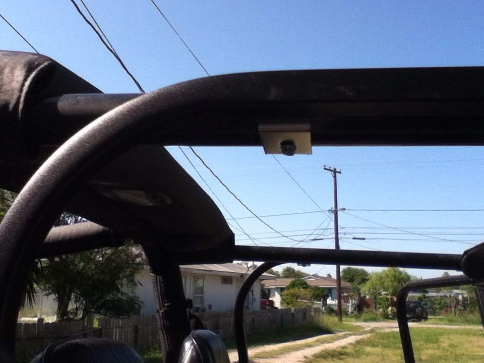

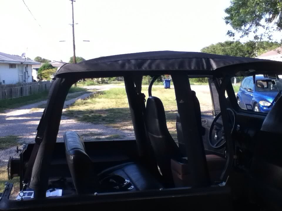

    then you lay the top on

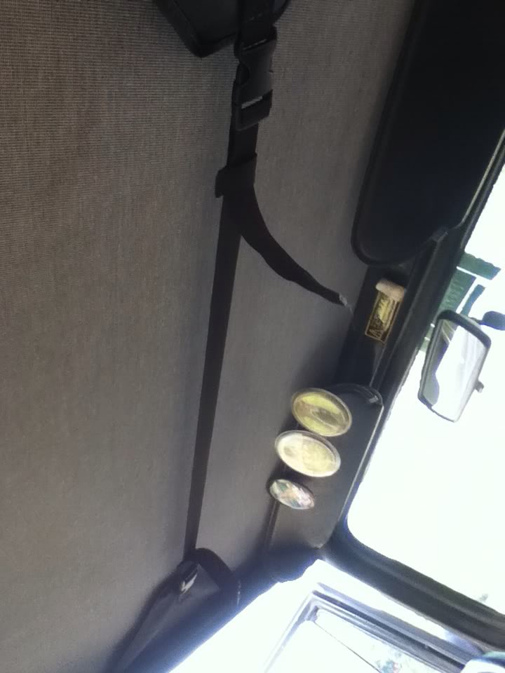

    it has some cool side straps and hte one from rear to front

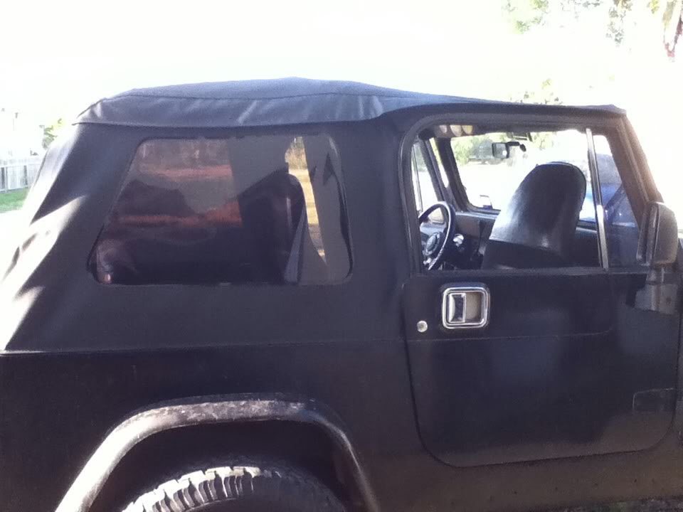

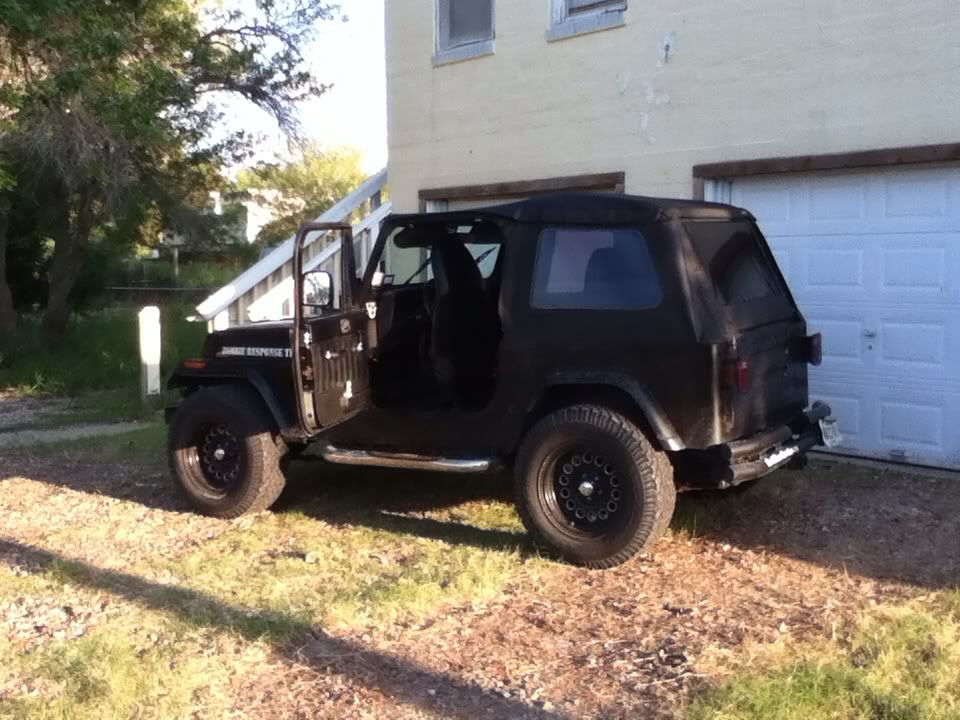

    after that, you put the windows on, just like the factory top, zip in and zip the rear window in and clip everything down on the bottom

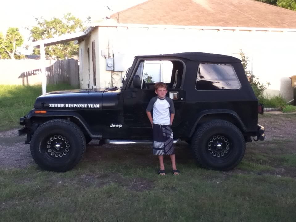

    having never owned a soft to vehicle, it went well. two hours or so to put it on and that includes the spots you have to drill for the 3/8s bolts that hold the channels and brackets in place. there is also a little storage place above the driver's head where the windows go when you have them off. its pretty cool
    the kids like it too

    ok, first drive on the highway with it. it flaps a pretty fair amount when you are driving into a headwind. i am going to tighten everything back up tomorrow again and see if it helps with that. the kids thought the windows were very funny from the inside because they are plastic and flexible and wanted to touch them a lot. i had to explain how soft top windows are and how they scratch very easily from dirt and finger tips.
    it was not as quiet as a hardtop but not overly loud either. when you roll the windows up, everything is nicely sealed up. i think rain leaks are not going to be something i will have to worry about because the doors seal up tightly, just like on the hardtop
