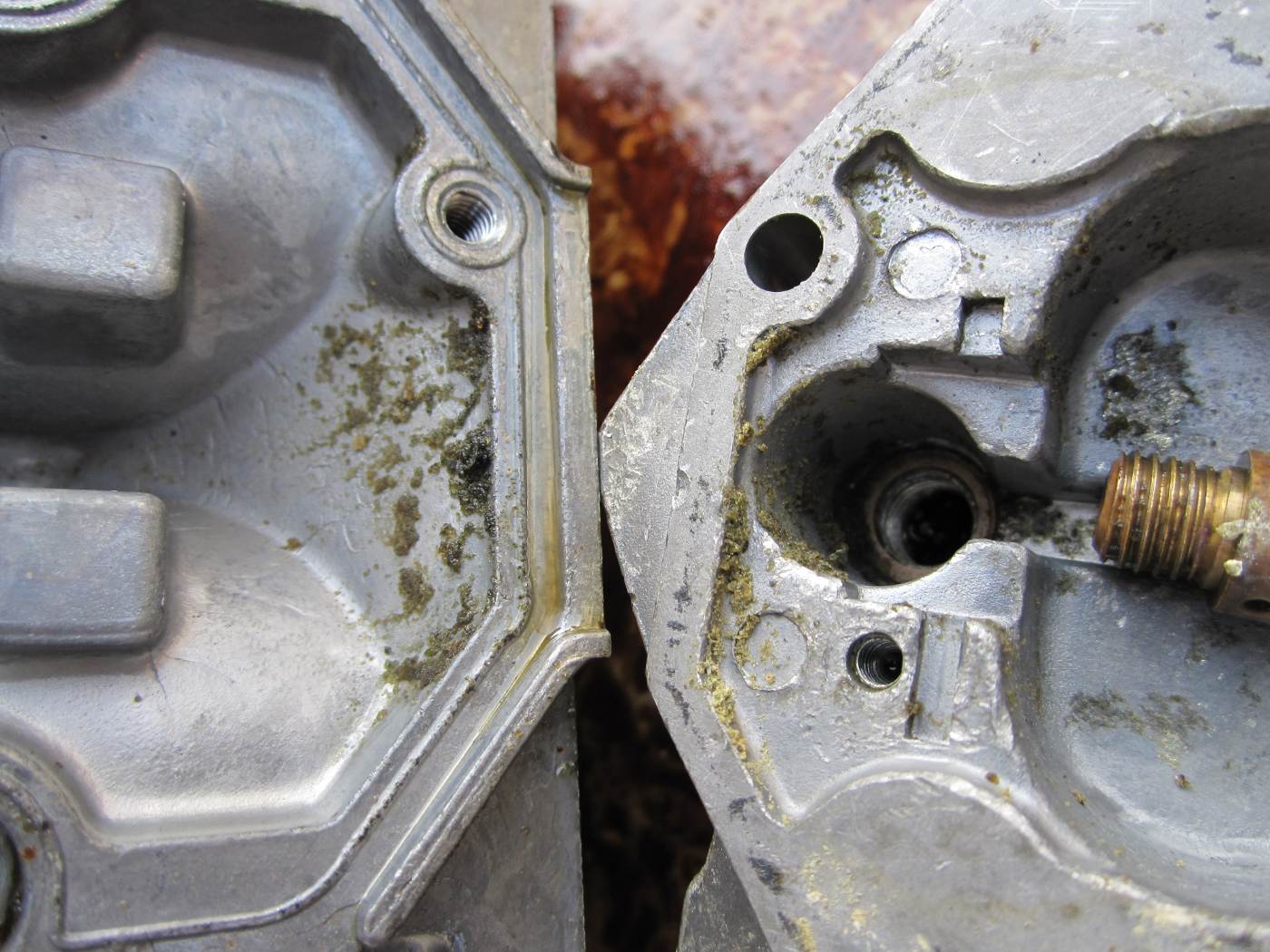

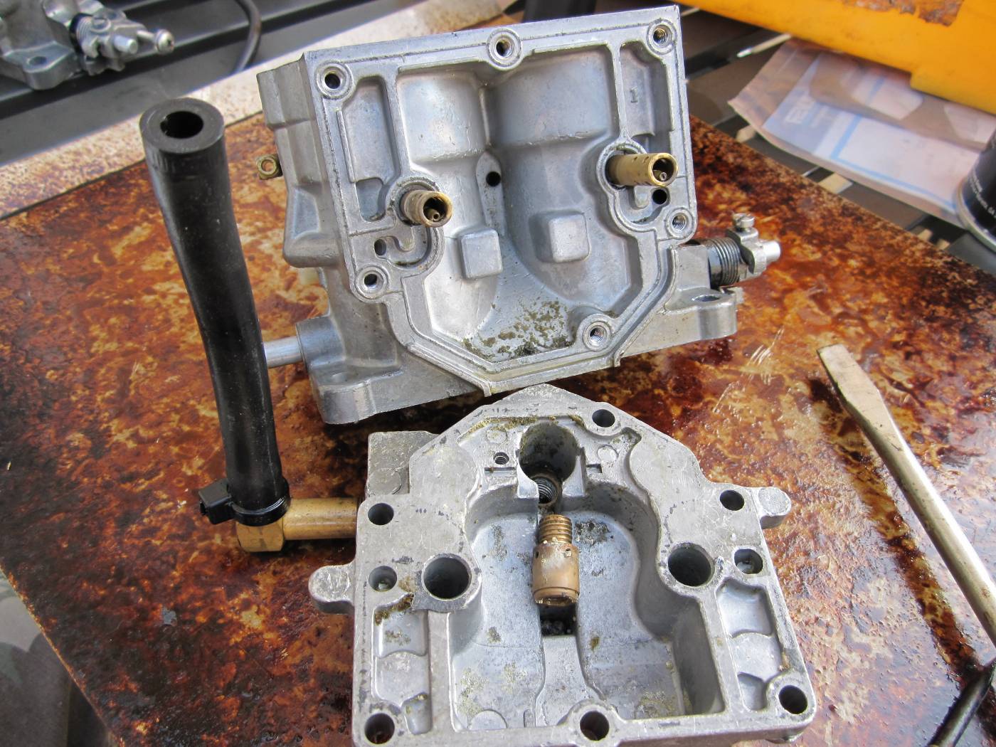

I just cleaned the three carbs on my outboard 2 weeks ago. When I cracked them open they all had stuff in it like this:
