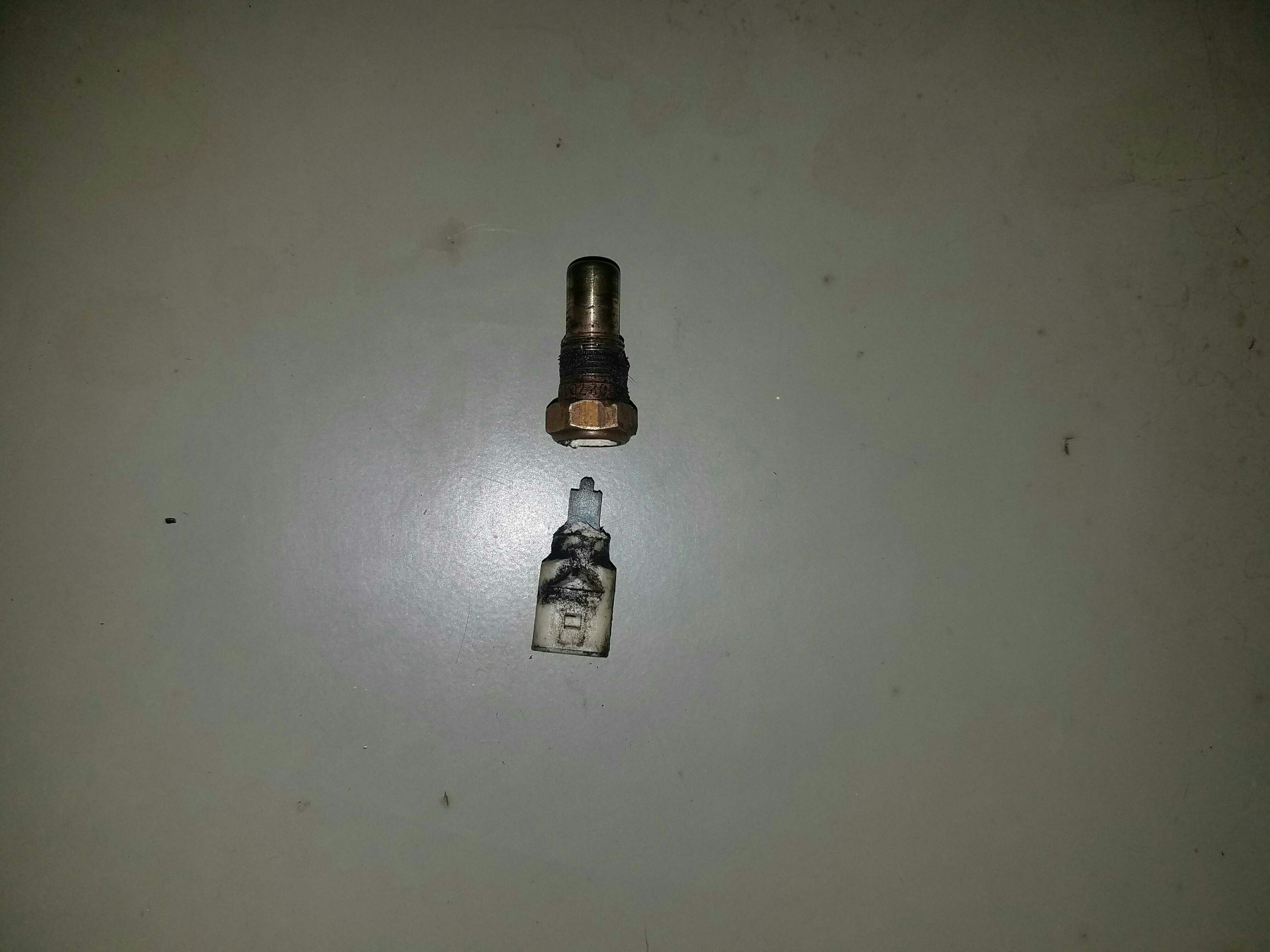

After i replaced 3 of my sensors the codes still pop up when checking my codes to make sure everything checking out
Code 23 - intake air temp sensor
code 22 - coolant sensor
2 new coolant sensors one befor thermostst and one on head replaced and new air temp sensor to get the codes to clear do i need to reset the computer and check again
Sent from my SM-G930T using Jeepz.com mobile app
Yes, unhook battery for half and hour or so and then Hook it back up
What happens when you slip and hit a sensor lol
I would rather replace a $20 sensor then falling busting face and dropping intake manifold seems a cheaper route to me lol
Ok now cleared codes out but now with new great functioning temp sensors my temp when sitting is 210 once i start going it climbs up to almost 220 is that normal or is there a coolant problem now befor replacement it sat at 210 and did not move
The sensor might be a little high reading. You have a bunch of new stuff in there so it should be fine, temp wise.
I have had cherokees that rode high on the gauge, all the time. They are just warm running engines
I agree but watch it. The only caveat to it reading is if like the TJ the reading is feeding both the gage and PCM when it hits 215-220 you go into limp mode. If it's is only feeding the gage no worries.
You should be fine in a93 Cherokee.
