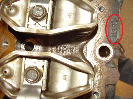

Head crack on 331 stamp but not a block the only block issue I've read about was the rear freeze plug rotted out. I don't know the whole history but I'd think overheating and running water with no antifreeze would cause that easily. Or never changing the coolant and overheating.

Just curious. What's a 331 stamp?

The heads are stamped with a design number. The 0331 design is almost guaranteed to crack.
