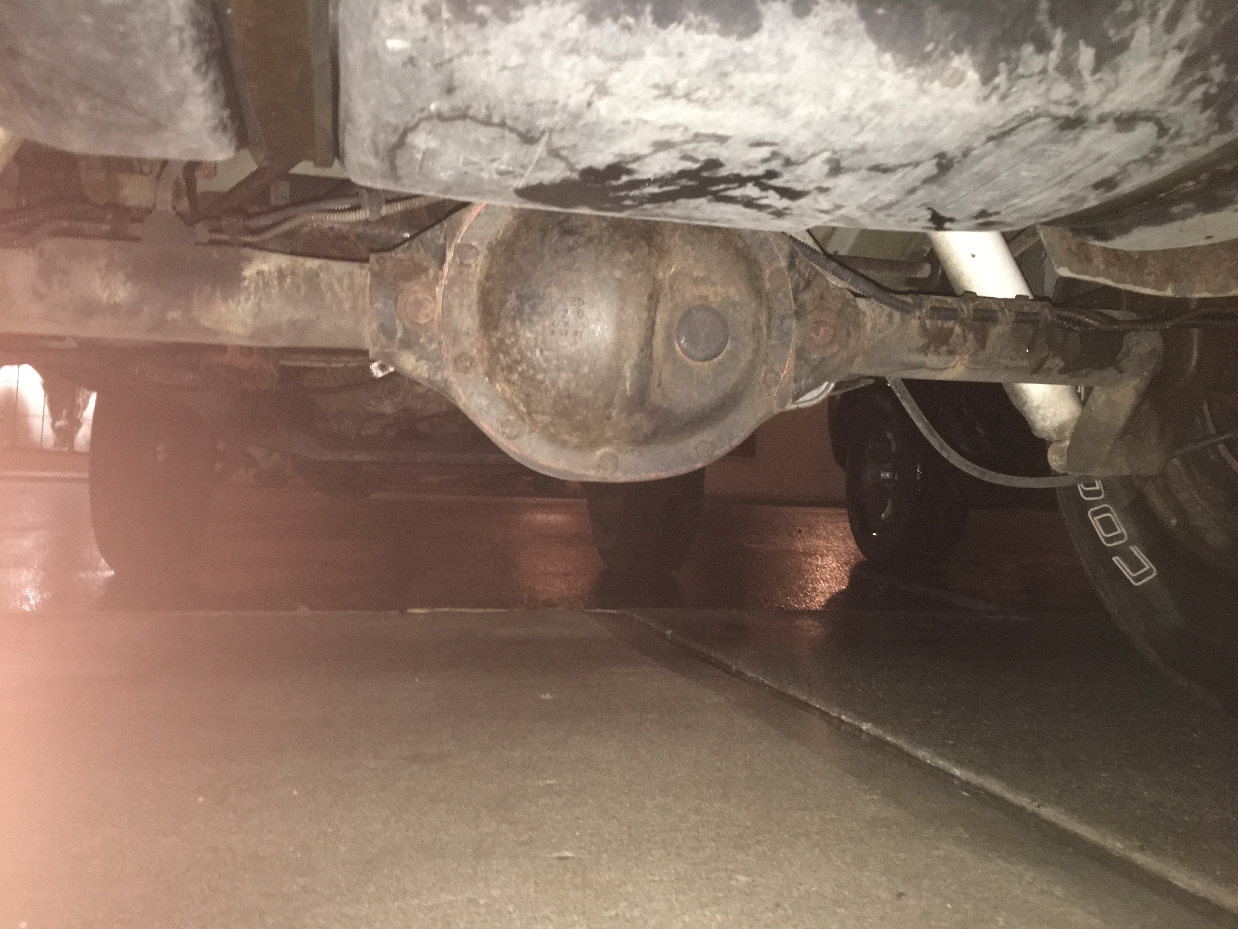

Debating on swapping out my rear end for a Chrysler 8.25 .... pros and cons? I will be getting a locker for it as well to make a posi rear.. I don't have it now, and don't have a clue as to what rear end I have in it now. Any suggestions? Any cool ideas? Budget friendly please. Found a Chrysler 8.25 off of another jeep xj.. it's quite a drive for it though. Lol.

An article/post might help

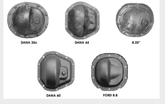

Only thing I have is an add a leaf spring and my dad did something else to it.. I got like an additional 1 .5" lift.. I'm about to add a stock 80's spare tire carrier. That looks like the Dana 35C, right? Sorry I'm a newbie and still learning. Got bit by the mod bug bad.. and I'm learning as I go.

8.25 will be a good easy upgrade for you, comparable in strength to the d44 and found in the XJ tow package.
