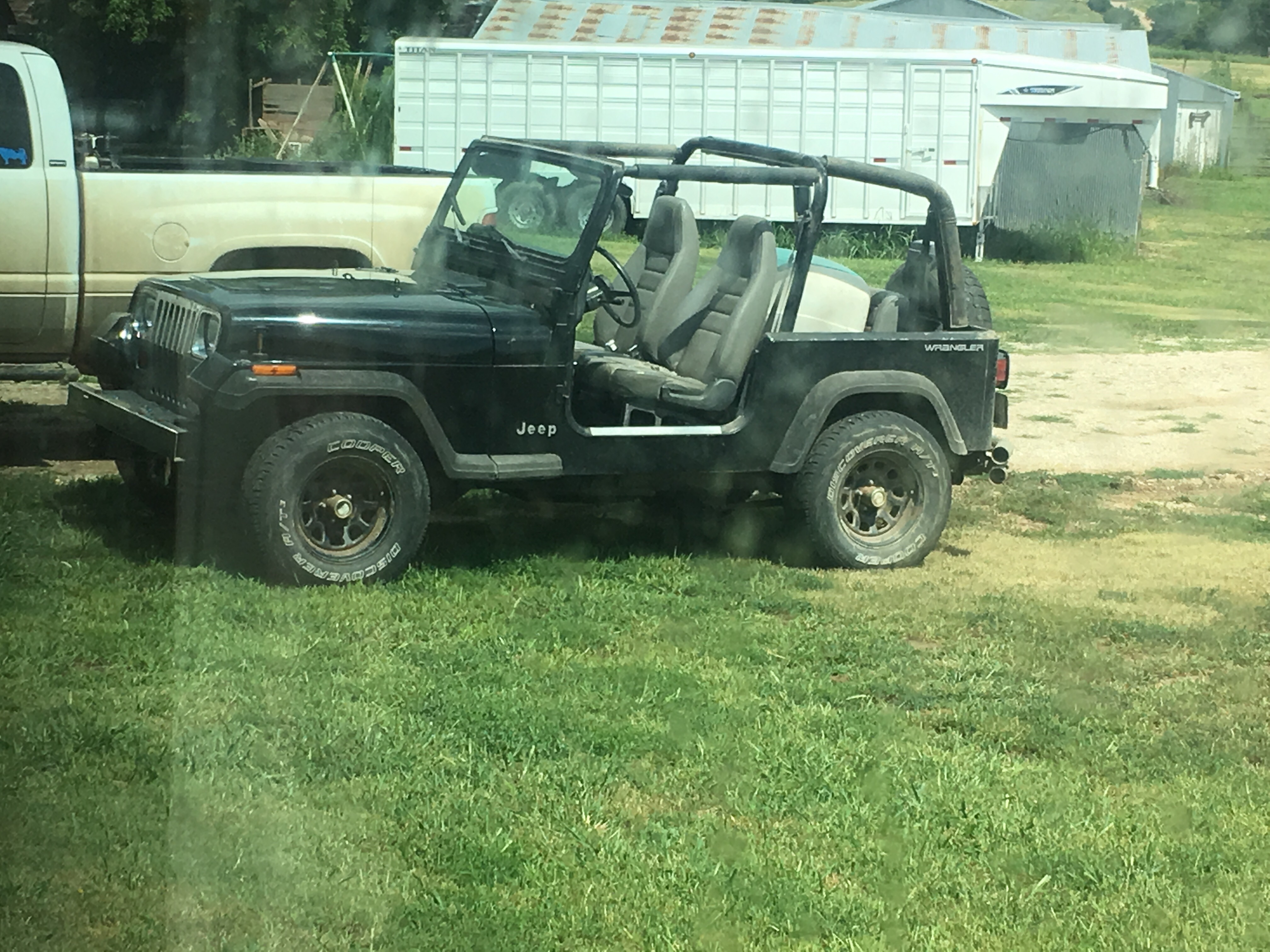

I’ve got a ‘95 wrangler and want to lift it slightly and put bigger tires on. It’s totally stock, and I’m wanting to keep a factory ride. I won’t be crawling over any rocks or mud bogging with it but it is used as a hunting rig and used around the farm checking fence and cattle. I’m guessing a 2” lift and 31” tires is what would work for me but ultimately I have no idea. There’s no 4x4 clubs or “lift shops” here and not really many Jeep wranglers around for me to compare to, which leads me here! I’ve read a lot of back and forth on suspension lift vs body lifts and haven’t really come up with a one is better than the other. So some insight would be much appreciated!
I would like to stay under $500 for the lift and I am thinking a 2” but not really for sure.
Stock tires are 235/75R15, I’m going for little taller stance and beefier look so just not sure if 31” tires with 16” rims along with 2” lift will raise it too much or just right. Was just wondering if anyone of you folks out there upgraded in a similar fashion.
