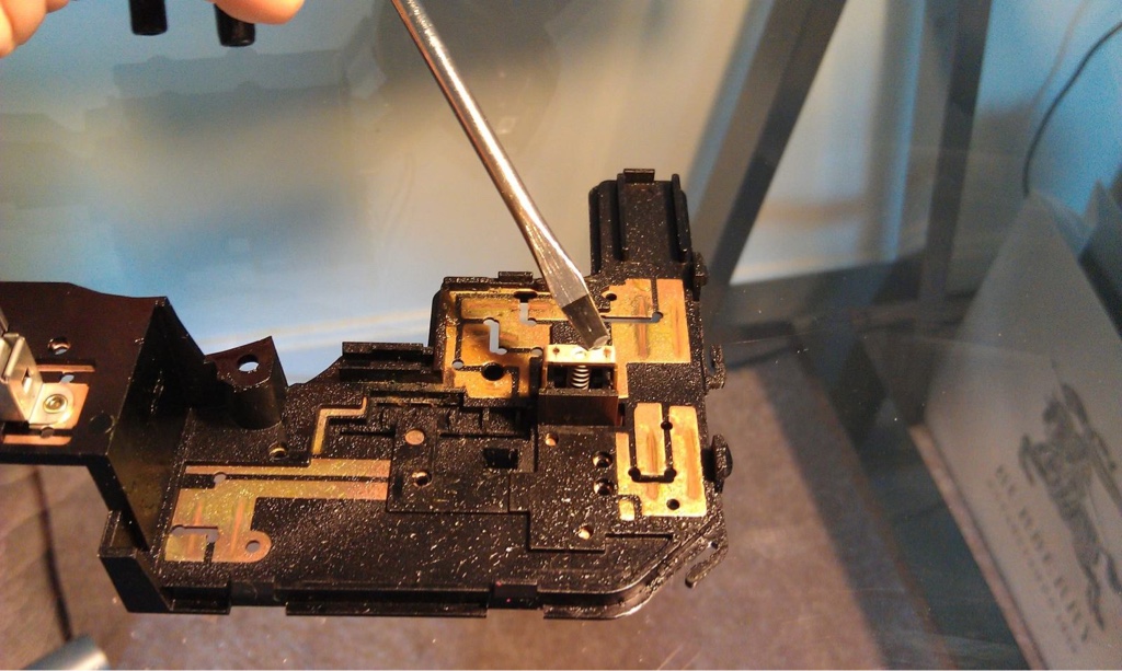

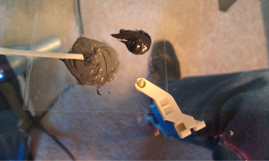

Likely the multifunction switch. I had a similar issue where the fog lights stay on key off. I ended up taking it apart and filling the worn plastic part with epoxy. So far so good. Cant say if the same can be done for your issue.
"Likely the multifunction switch. I had a similar issue where the fog lights stay on key off. I ended up taking it apart and filling the worn plastic part with epoxy. So far so good. Cant say if the same can be done for your issue."
Thanks so much ;o guess I'll pop of that switch and see if I can see any worn areas before I buy a new one...Where was that worn part located on the switch?
This is the fog lights.
Opposite side of this part is a polished beveled area a plastic rod glides on. The area was worn down.
