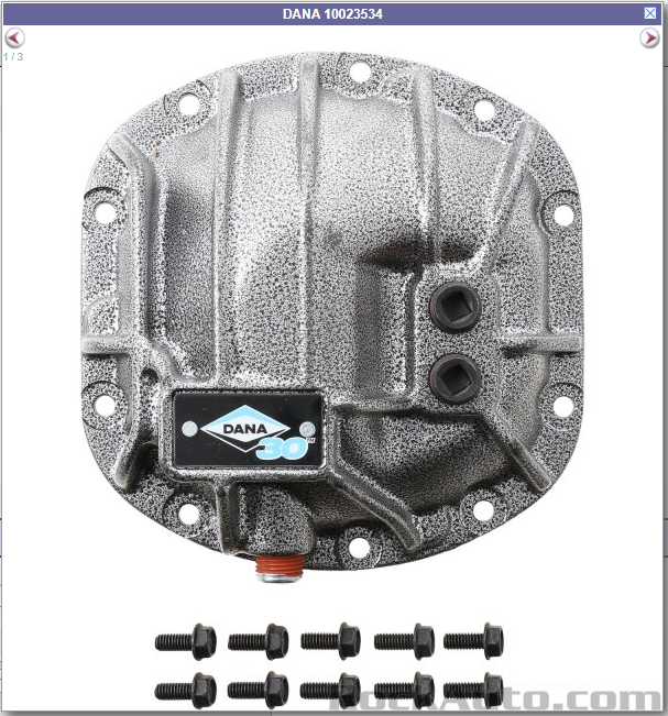

Thanks for the tip. I just bought the Spicer cover from RockAuto - I like to drain and fill holes, and it looks pretty good. It was a toss up between the Yukon and Spicer, as they both look pretty good.
Just by eyeballing it, I think the Spicer may have a bit more clearance for the trackbar though.
More Information for DANA 10023534
https://www.amazon.com/Spicer-10023534-Differential-Cover/dp/B01MF6D03D

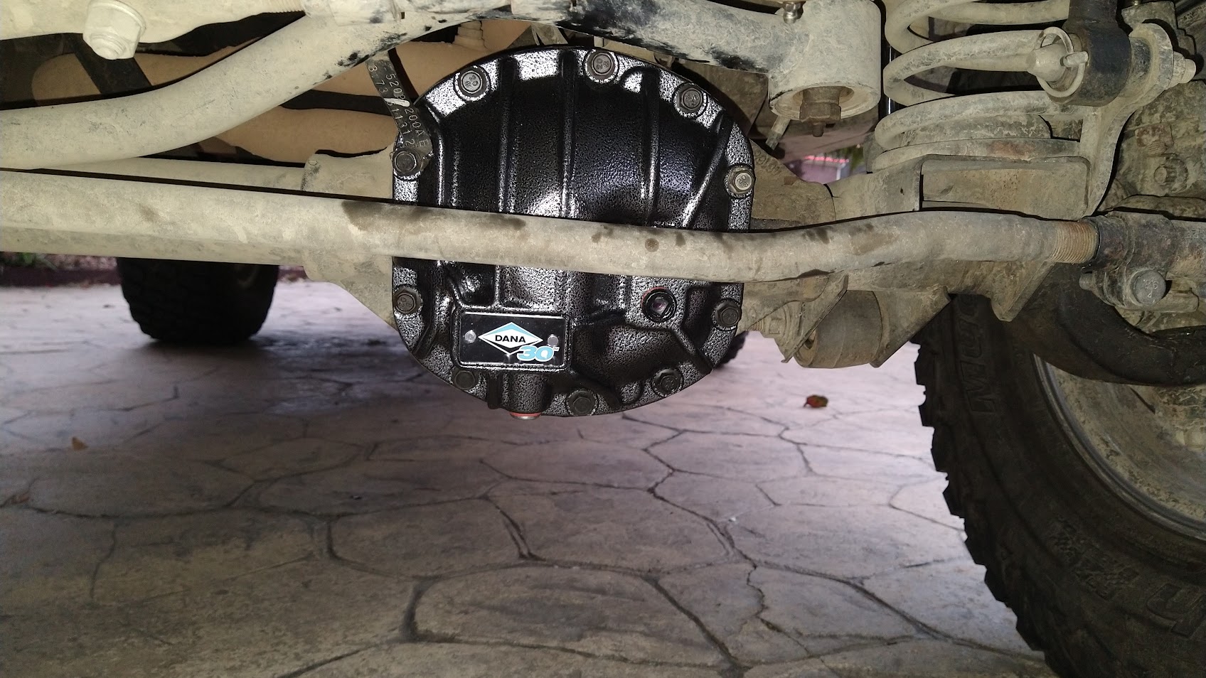

I'm pretty happy with the results.

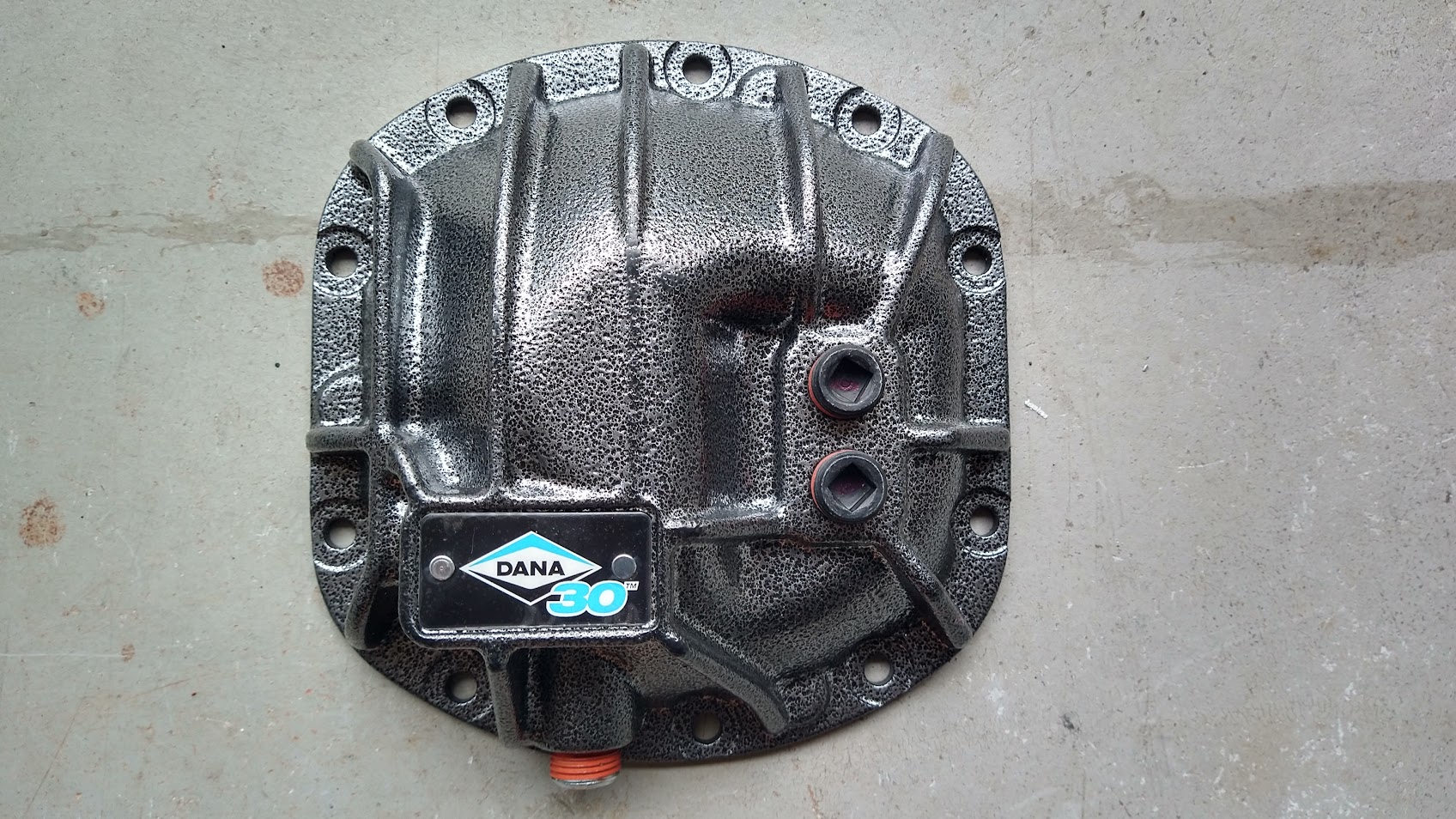

Off with the old
The new cover if beefy and has a plethora of drain / fill plugs
The only fault I can find is that the drain plug hangs a little lower than I'd prefer. We'll see if that ends up being an issue.

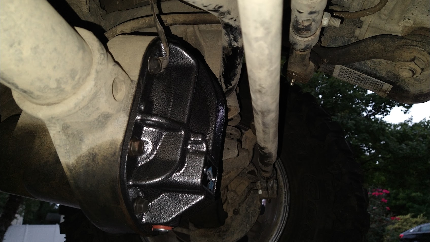

Last pic looks like the track bar might rub @ full flex. I could be wrong. Check it in a controlled setting. Like on a lift. Better to find out now than on the trail.
Drain plug??
Hit it with some paint you clean out later. OR, Just drain like you did last time.
I'm not really sure where the dent in the factory cover came from, or if the new cover would have handled it better.
I think I didn't clean up enough before putting the new one on though - as I have a small leak / drip. I'll need to take the cover off again and clean up before putting it back on.
