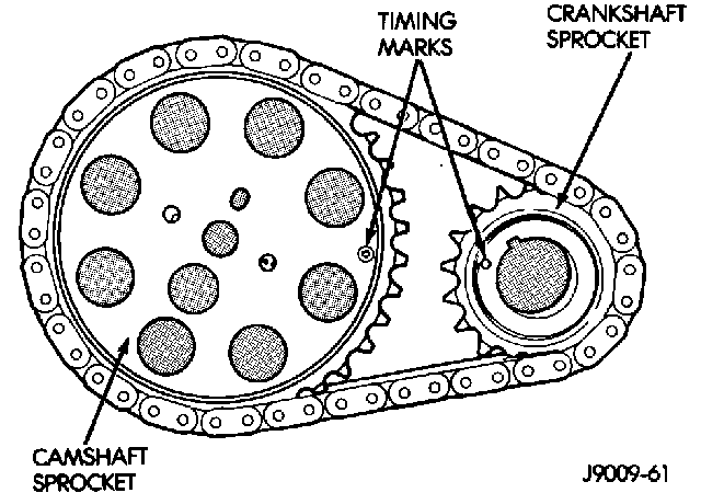

could it be the timing chain or tensioner. I have the valve cover off right now and am a little confused at what I'm seeing. Its supposed to have comp cam kit in it but the lifters and springs look stock. Also the lifters are tight and cant wiggle them at all. There are maybe 2-3 that I can wiggle a very little. all the push rods are tight and cant be spun . is this normal?

I took the timing chain cover off and put cylinder #1 at top of cylinder head. The chain marks on the small and big gear do not line up! Also how much slack should be in the chain. Is there a tensioner on my rig. Could this be my issue? Thanks again you've been a great help
There is no tensioner for the timing chain on a 4.0.
