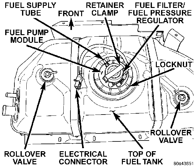

OK gents, played around with it. If I cycle the key 3-4 times (not cranking) on & off, she fires up. Twice isn't enough, but 3 usually gets it. Not something I want to continue to do.Do we still think it's the losing prime at the rail? Is the pump built into the sending unit in the fuel tank? Can you purchse it seperate from the sending unit? Thanks again...
Yes, the regulator is part of the module. heres it's location.

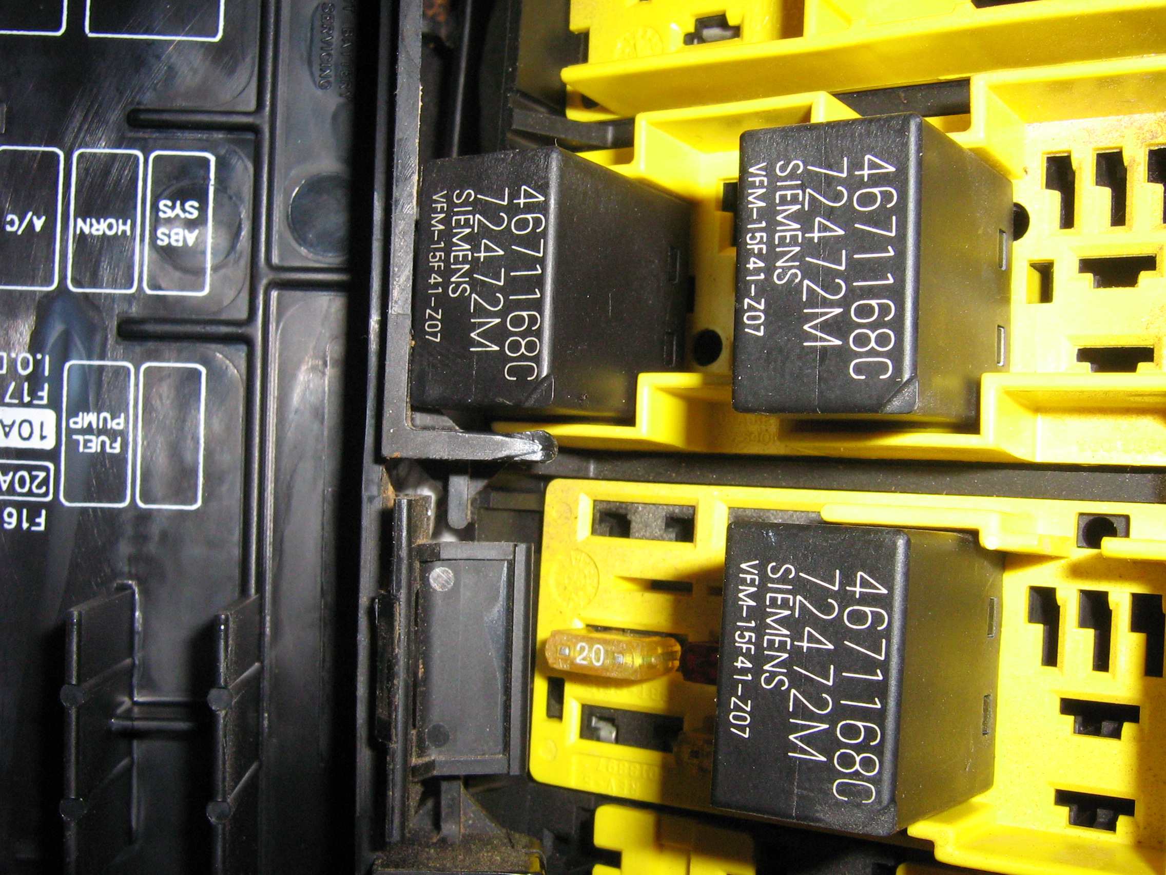

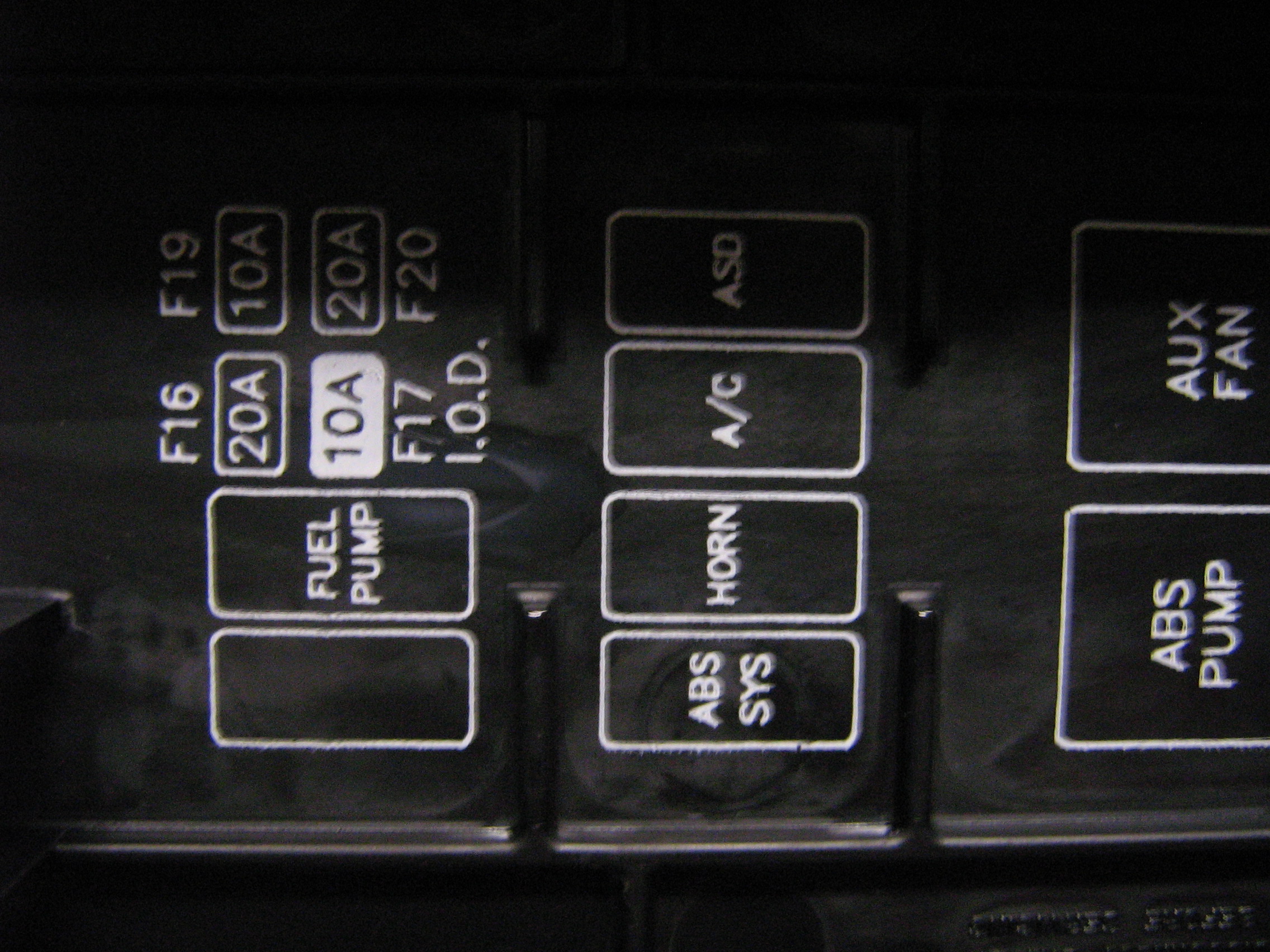

I wonder if the signal to turn on the fuel pump might not be getting through on the first try. The ECM is supposed to turn on a relay (located in the underhood electrical box) and the relay powers up the pump. If I recall, when you turn on the ignition the ECM runs the pump for a few seconds and then shuts it off until it sees the crank cycle. After cranking the ECM keeps the pump on as long as the engine is running. If you look closely at the relays in the electrical box you'll see that several are of the same part number. As a test you could try switching the fuel pump relay with some other one of the SAME part number. Then see if the problem is still there. While you have the relay out look at the male prongs and look into the female sockets - be sure there is no corrosion.
Some info on the pump module... The fuel pump is part of the module. You have a one piece pump, filter, regulator, sending unit device which comes pre-assembled as one convenient, expensive part. I think I've seen aftermarket filters out there but your filter probably won't clog for a long time (I think it's "self cleaning" - i.e. dirt falls off and settles in the tank). For the pump you might be able to find an aftermarket replacement which will require a little rework of the assembly to install - you might try NAPA for that. If your tank skid has been crushed upward the module may have been wrecked since there is almost no clearance between it and the bottom of the tank. Best of luck - John
Swapped fuel pump relay w/ horn relay. Didn't fix it. My problems are never that easy to solve. Gonna try and find a pump/unit thingamagig online. Drop the tank, pop the old one out, drop the new one in and plug up the wiring harness. That easy, wouldn't you think?
