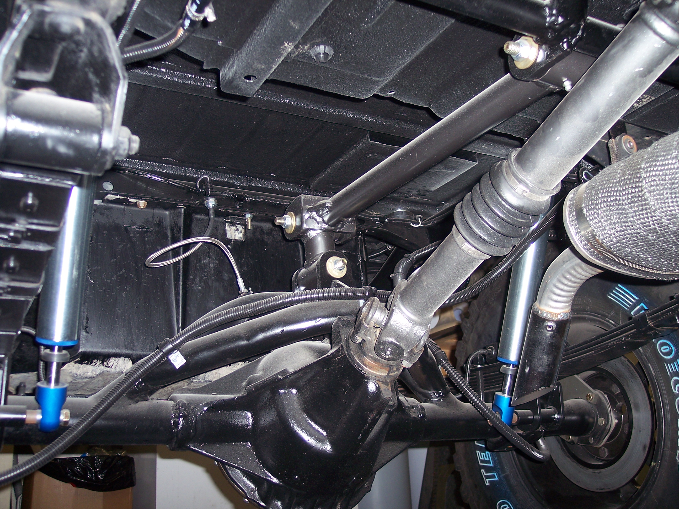

A quick pic of the 20 in my '84 CJ7...

Uh, I just want to know how you keep the underside of your jeep that clean? Living in the rain/snow zone I guess the whole idea of a pretty undercarriage is just a foreign concept.
It hasn't left the garage yet! :D
I bought the Jeep from my brother, brought it home and discovered there was literally nothing salvageable. Did a complete body-off, bumper to bumper. Spent more money than any sane man should. Still not complete, got some fuel injection/electronic ignition bugs to work out and a few other do-dads.

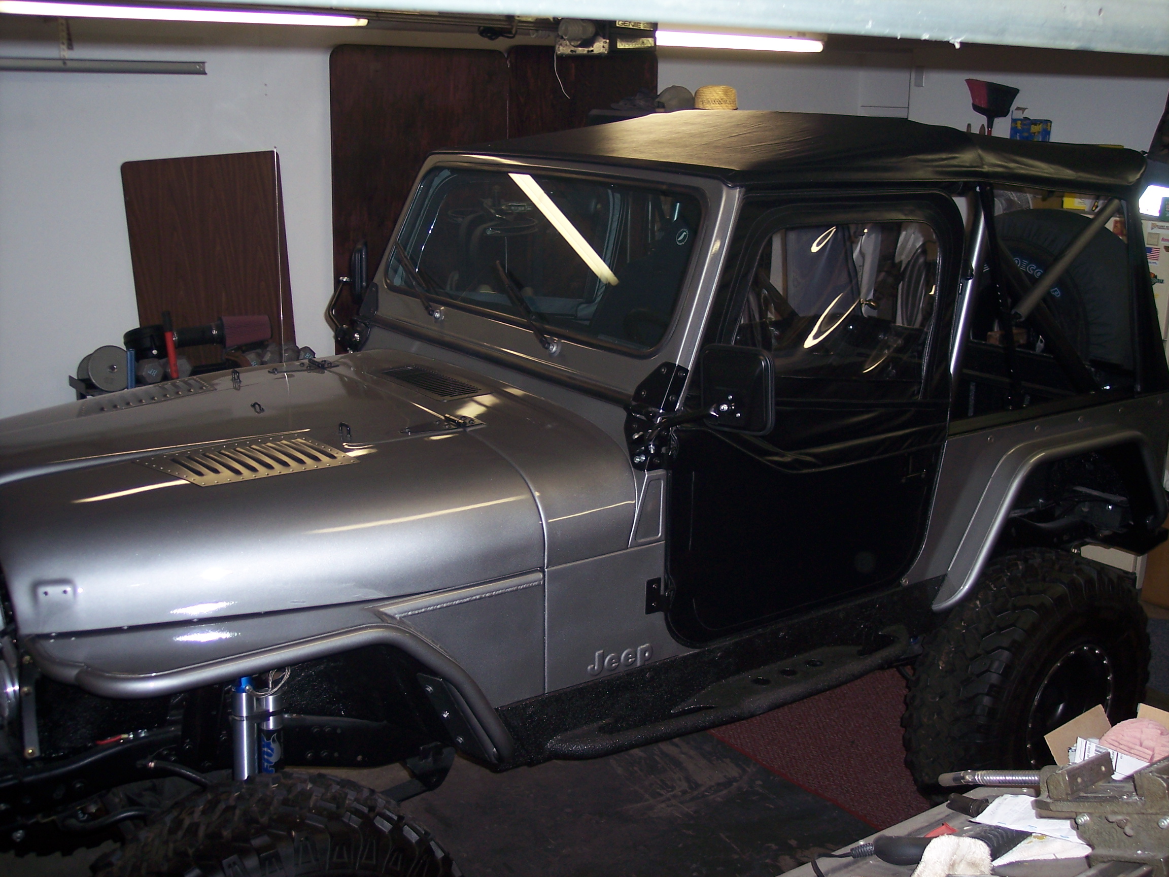

Here's another quick pic I snapped. Not a good one - my garage is air conditioned and I didn't want to open the door! ;)
Looks good!
Air conditioned garage? What's that? (LOL) It was raining here this morning, in fact we have rain forecast for Labor Day weekend. All kidding aside, we do get some heat during the summer.
Was a brisk 107 degrees here today. Lightning and thunder from 0300 to 0500 and little bit of rain. Funny...anything under 65 degrees and we're looking for a sweater!!
