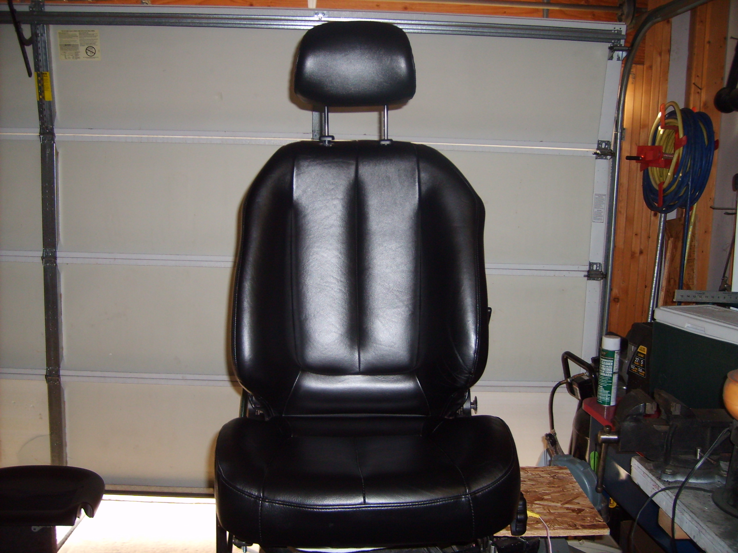

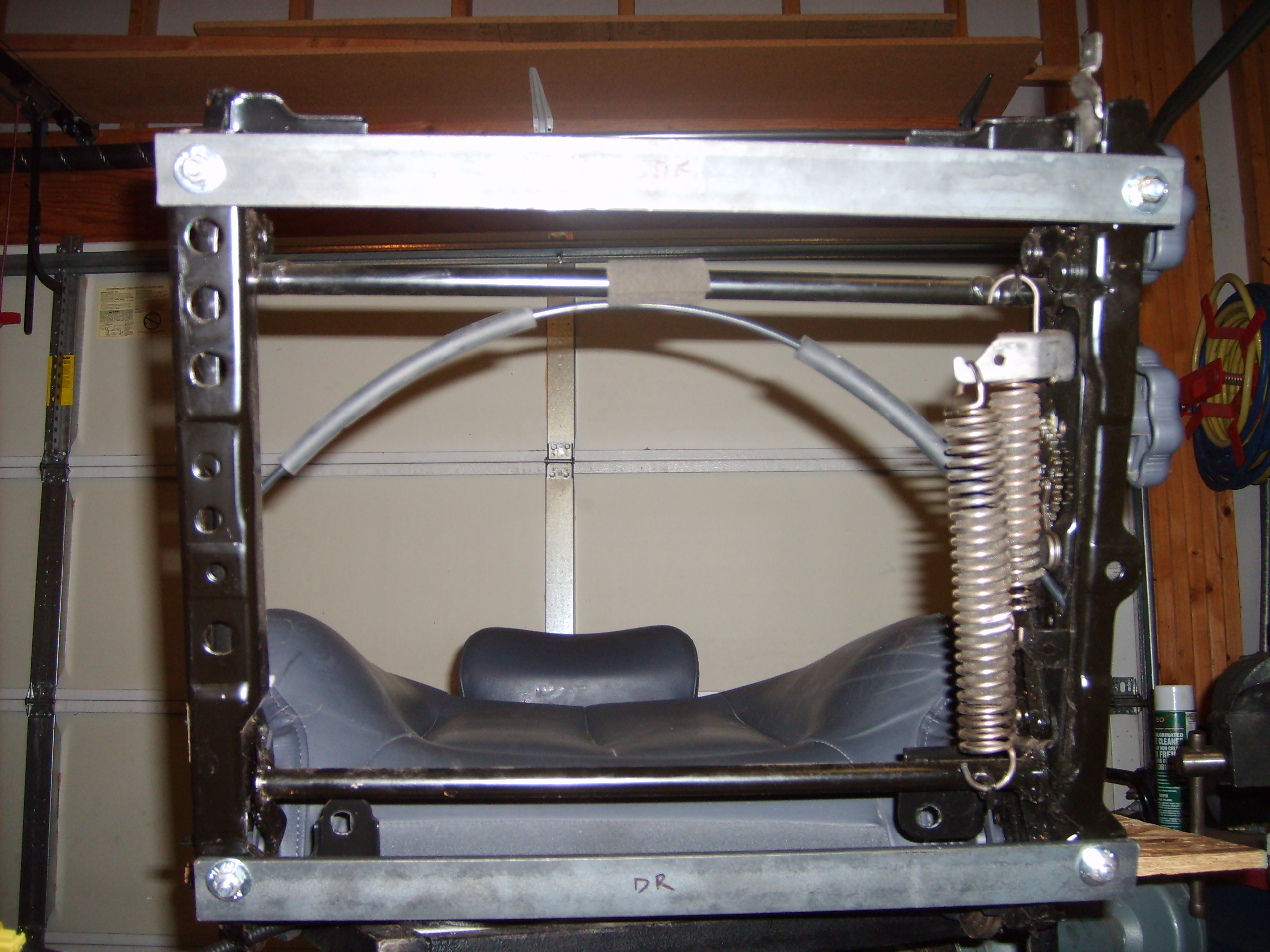

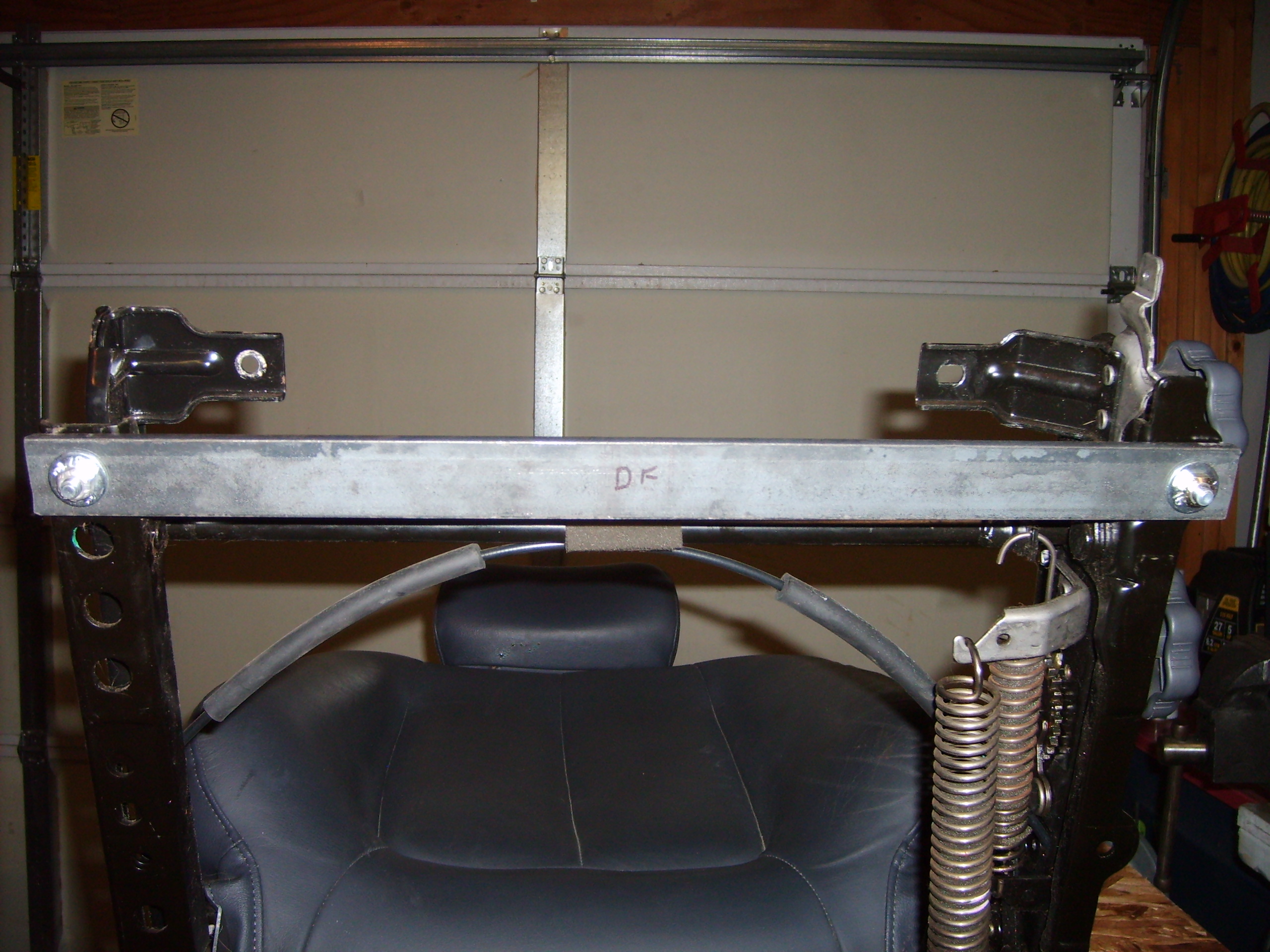

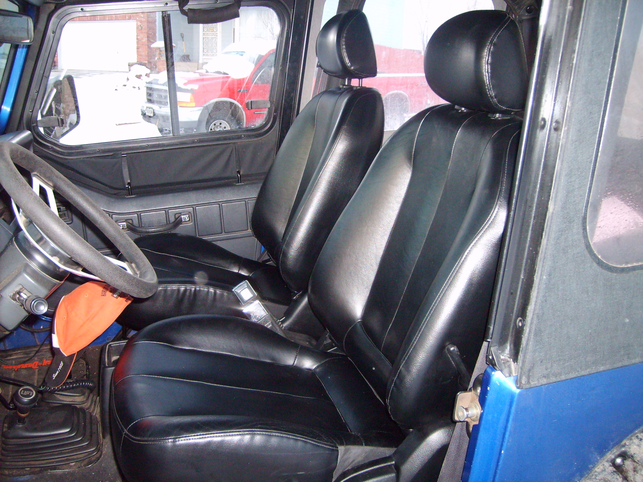

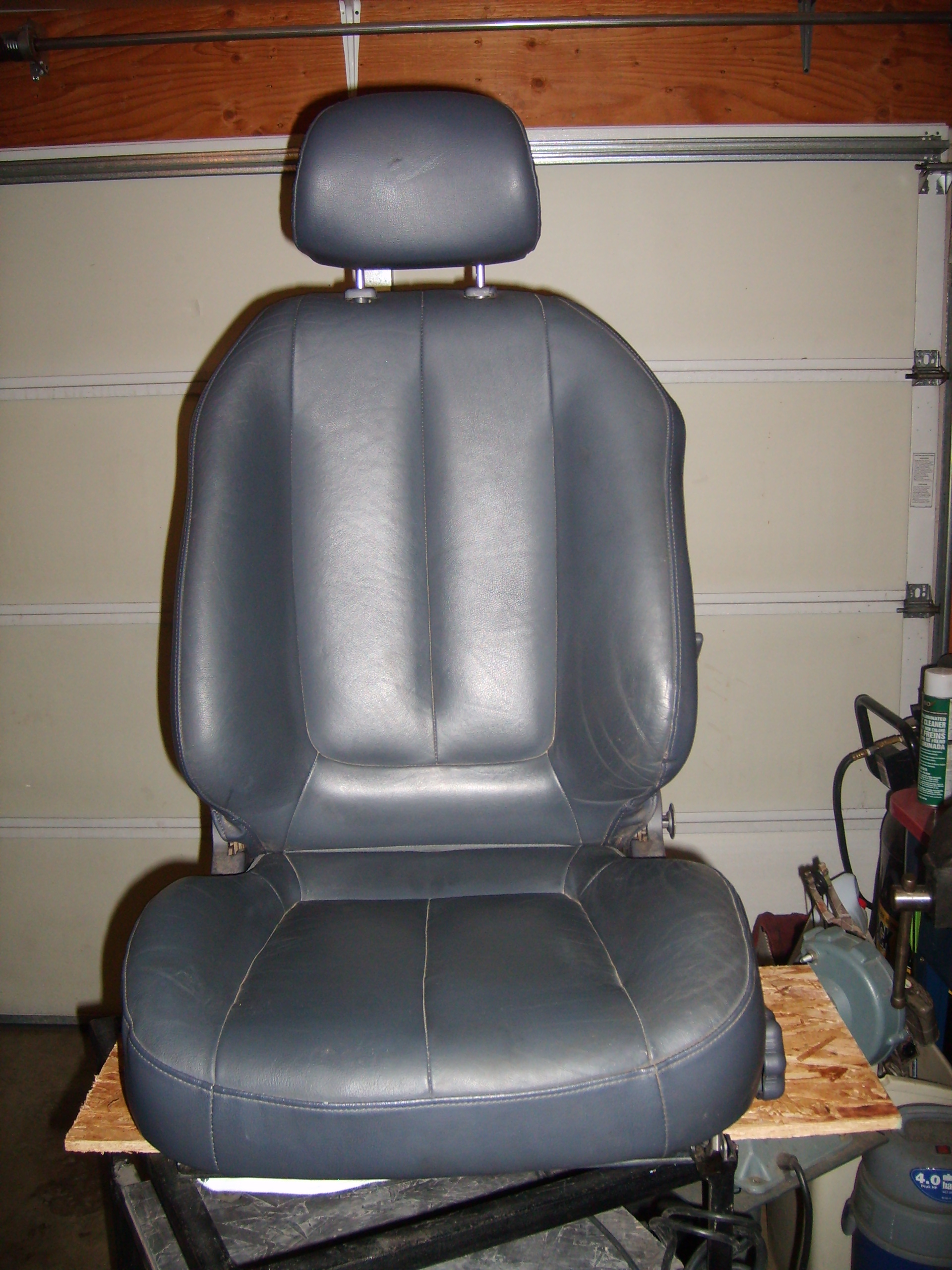

Well after doing a bunch of research decided to go to the local pull and pay for some seats. I got two manual leather seats out of a 2000 Hyundai elantra. They were about the right size. Of course none of the holes lined up so I had to make brackets. I used 4x 18 " pieces of 1.5" by .25". Then drilled holes that matched the Hyundai and then clamped the jeep yj brackets and drilled holes that matched. The color of the seats I got were gray so I bought some black vinal spray paint and painted them black. The only thing is they are about 2" to tall so whenever i find some yj seat brackets I plan to cut them down.
If anyone has any let me know i am in Colorado springs.

Ya I like the way they look and they are like a rap around seat very comfortable. It just needs to cut the fame down about two inches but thanks
