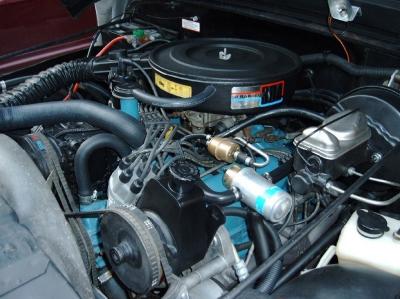

Yeah, they had emissions ports from the exhaust manifold and also a charcoal cannister...whatever that does.
