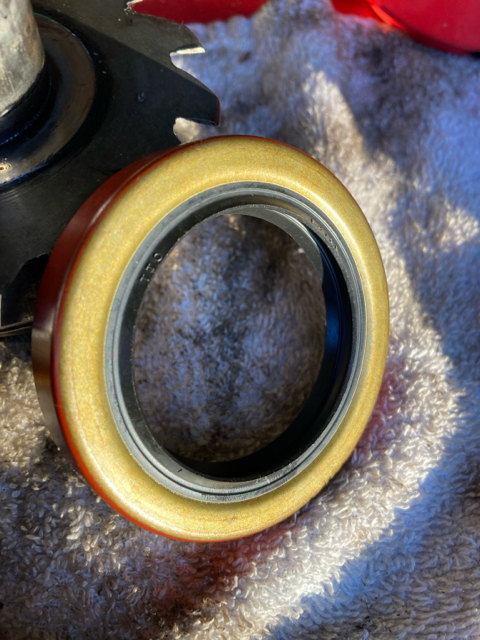

Ok so my rebuild kit for the bearings has the pinion rear seal ok(flanged seal) but I didn’t remove a seal that looks like this
What is it or is it just an extra seal for a diff rear ?
Pic?
I posted it. It came up in my feed.
I’ll try again
I think it’s just an alternate to the flanged outside pinion seal.*

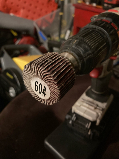

So after ordering a setup bearing for the inside pinion, they finally told me it will 3 weeks (after this one week) for shipping.*
So I decided to make my own.
Took all of 3 mins.
Using a spare new bearing I used a 1.5” 60 grit flapper disc/barrel for cordless drill. ID of bearing is 1.4” so had to muscle the barrel flapper in a bit. But once started it took of all of maybe 45-65 secs of sanding to remove just enough to let that bearing sit nicely on the pinion without more than about 3-5 lbs of force to remove it.
Should have done this long time ago. All the YT vids seem to have them working like hours to get it shaved down. Pffft.
This grit takes the metal off like butter.

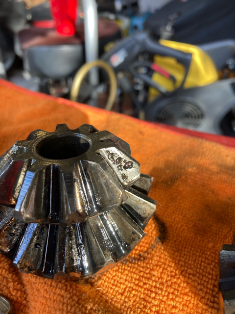

The carrier pin won’t clear the axles to get thru the opposite end gear. I was able to pound it they with a hammer but removed it as I got frustrated getting the thrust washer lined up on the last inch or so.
My question is if this is semi normal (the tight fit) and my concern is if the axles will grind against the pin!?? Or does the pin just turn with the carrier in sync with the axle(or axles) and it’s not a concern ?
I could grind down axle ends or shave a bit off the pin. Doesn’t seem like either is a good solution.
If the pin turns axiay with the axle(s) then it shouldn’t matter if it’s a really tight fight right ???*
To your question on the pin spinning with the carrier and axels.
