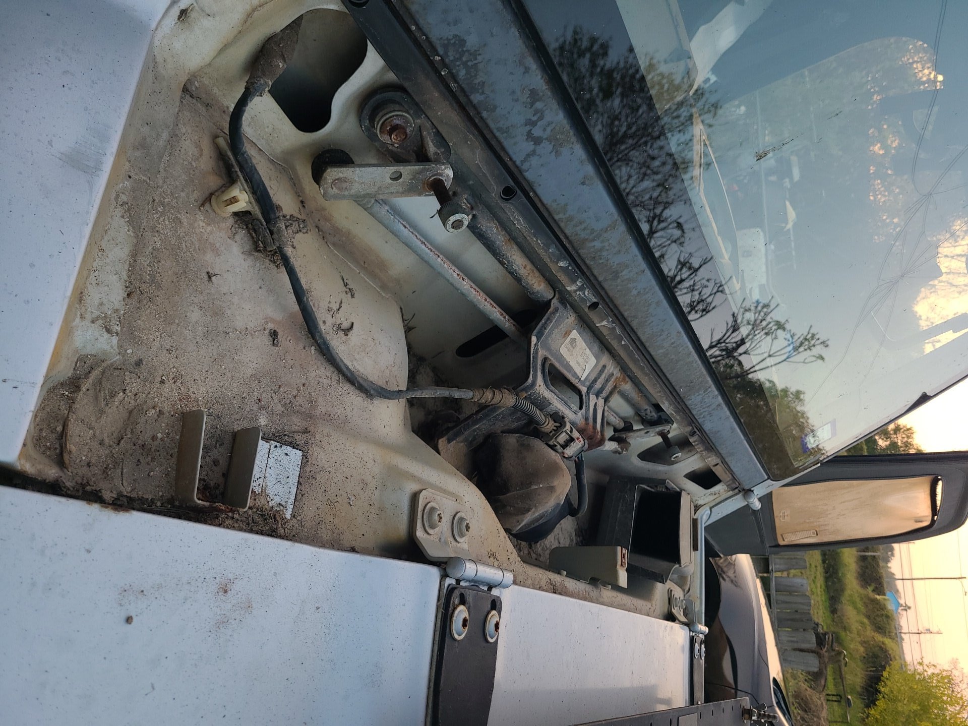

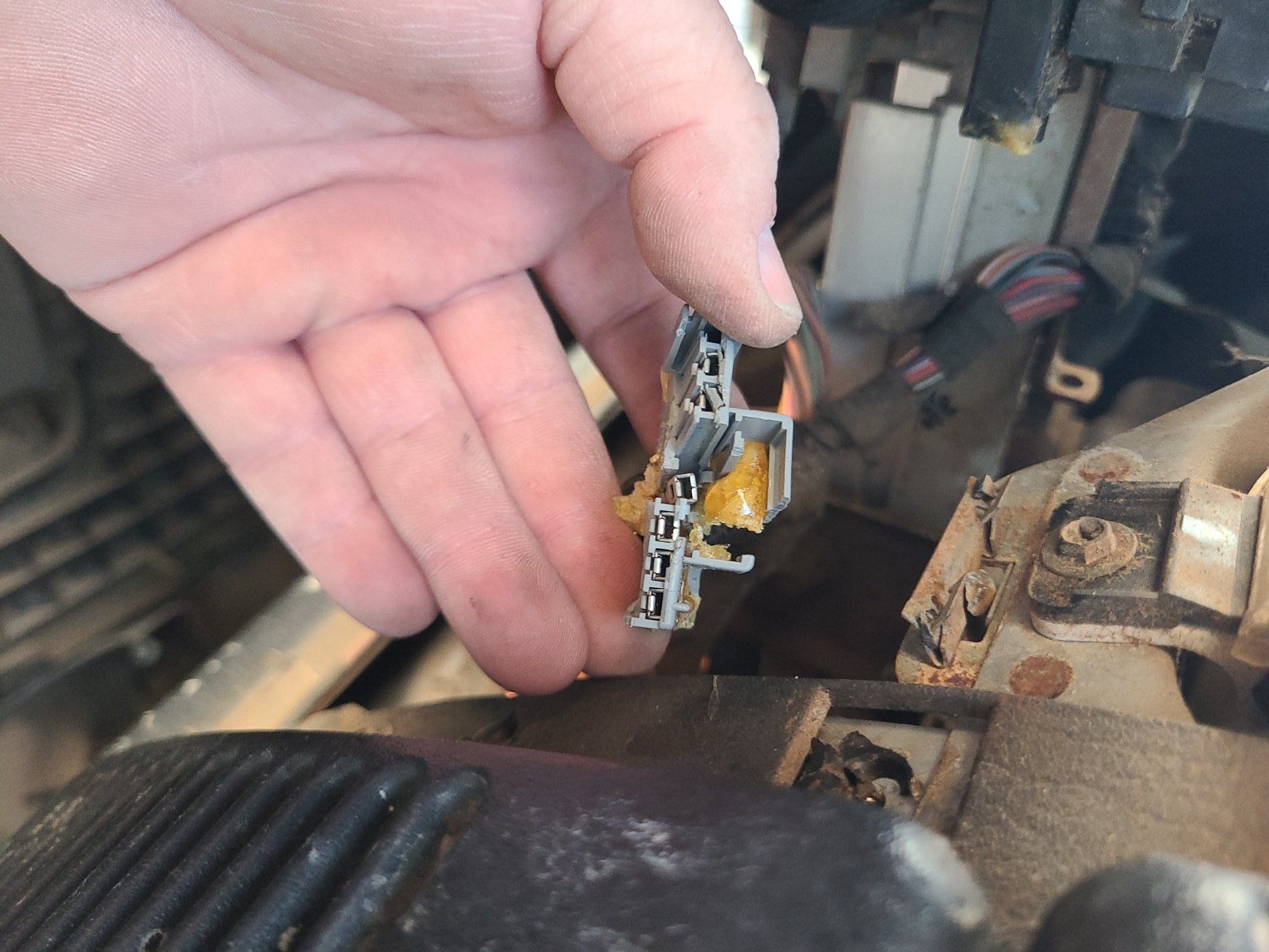

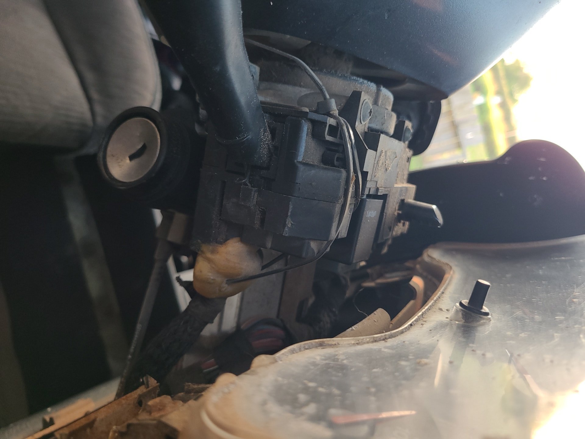

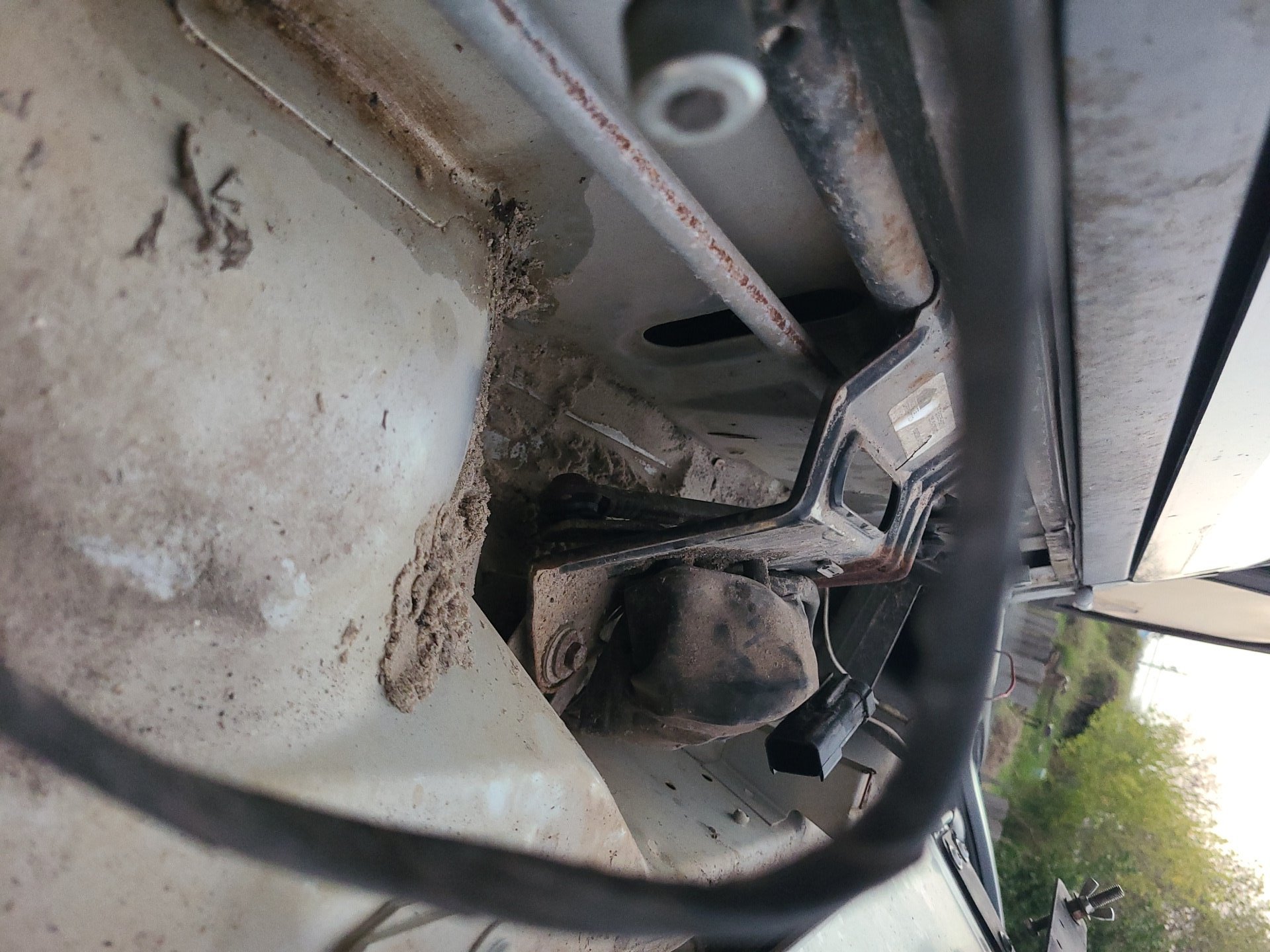

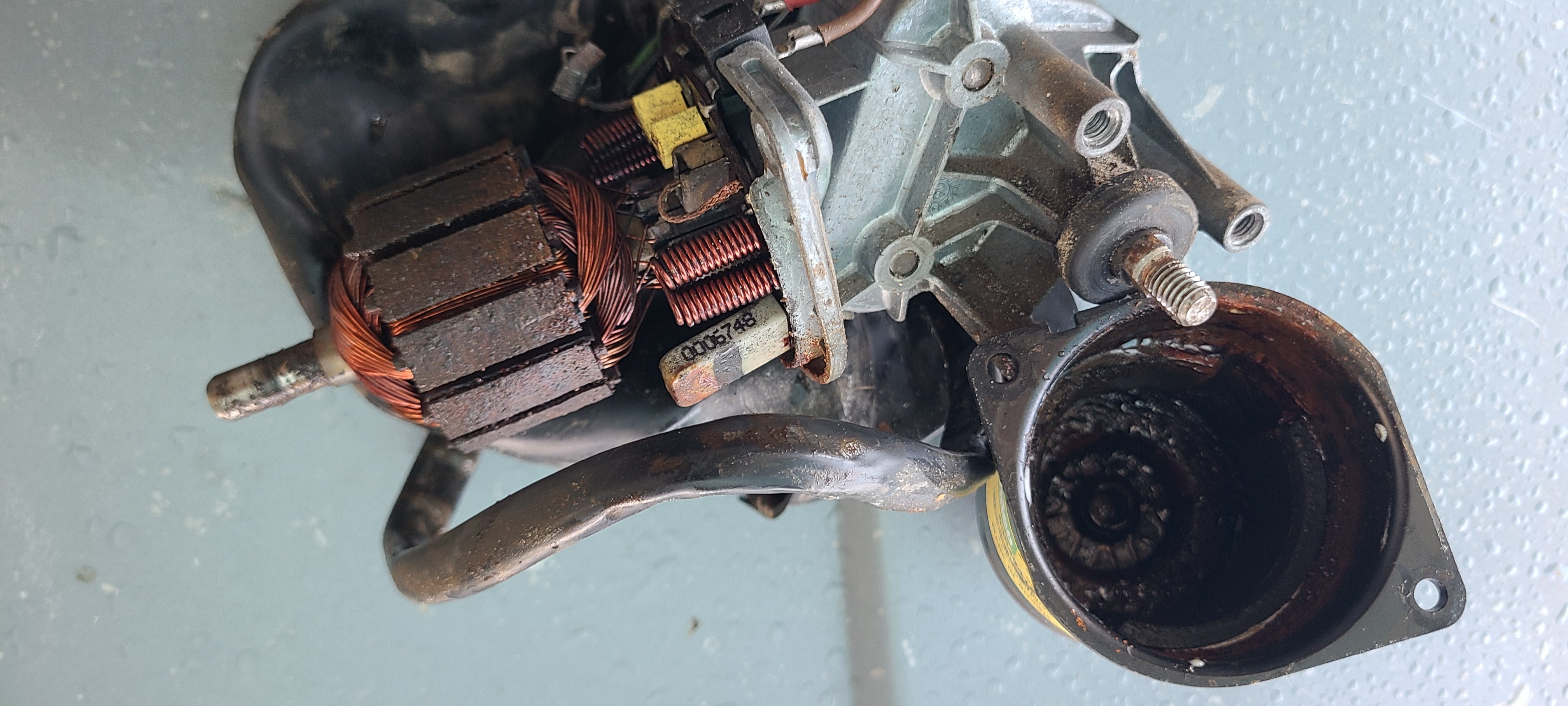

I also tore the rhd tj apart because the wipers didnt work. I found the harness at the switch was broken and foam amd zip tied in and the motor was bad. Also found the reason the motor was bad is the cowl drain was clogged with sand. So i cleaned that area out snd now have to find a new plug to solder in and replace the motor.

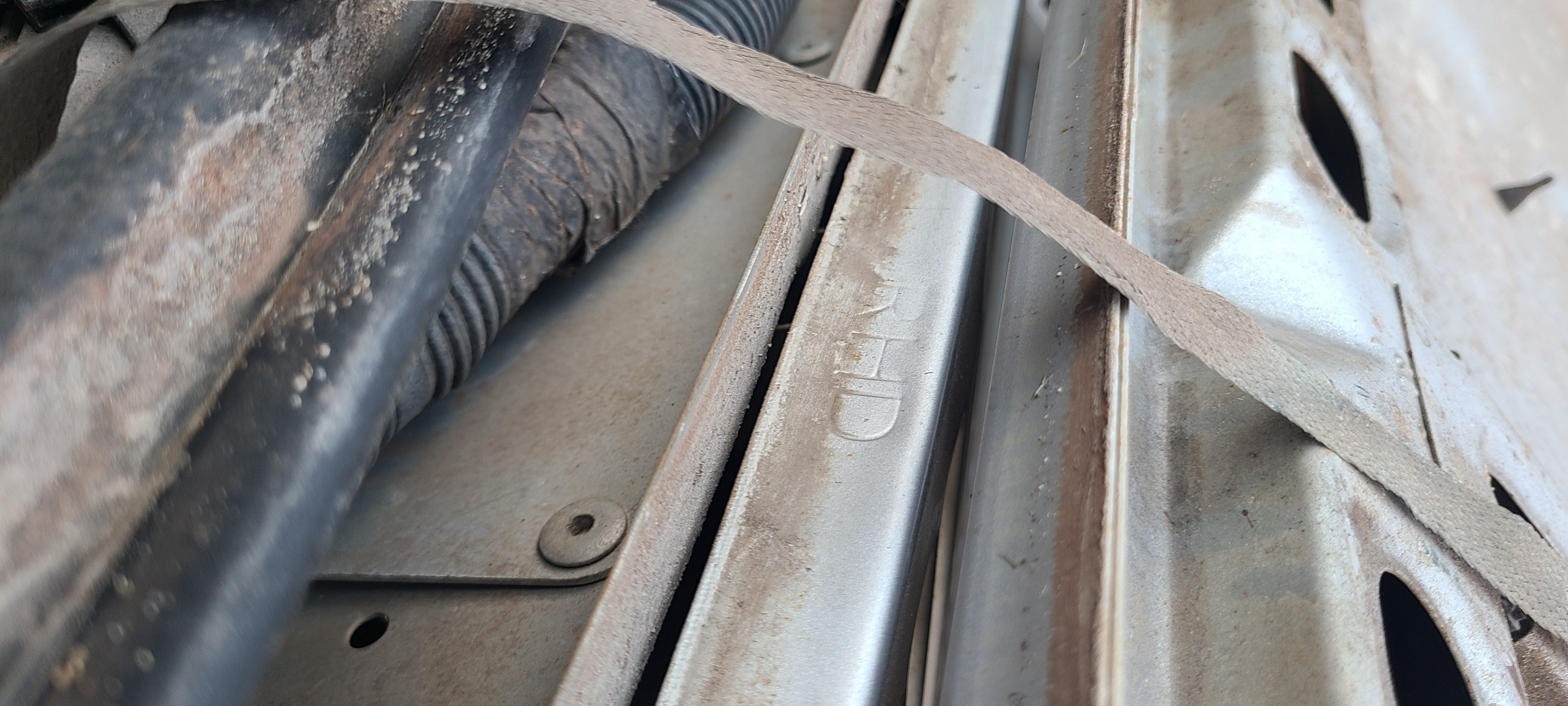

Something funny i found out also is the left hand drive tjs have numbers on the cowl and the rihht have drive just have RHD stamped on it. I compared the tjs i have to find that out.
