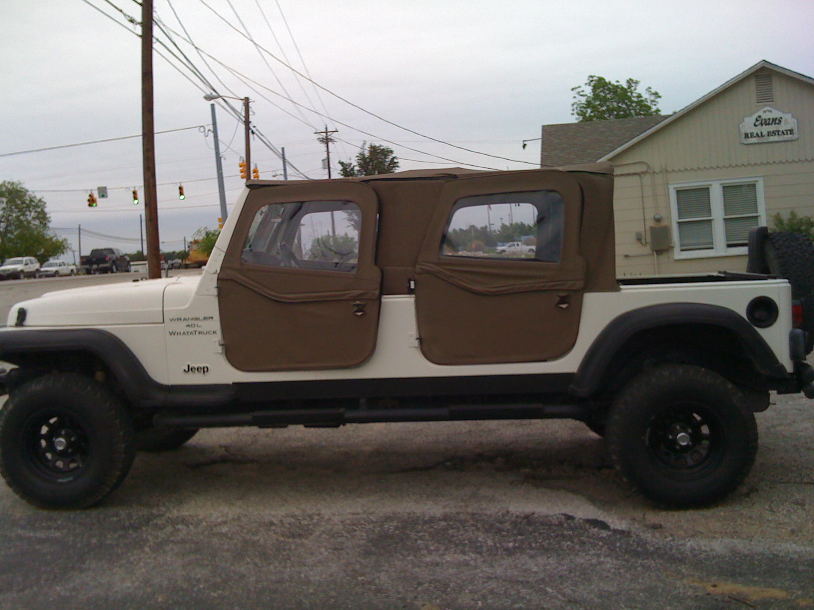

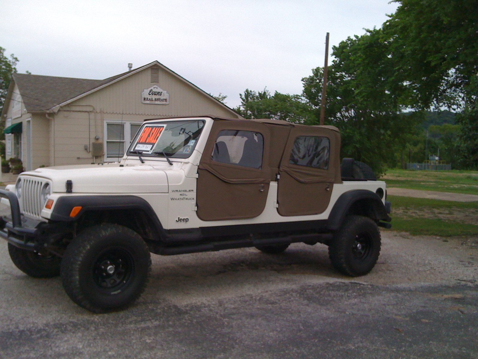

I have seen this swap done before using a YJ body. The person bobbed the backend of the YJ tub right behind the doors to make a truck type cab. he also used a t-bucket truck style bed behind that as it fit directly between the frame rails and didn't interfere with the tires. it was pretty cool he utlized quite a bit of stuff designed for a t-bucket hot rod to build a 4X4. I shoulda took some pics of it but didn't have a camera at the time.
