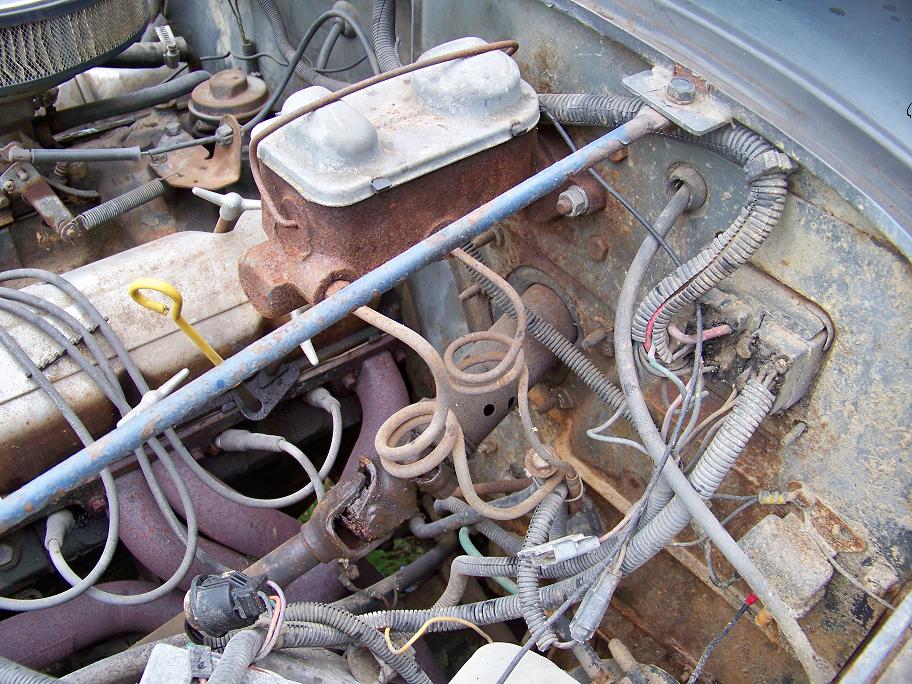

i dont think it has a brake booster....is it like most and be right by the m/c.....there is a little hose coming up from down below...it ends right by m/c with a bolt stuck in the hose....

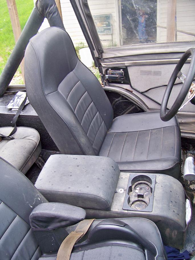

it looks like i have a bunch of room on the wheel well....

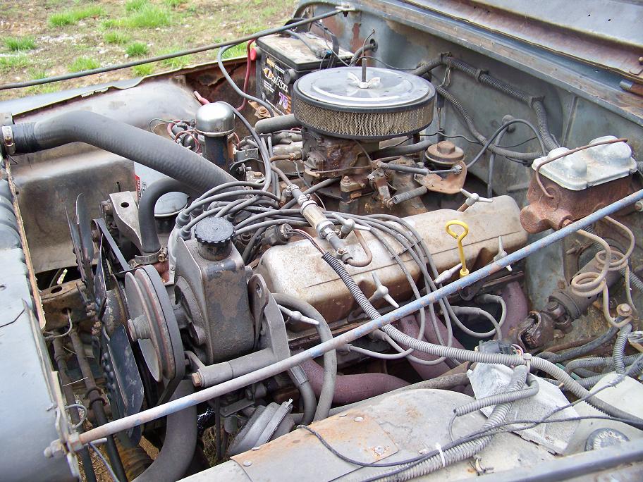

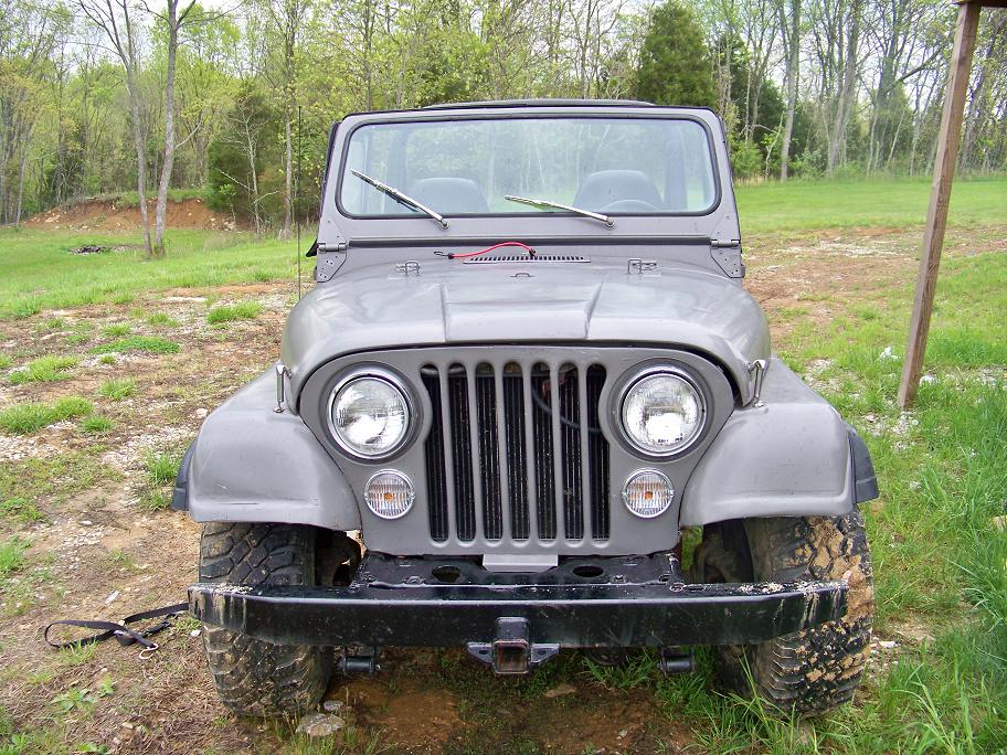

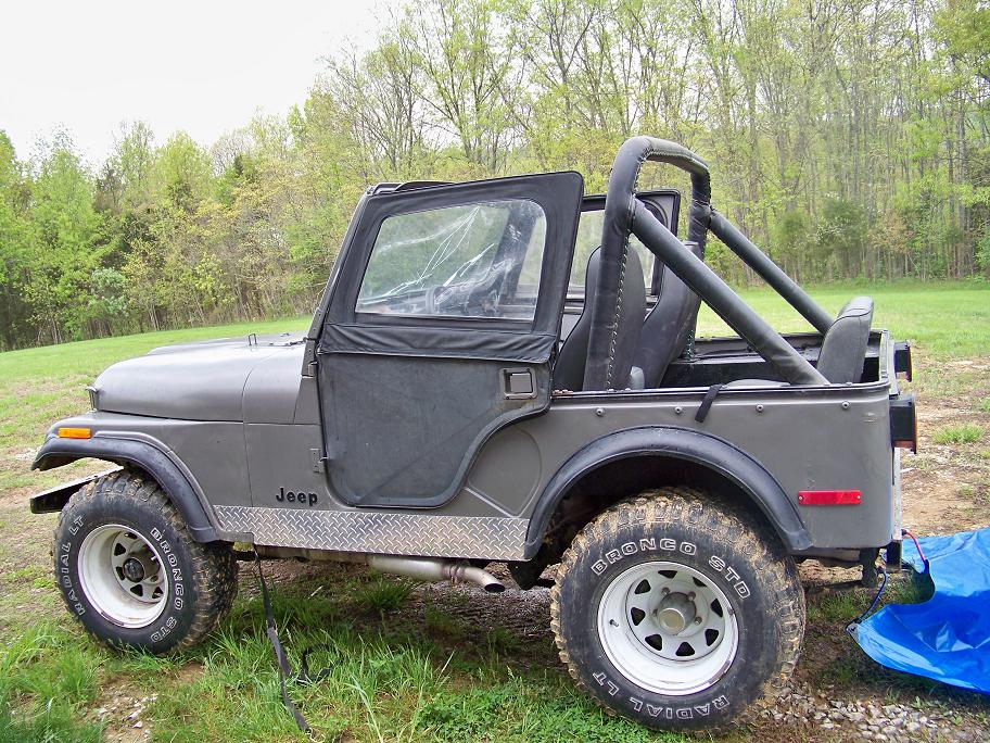

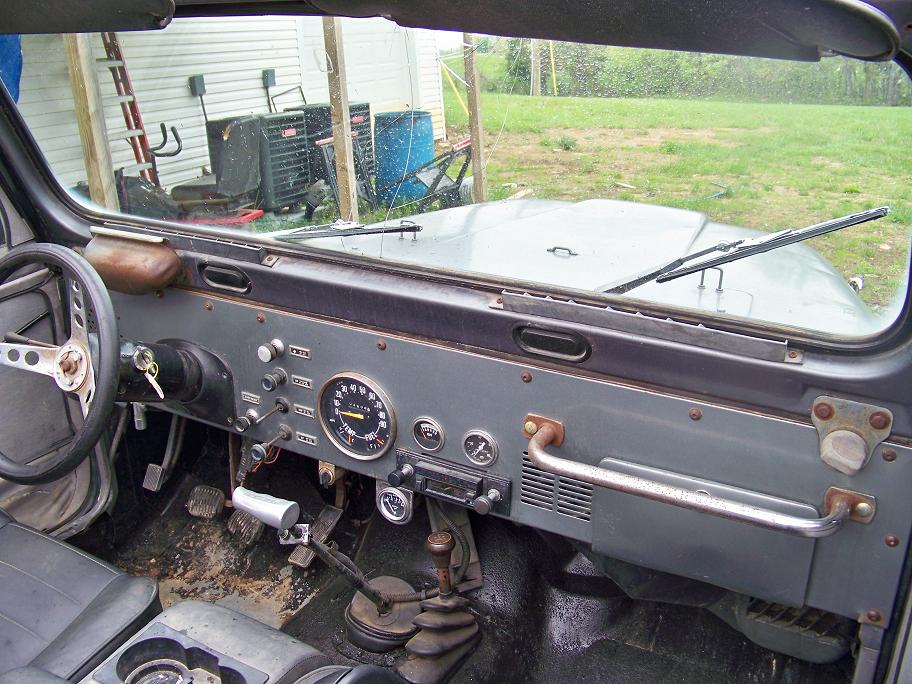

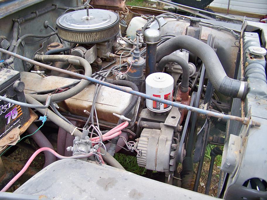

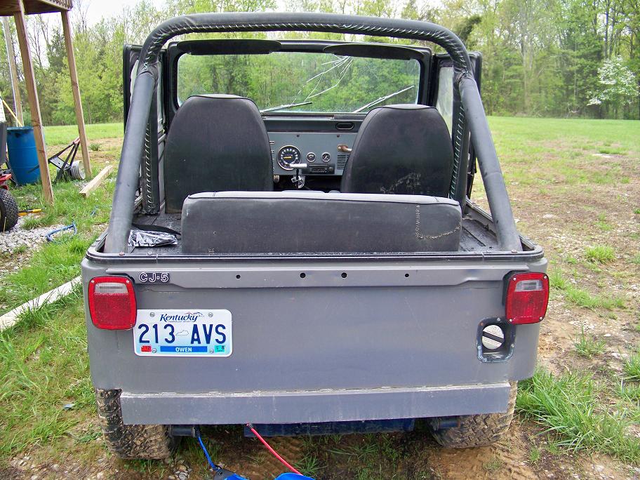

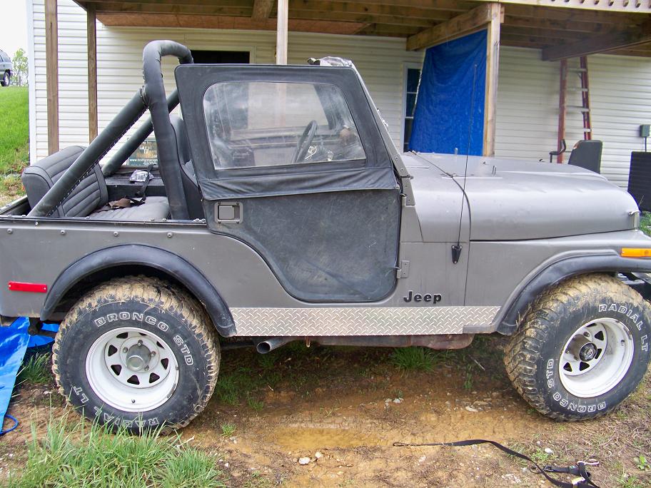

some more pics of my new baby

well, that proved me wrong. Installing a brake booster will definitely help stop the Jeep with ease. If you don't want to go that route, check all four corners of your brakes. Make sure the front calipers are not rusted and binding. I would suspect at this point that the master cylinder OR the brake proportioning valve would cause it to be stiff on the brakes. That's a nice find by the way.
Nice Jeep!! My 78 CJ7 had the same brake setup - No power booster. It stopped just fine. Make sure all of your hydraulics are good. You might have some frozen wheel pistons. A 76 might have drums all around (though, with the 304...). Drums will work fine BUT they need to be working properly to stop without "standing on the pedal". I'd go through the brakes and make sure the linings are not petrified, make sure the drum or disk surfaces are OK, and change the hydraulics if they are at all questionable. Also, check all of the brake lines for bad rust and check the hoses for cracking. Best of luck with your new CJ!! - John
i havent had the chance to look its been rainging here....it feels like only the bad are working or maybe one of the back...it doesnt pull or anything...gonna check in a little bit...thanks guys
All 1976 CJ5s have drum brakes, 1977 & up had disks. Remember that 1976 (and to a lesser extent 1977s too) was the year AMC used up parts from the previous body style so they are a bit of a B.... when it comes to parts.
Someone might have done an upgrade. It looks like you DO have a disc brake master cylinder in there. Should be a good setup after you go through it - John
Out of the box all 1976 CJs had drum brakes so someone must have done an upgrade; it may be the upgrade that's causing the problem. I'm not a brake expert but as I recall the proportioning valve needs to be changed or adjusted with this conversion. I would check that out.

Oops, forgot to mention, a recent article in JP magazine mentioned care/cleaning of the fuse panel, in your pics the motor side looked kinda funky, so if you're having some electrical issues I can paraphrase that article here, if you have a need.
