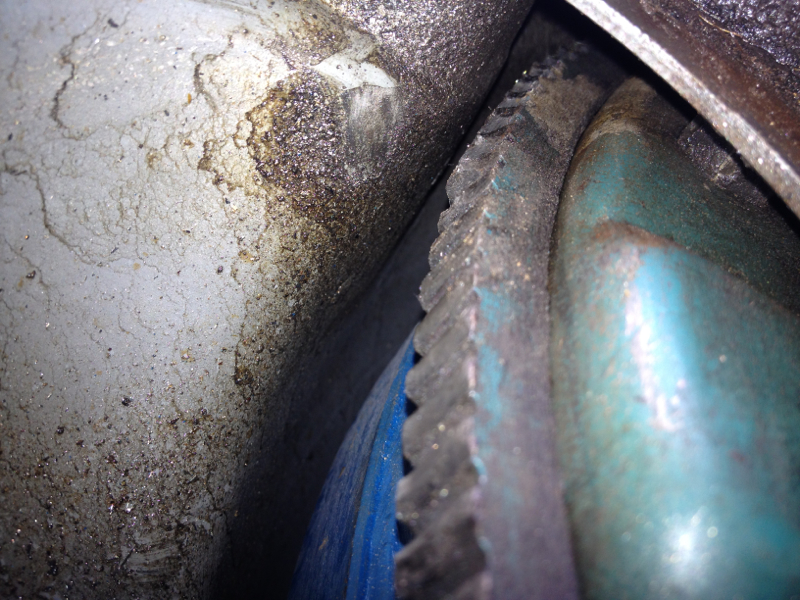

I'm pretty sure I have a similar problem. Got home last night and took the starter off, looked at some of the teeth of the flywheel and there is a spot like you said where the teeth are nonexistent. I took a couple of pictures, it's not pretty. How bad is it to replace this guy? Or am I better off keeping a socket set in the jeep for the times it hits that spot?
These are the missing teeth pics I took. Starter tested out fine, seems like this is my problem.

That'll do it.. Time to remove the trans and x-fer case. Fun fun fun...
that looks pretty bad. Mine was just a few teeth. That would require taking out the trans, tcase, clutch, bellhousing, or just pull the engine to replace the flywheel. Changing the flywheel itself is the easy part, its getting to it.
Whoa dude ! No way to red neck that ! A file couldn't do any justice there . Sorry you'll be bench pressing a t-case and trans , just kidding , I know a floor jack or lift will be employed. Best of luck , greg
Thanks for everyone's help, I really do appreciate it. For now, I'm just keeping a socket in the jeep for the times the starter can't grab and turn the engine. Sucks, but gotta do something when I need to drive the jeep. Will most likely post when I'm going to do this repair! Until then, my friends.
