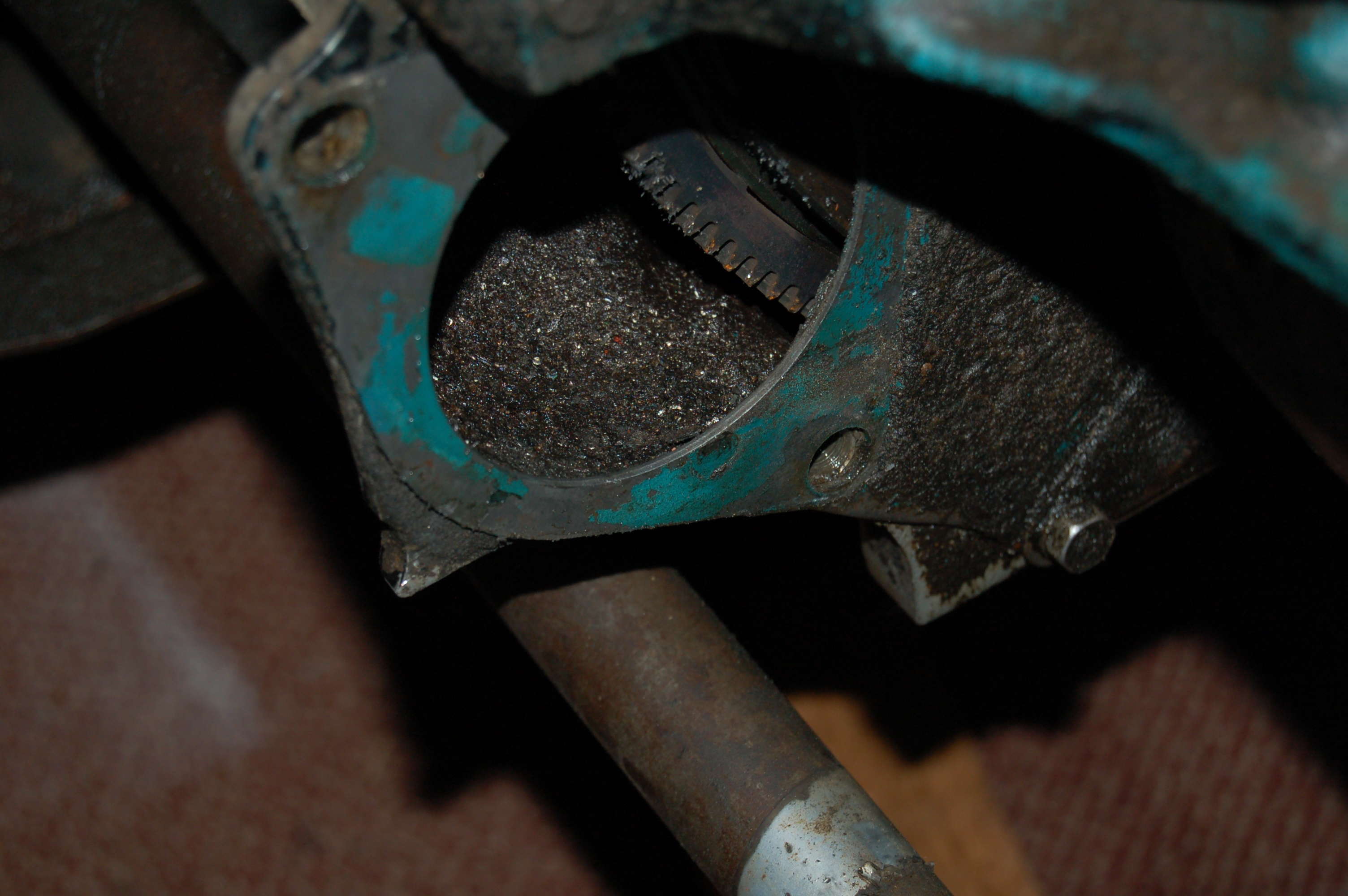

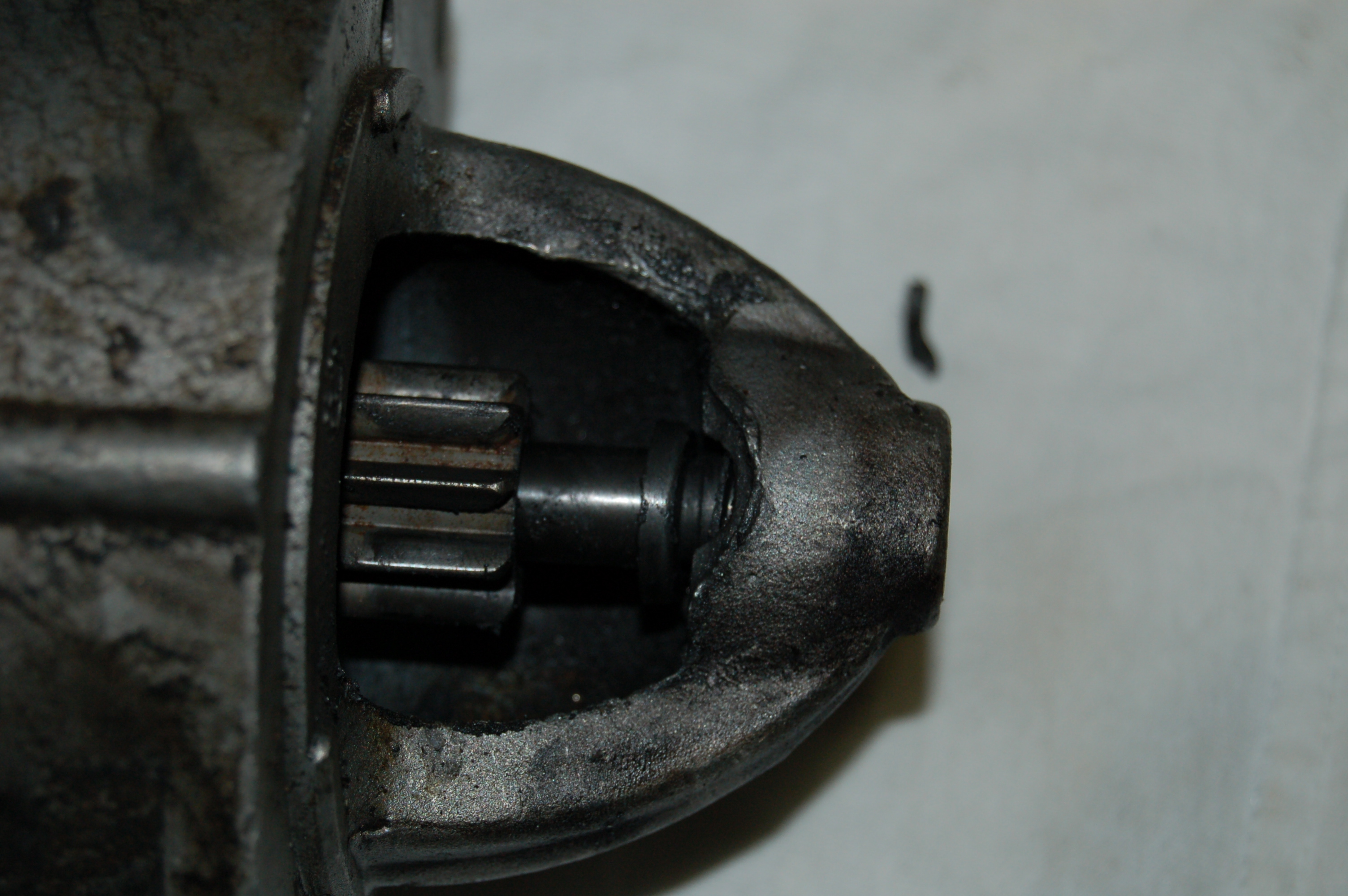

Took the starter off ... seemed like it was stuck but I got it off. The bushing/washer on the shaft (on the end farthest away from the starter motor) looks like it's missing some metal. The small piece of metal next to the end of the starter was inside the engine housing. Is the end of the starter housing broken too? Also, after removal, I can see there are metal shavings inside the engine housing. There was another one too. The teeth on the main gear visible through the hole where the starter was look fine. I guess I need a new starter?

Yes. That starter is no good.. Try to turn the flywheel with a screw driver and see if it moves.

^^^^ Agree, or put a socket on the crank pully nut and try to spin the motor that way. If it spins, get a new starter and I think you will be good to go. The metal shavings you seen are probably from the starter getting chewed up.
Verified at auto parts store yesterday evening that the old starter was bad. Will pick up new starter sometime today (the one they had in stock was broken too; they're getting one from another store) but first, I'll pull all the plugs and see if I can get the engine to turn. I want to find out if the engine seized and broke the starter or if it's just a starter problem.
