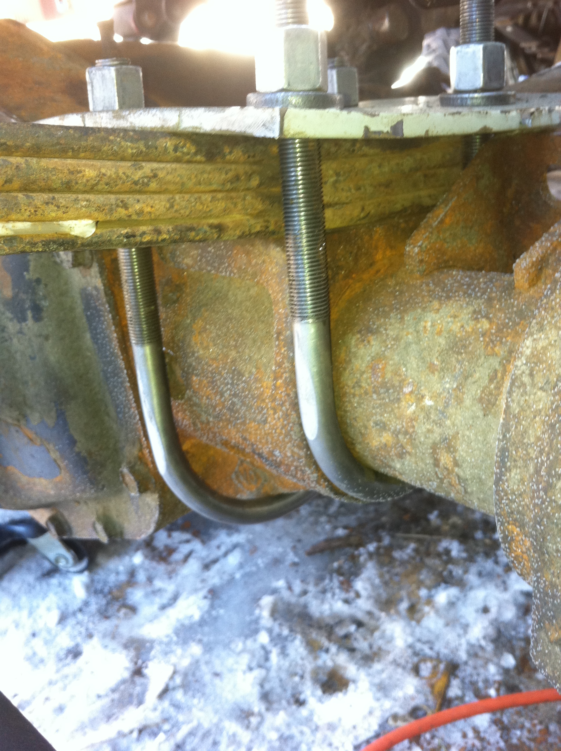

Ok has anybody used leaf springs wen swaping a 86-88 or so d60 front axle? i was told once i out board the leafs at the frame i can bolt the axle right in. Here is a pic of the problem, the u-bolt is sitting on the diff webbing. also i dont wanna hear it about the u-bolt plate so heres a pic of the ones im usein VERY THICK just didnt have them wen i was ready to drop the front:-) got them from TMR customs somewhat local (4 me) good guys! They dont have the plates on there site yet but the said soon they got lots of stuff!!!! I asked them about the u-bolt problem and they even brought me in the back 2 look at the d60s there linking and puttin in a tj but completly different axle and they have never kept the leafs in there rigs.

I found out others have just drilled a hole through the web, I wasnt shure if this would b ok but if its bin done b4 nd there happy with it, I probly wont have any issuse.
either drill a hole or you can cut some grooves so the u-bolt sits fairly flush with the center casting.

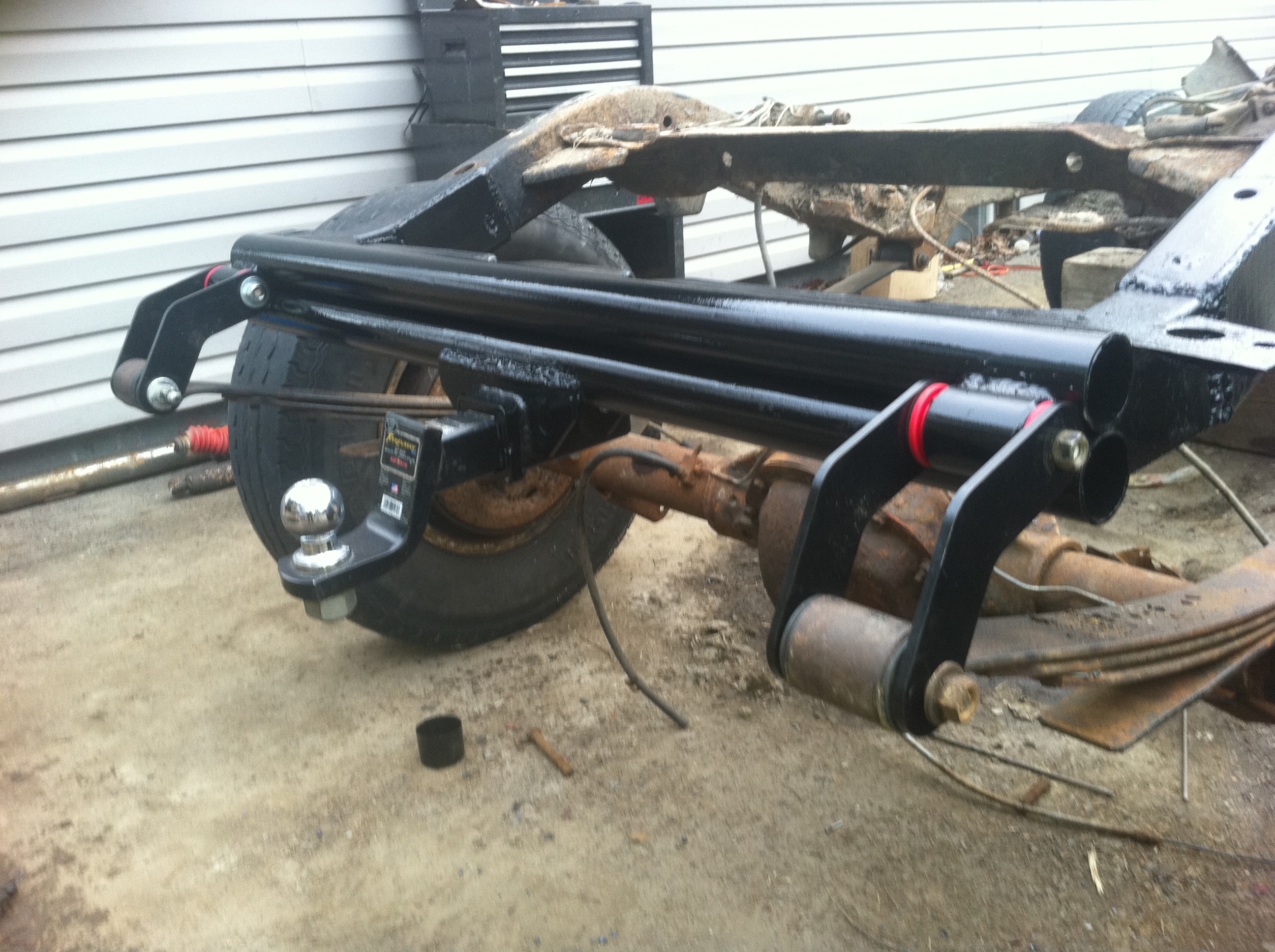

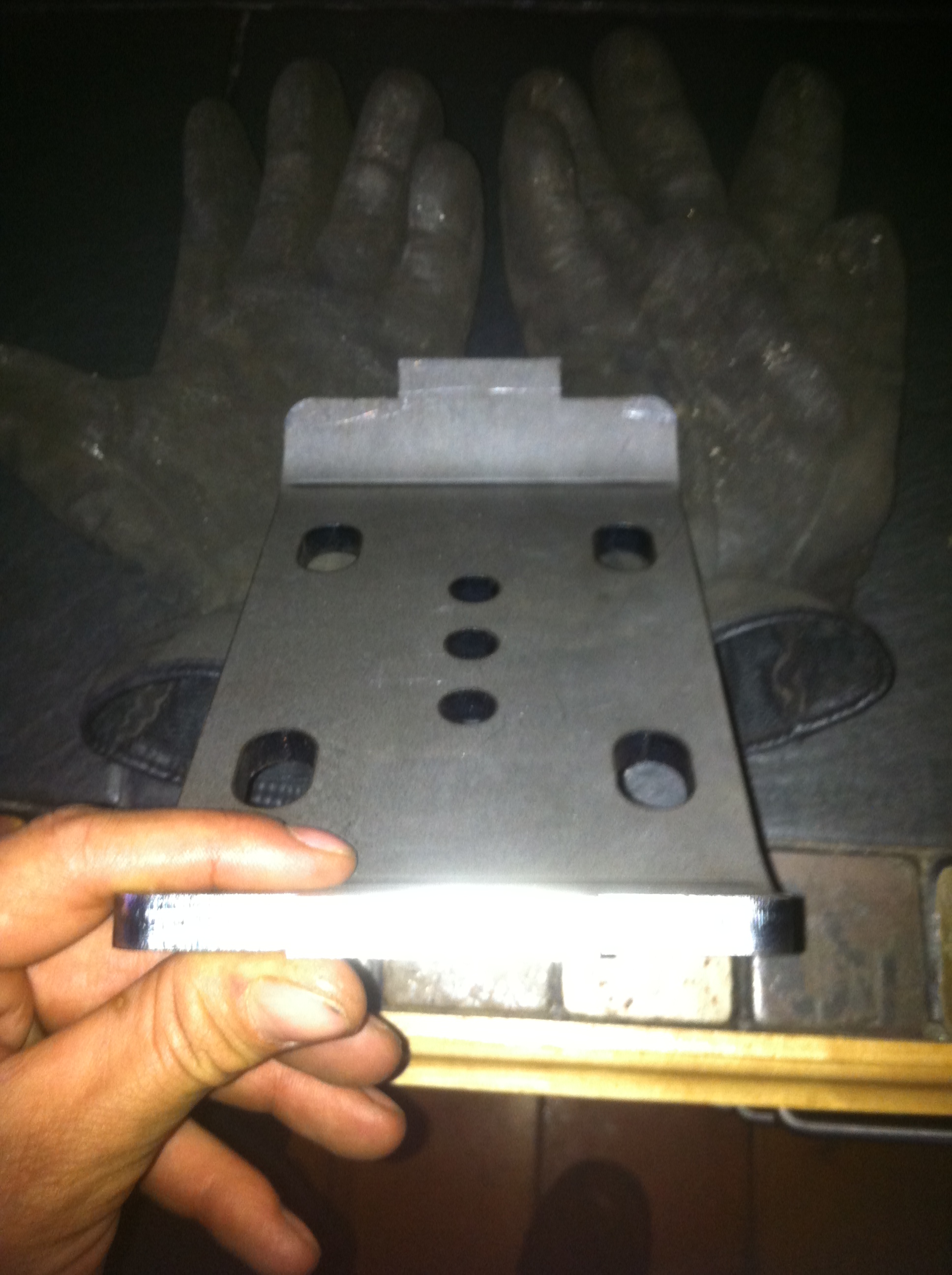

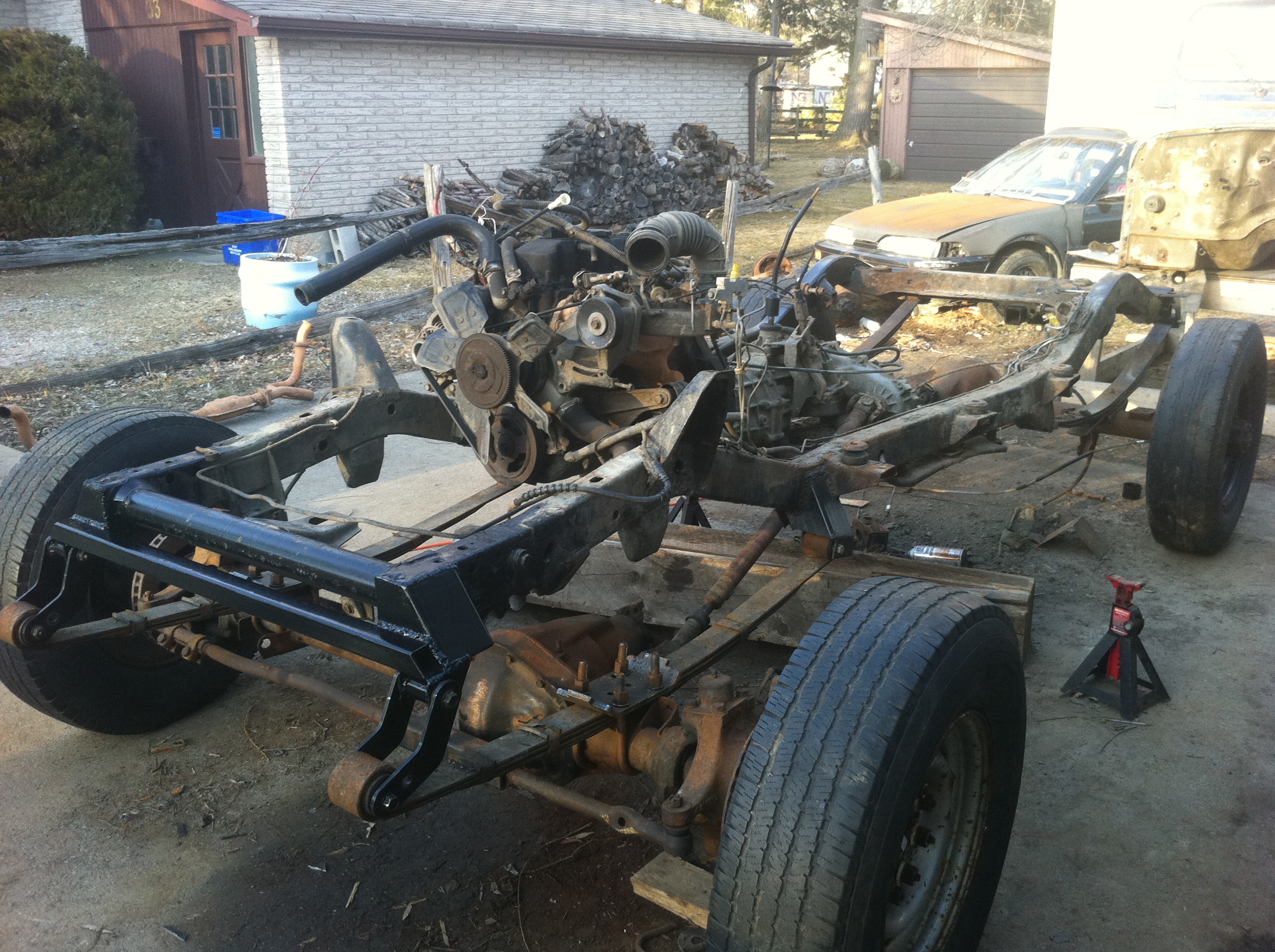

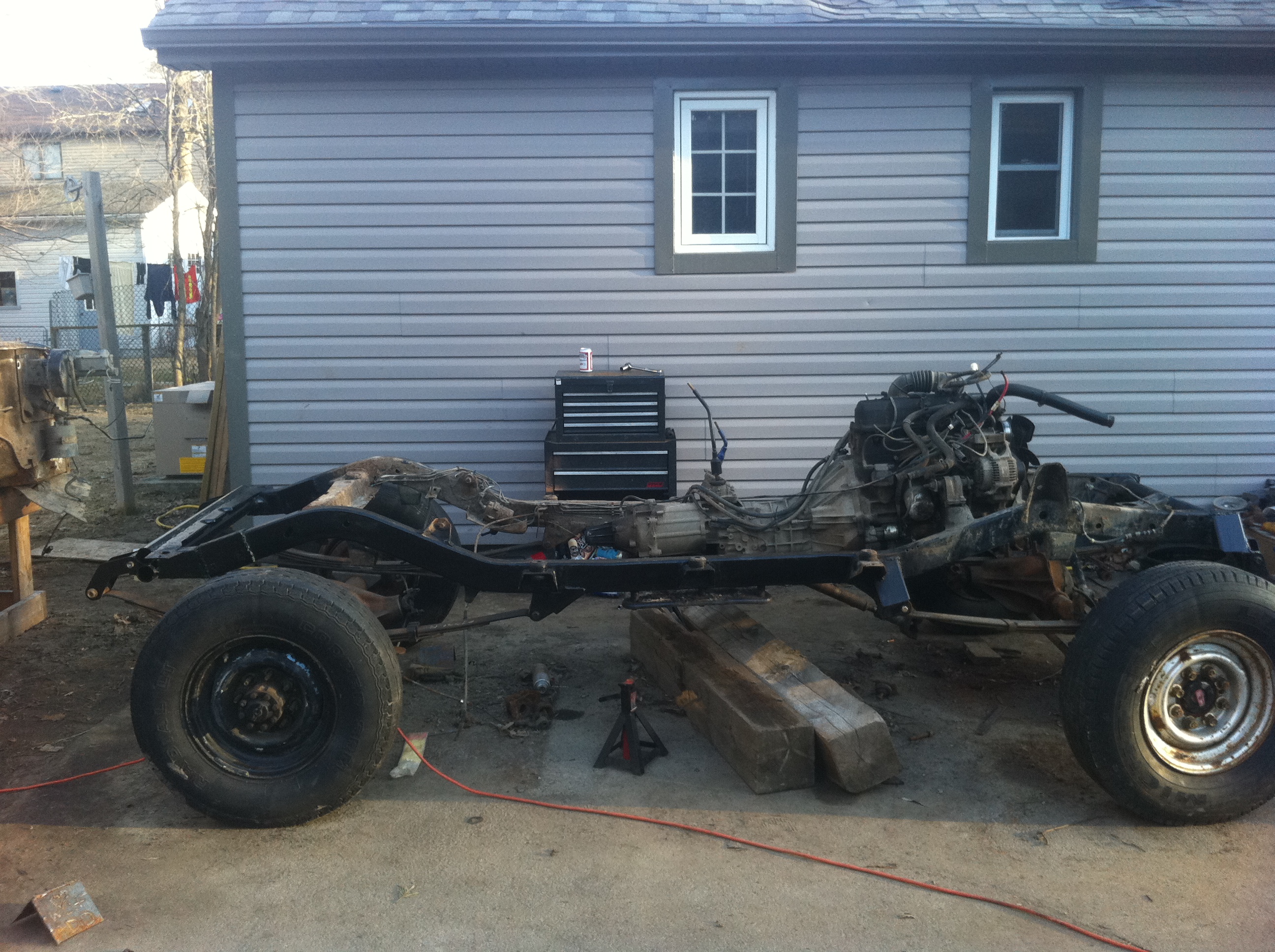

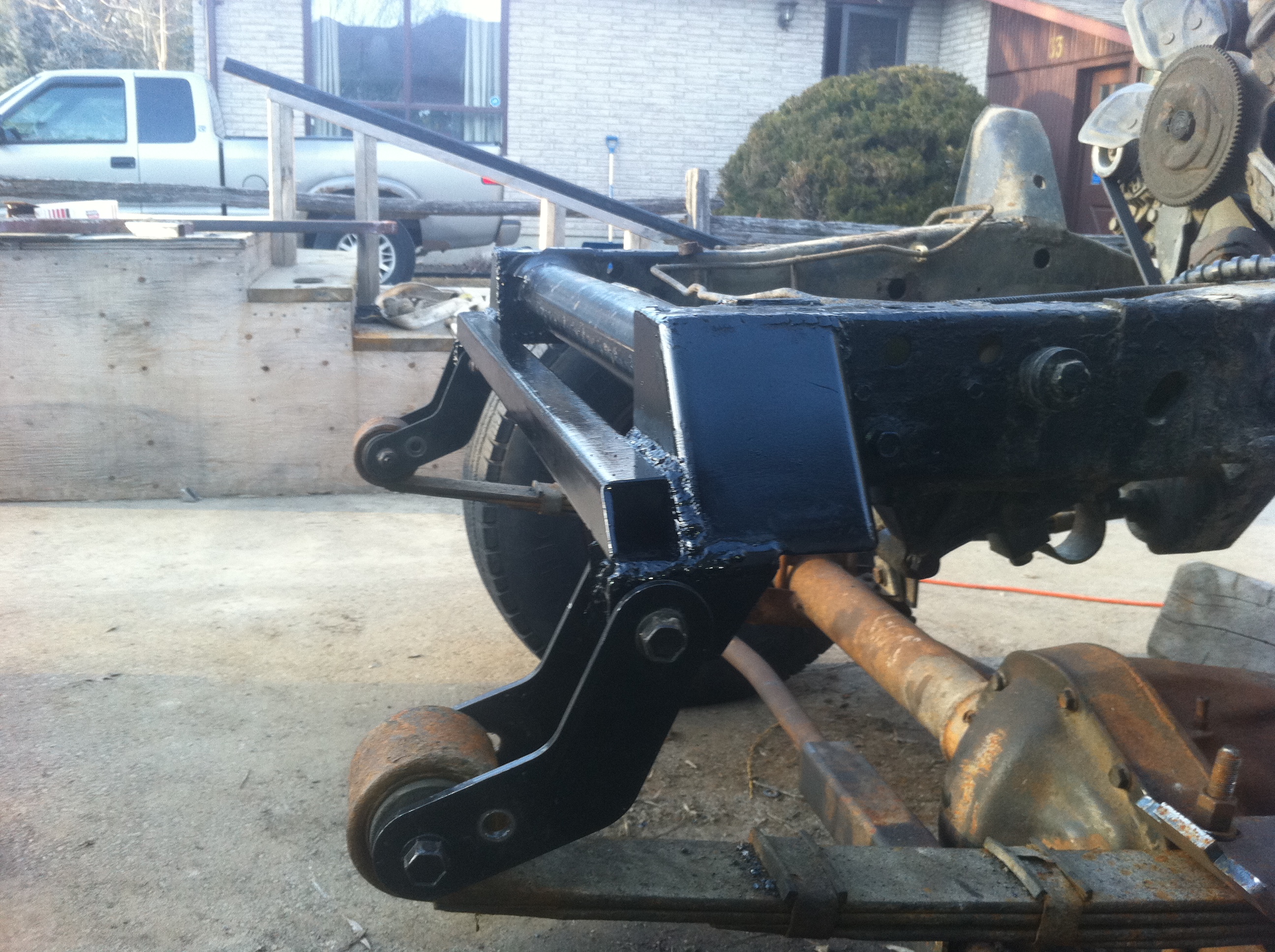

A lil progress,
