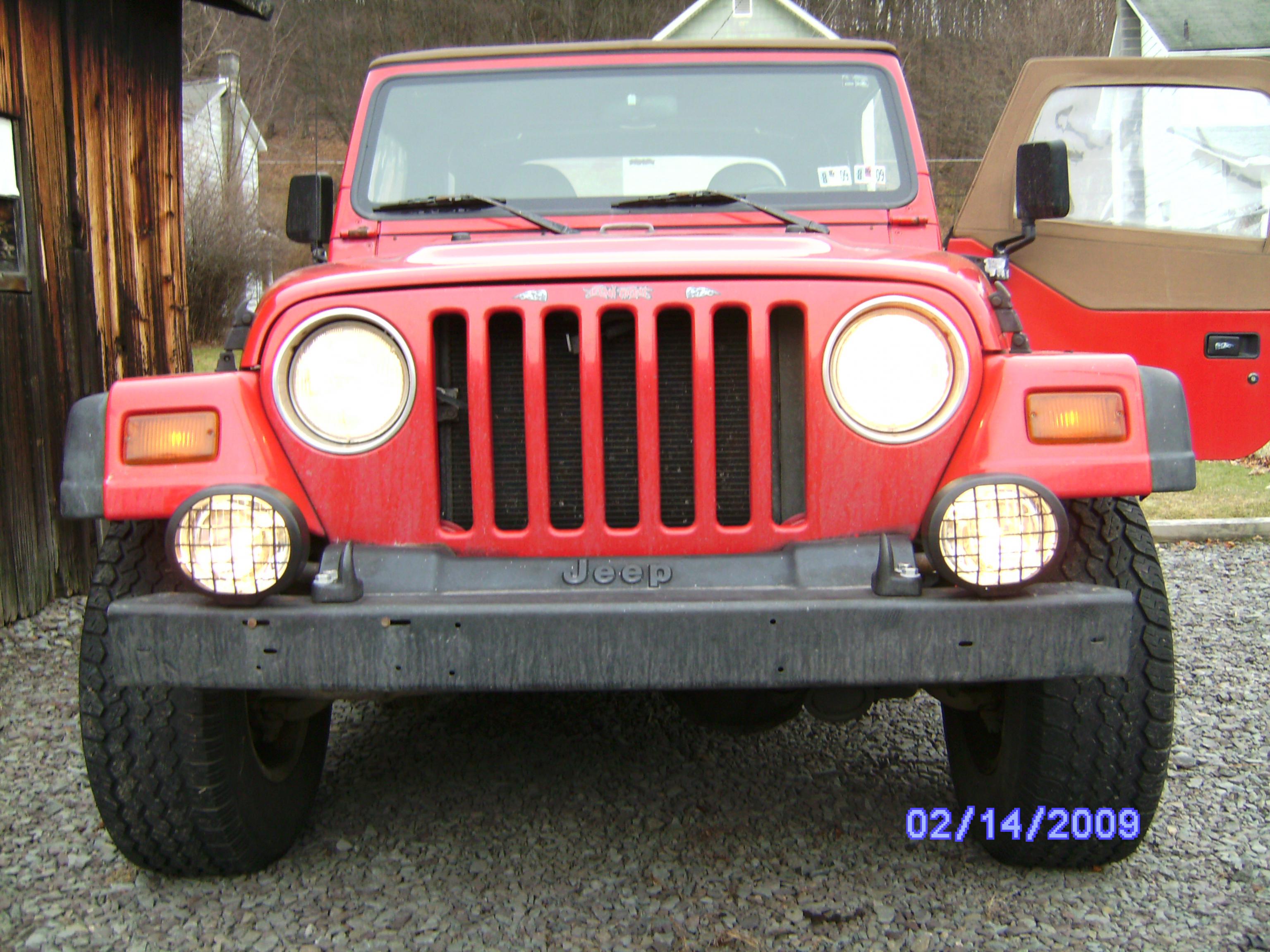

Done cost about $20 from harbor freight.
