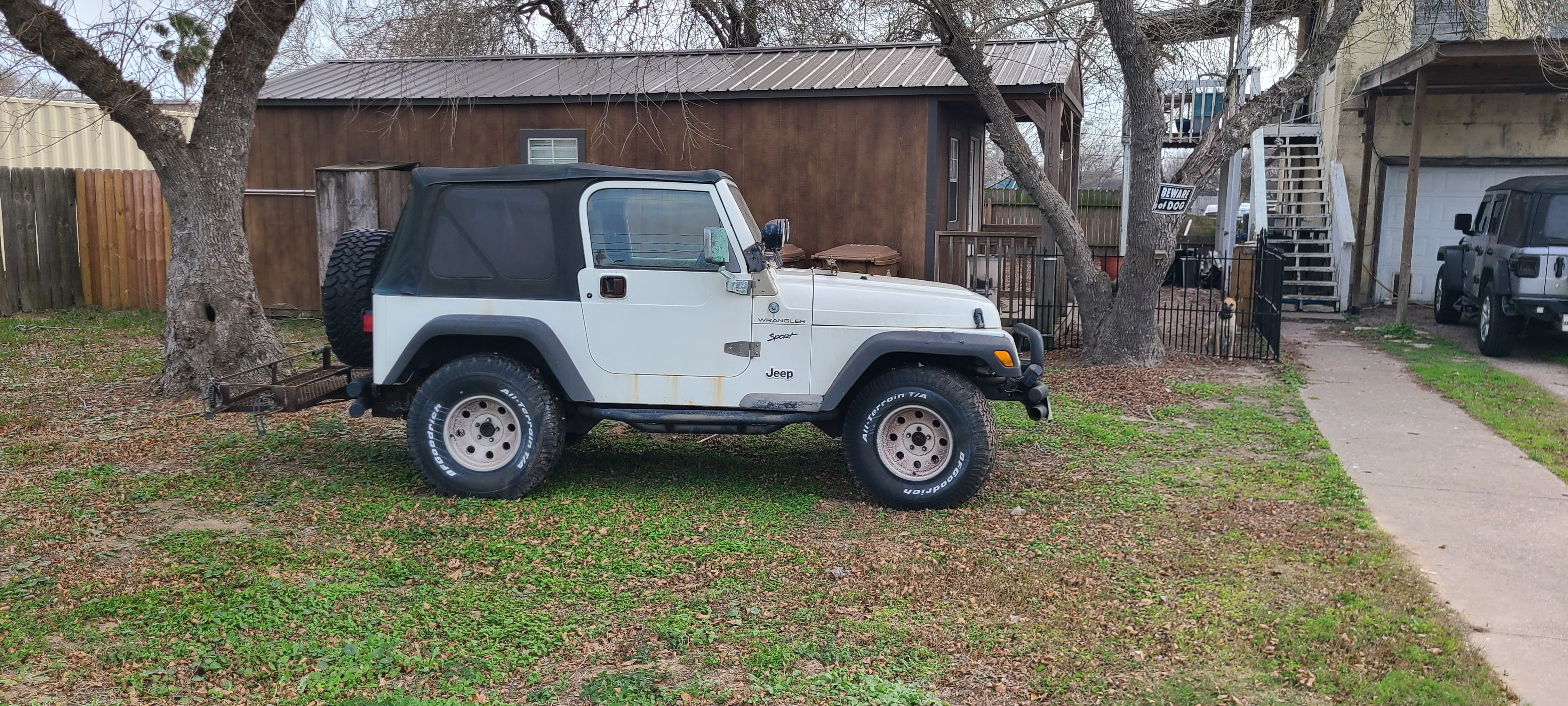

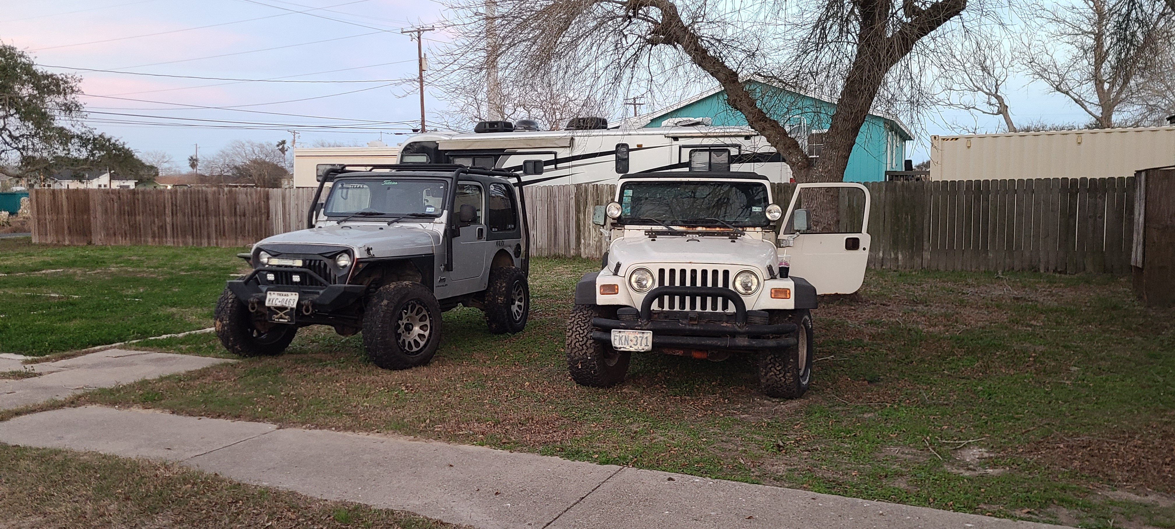

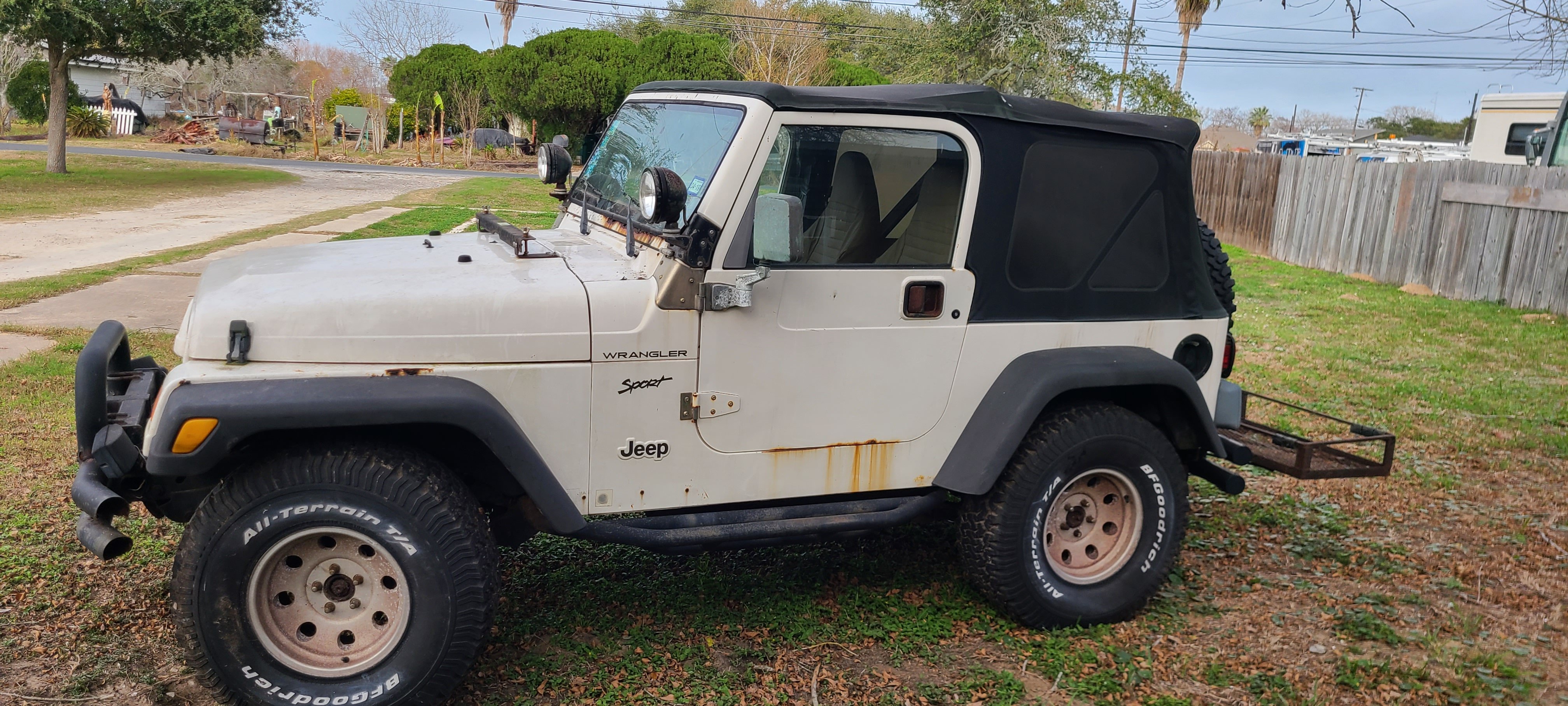

dang. i took a few more pictures yesterday to post since i only had one and i forgot to post them. now i am at work again and can't load from my phone
Finally put the pictures up

Rough. No holes but everything is rusty
Well, further cleaning and messing around ahows some small holes under the carpet by the foot areas. And the jeeo starts on fuel being sprayed in and tb and idles great but i think the fuel pump is frozen. And the underside is so rusty that i dont know if we woll be able to drop the tank.
